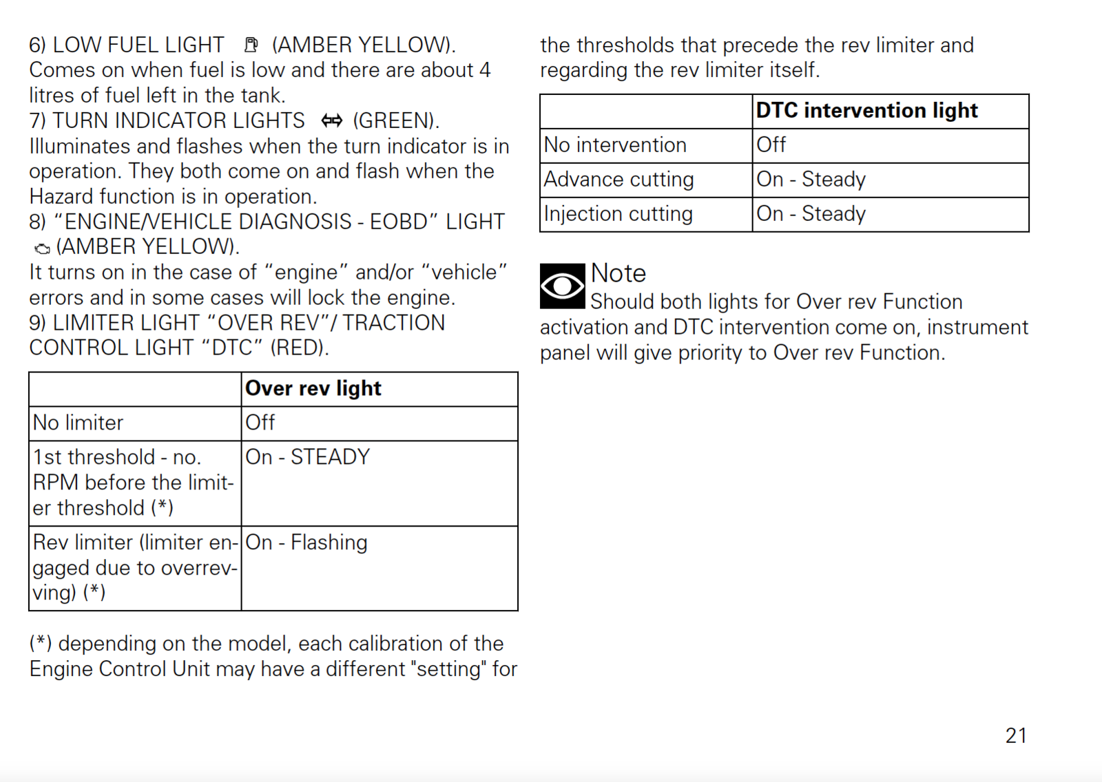

  3. .......Your manual. :bucktooth:

  5. Thank you for the picture. Propably the traction control because of the cold asphalt here in Norway. Makes sense :)
