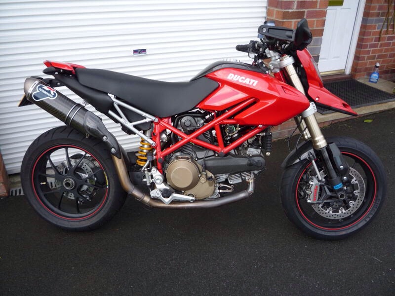

  4. [​IMG]
    Side view - not great. I think the gap where the twin pipes were would be too big with a side fitted. If you see what I mean...

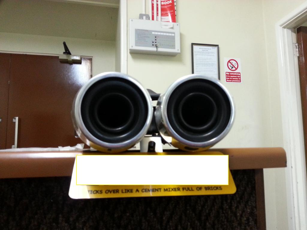

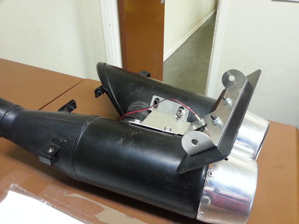

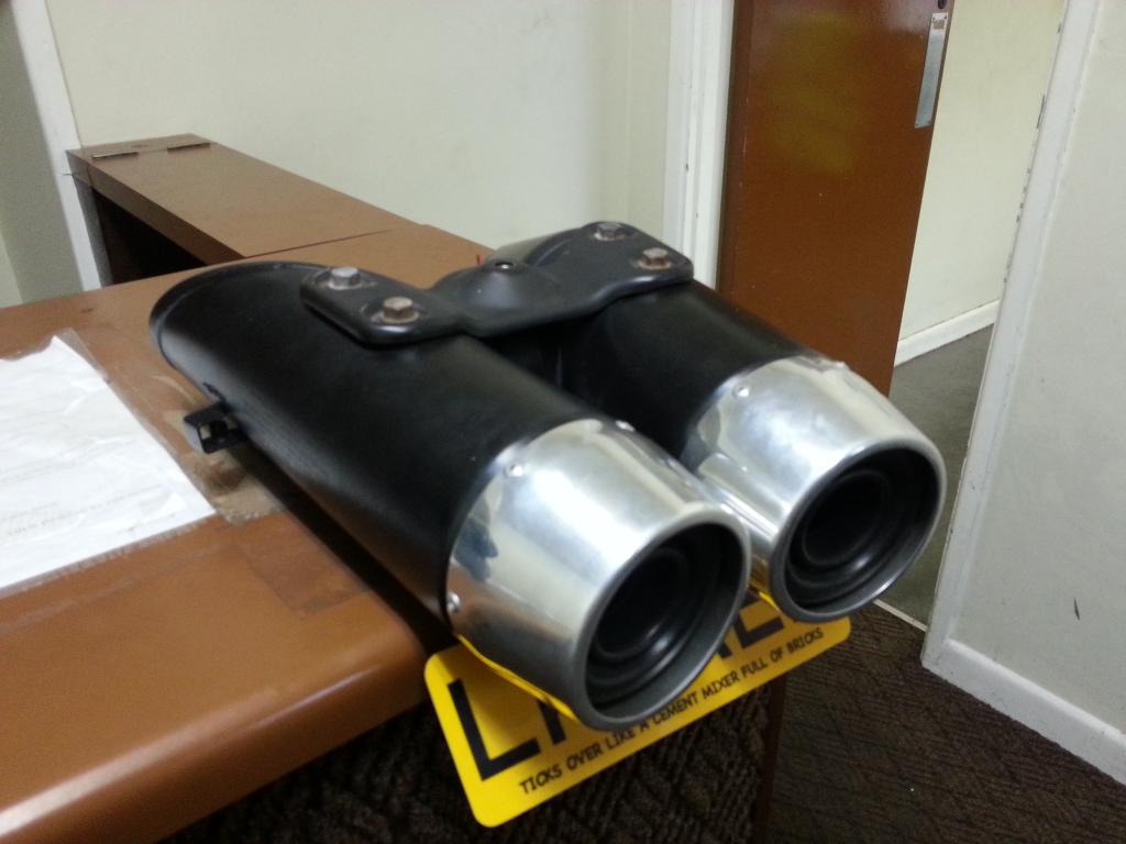

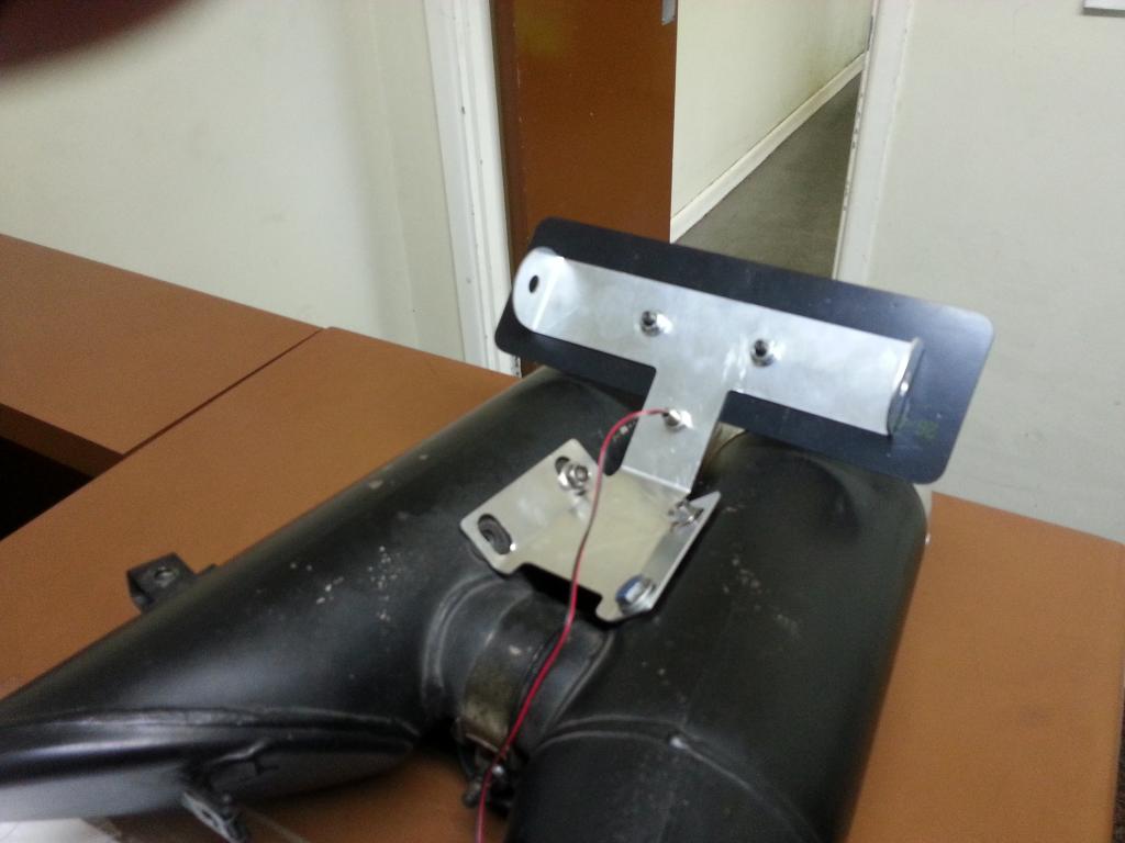

  8. Ok - this is about it. The holes are going to be widened slightly to allow for "Ducati's engineering excellence" as it were but that's it IMG_20131101_153815177.jpg IMG_20131101_153828630.jpg IMG_20131101_153852145.jpg IMG_20131101_153859357.jpg
    Ill be getting the first ones next week - by which time my republique one will be for sale...
    This is not set in stone - fabricator tells me if I want adjustments he can do that on the next ones produced.
    Comments please....

    PS - this is a slightly older thread - the finished unit is a lot better looking, also comes in 2 parts - so you can run it without indicators. and the mounting points including the LED light are on a slotted connection so you can adjust the angle. The reason for this is that (at least for me) it would seem the the holes are/were never exactly right so the old Republique tail tidy would never sit straight and wasn't even mountable until I drilled it. Mine is totally adjustable so you can get it level.
    #12 comfysofa, Dec 26, 2013
