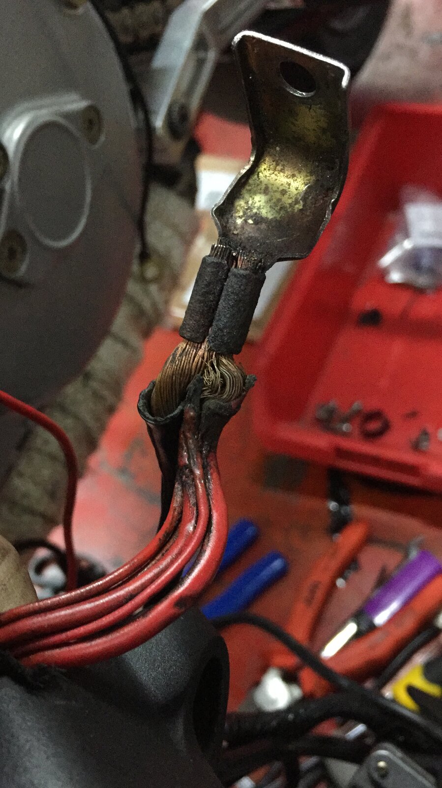

  1. Guys, what would cause my positive battery lead to smoke? This 999 is giving me a headache!!!!
  2. loose lead or poor crimp, short in the starter/ charging cuircuit.

    A hell of a lot of current going through it.... or high resistance.
  4. This is where it’s smoking!!
  5. You didnt reverse the polarity when connecting up the battery?
  6. No, red to pos black to negative. Is there polarity on the starter solenoid?
  7. What would cause high resistance?
  8. Corrosion between the lead and the conector,by the look of it.

  9. Old age and moisture from years of use and washing. Must be at least 13/14 years old now possibly more. Time for a checkover and refurb of the electrics by the look of things.

  12. Yeah the lead has broken down for sure, causing loads of resistance in the wire which is why it’s smoking, don’t mess around, just replace it, it’s carrying a lot of load
  13. The lives don’t look too clever either!

  17. Heat due to resistance,
    Resistance due to poor connection
    Poor connection due to corrosion.
