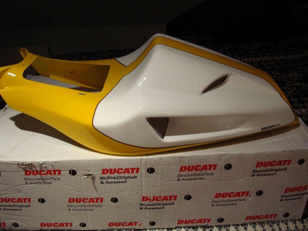

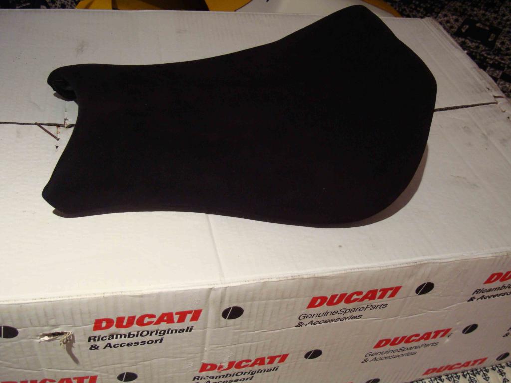

    i've just accepted delivery of NEW (believe it or not) tail unit and mono seat pad.
    do i need anything else or can i re-use all the fixings from my original tail unit? some people recon that you need to change light bracket and use different bolts and nuts??? others recon you can re-use everything from bip tail. before i dismantle my bike i want to make sure i have everything ready to put it back together as a mono.

  2. just swap all the bits over mate,they just unbolt 5 min job. make sure to put the locking pin the right way round or the seat wont lock.

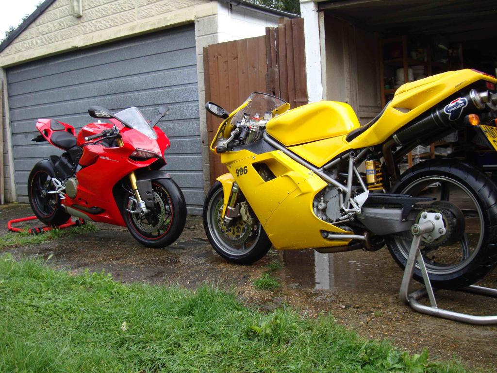

  8. I have a mono 998s Final edition and also did have the same bike in the biposto version at the same time ( stupid I know ) the seat fittings are the same 30 min job all in to change them all over.
  9. Nice pair of bikes you have there :upyeah:
  10. I had a Bip, and got a mono seat unit for it to swap with the Bip one. I'd generally ride it as a mono, but when I wanted to go away for a weekend with a tail pack, I'd just swap over to the Bip seat to put the pack on. Indeed - a couple of bolts undone and that was all there was to it. The best of both worlds.

  12. Mono seat needs a different latch bracket if fitting to a biposto subframe (or you can modify a bip bracket) but otherwise both seats will fit onto a biposto frame.
    Keep both seats and converting from biposto to mono takes only a few seconds (other than fitting/removing footpegs).
