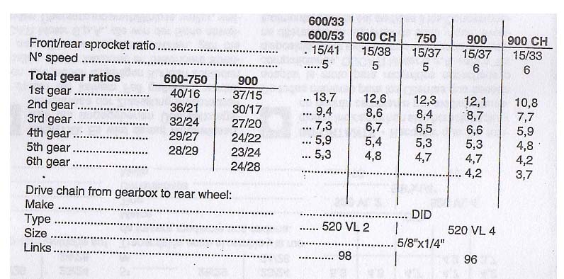

  3. Stock sprockets on the 750 are 15 / 37.......
    The 600 has 15 / 41, so I reckon the 400 is about the same, just in case you meant that.

    AL
    From the 1997 owners handbook.....

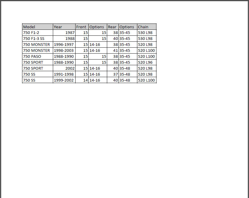

  4. 750 F1-2 1987 15 15 38 35-45 530L98
    750 F1-3 SS 1988 15 15 40 35-45 530L98
    750 MONSTER 1996-1997 15 14-16 38 35-45 520L98
    750 MONSTER 1998-2003 15 14-16 41 35-45 520L100
    750 PASO 1988-1990 15 15 38 35-45 520L100
    750 SPORT 1988-1990 15 15 38 35-45 520L96
    750 SPORT 2002 15 14-16 40 35-48 520L98
    750 SS 1991-1998 15 14-16 37 35-48 520L98
    750SS 1999-2002 14 14-16 40 35-48 520L100
  5. Sorry my post don't make much sense.
    Here it is a bit clearer.
