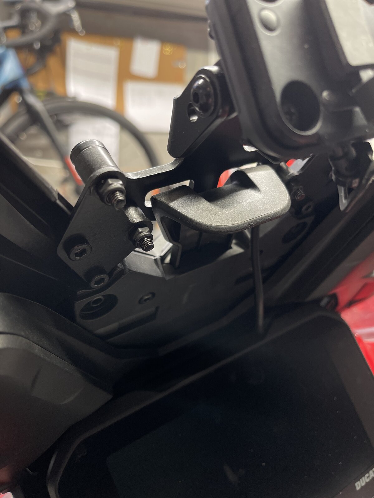

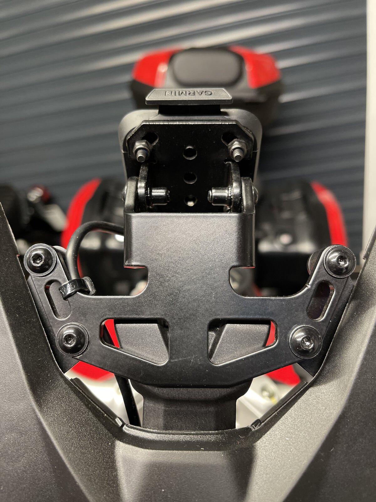

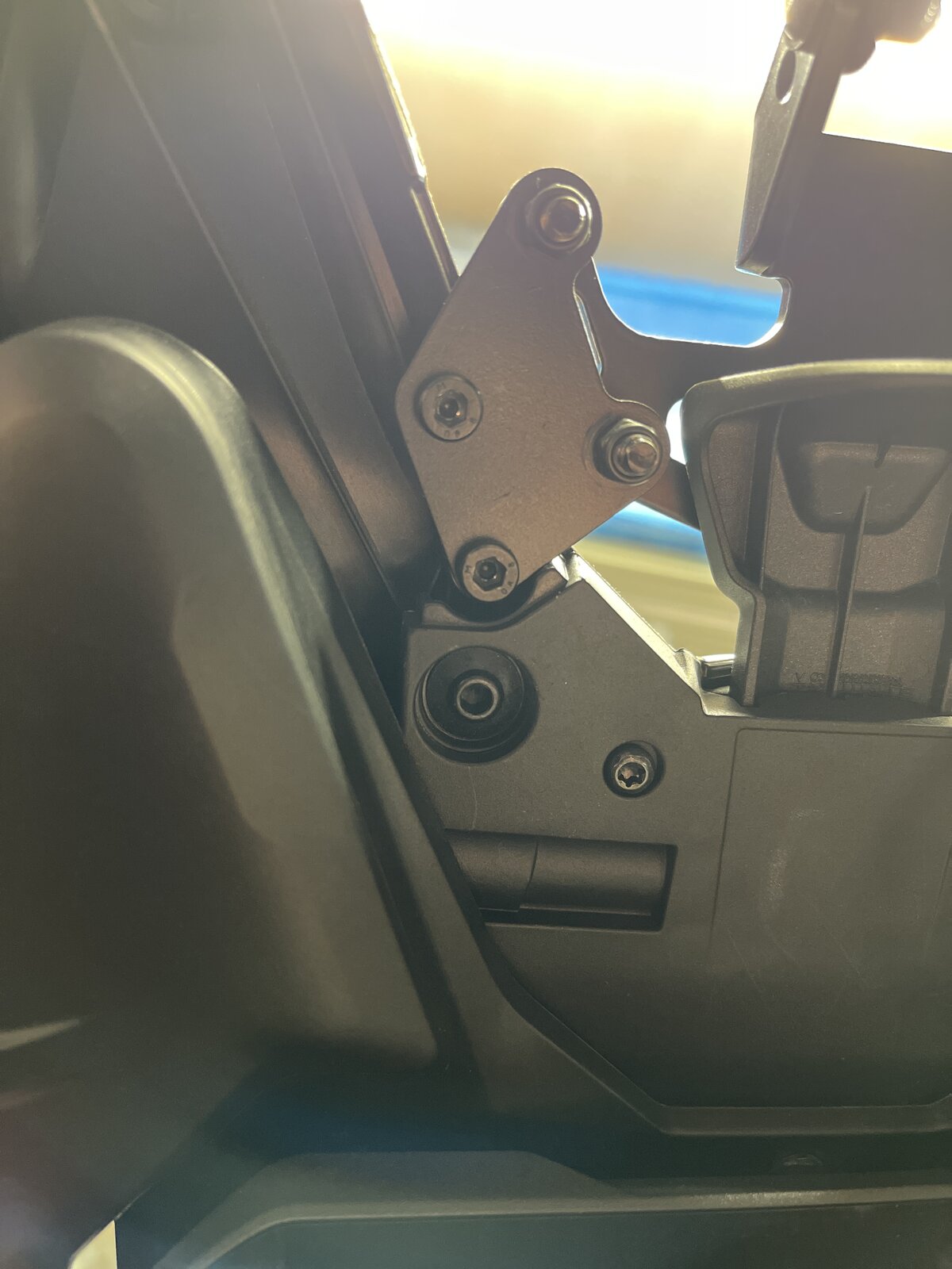

As a precaution I've recently purchased from Iconic, the so called 'Off Road' mounting plates to replace the original 3D printed brackets which, from reports, have been prone to splitting when you have a Sat Nav such as the weighty Garmin XT2 mounted. With the cost of the Sat Nav's I didn't want to risk having the unit drop off whilst riding. You receive 2 replacement untreated stainless Steel Laser cut plates, 4 x Black 3D printed spacer bushes and some replacement bright stainless M5 bolts and nyloc nuts. (And a Cadbury's Cream Egg as it was purchased over Easter!) As usual my OCD kicks in when the rest of the mount has been nicely powder coated Black but the new mounting plates , bolts and screws are silver. So out comes the rattle cans and all is now satin black plus all the nuts and bolts have been replaced with Black Stainless versions. Also replaced the 3D printed bushes with some turned aluminium ones more befitting to the assembly.
Very nice, I’ll have to get mine painted as well now. Whilst Easter is finished, you still get an cream egg
