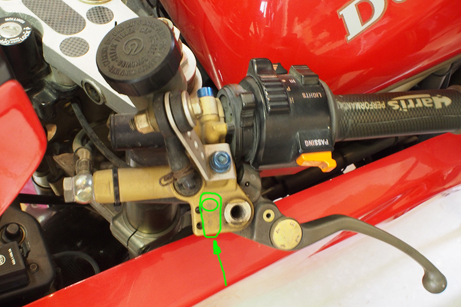

    I am needing some knowledgeable advice, my clutch master cylinder on my 97SS has given up the good fight. And brembo offers rebuild kits for only the type that has the 'coffin' reservoir not the one that I have with the remote round plastic reservoir...
    Does anyone have any ideas, moto rapido suggested calling around to see if aprilla or ktm used the same cylinder, but as the guy on the phone stated Brembo doesn't offer the kits...so I don't see why another manufacturer would have something.
    Could I strip it and try to find specific seals? I do want the least hassle (need bike on road asap), but want to retain the stock pieces...
    I appreciate any guidance!
    Thanks
    Grant

  5. Just for the archive.. the last 2 digits of the stamped number indicate the diameter of the cylinder. Marked in green. Mine happened to be a 13mm.
    Bevel Heaven sorted me out seriously quickly...good guys.
