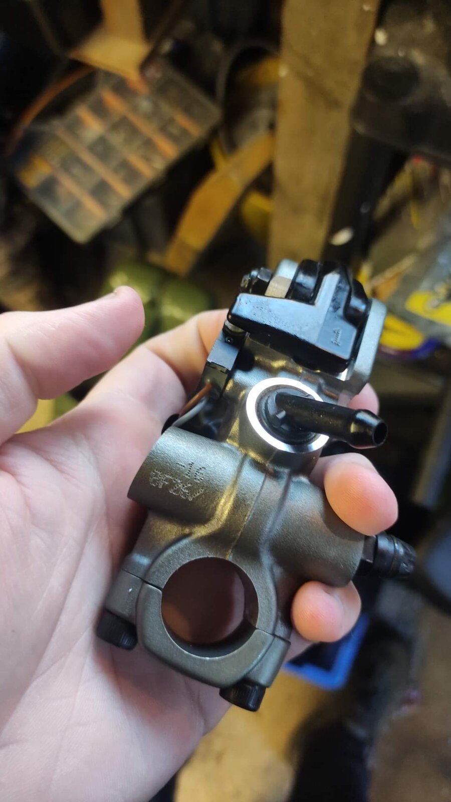

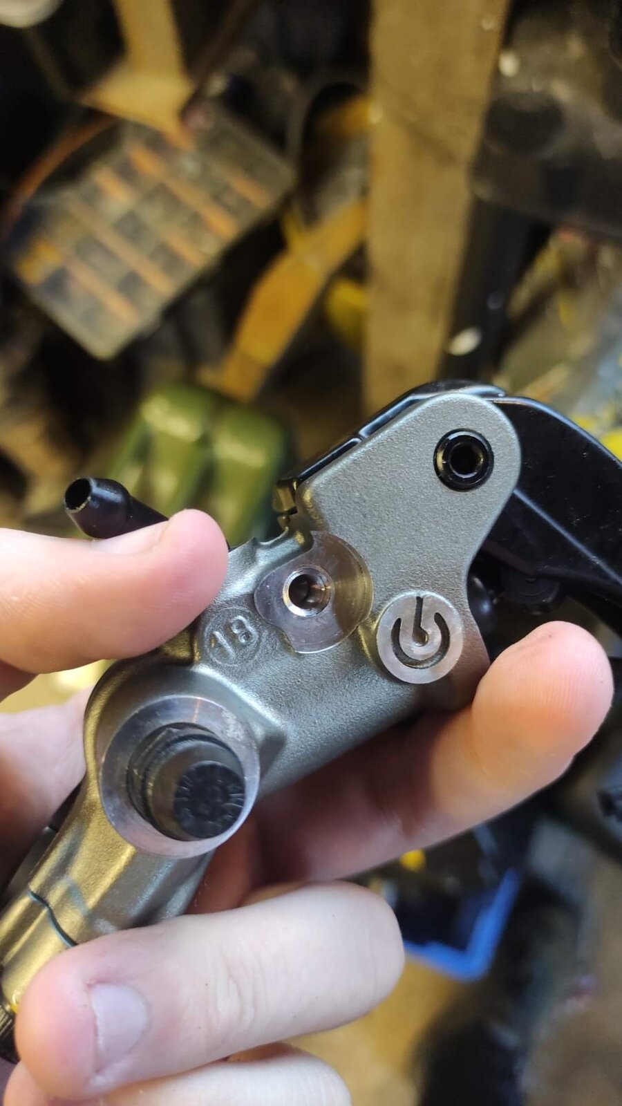

  1. Can anyone help identify this master clyinder please or help me to know the ratios?
    pics attached
    -16 8f26/
    trying to work out what the 18 means on the one side, and what the other code means. It’s from a Ducati of some sort, but unsure which one and thinking of using it for an Aprilia 125 with single caliper
  2. I don't have any personal knowledge of your master cylinder, but these people may be able to help:
    https://www.motorcycleraceparts.co.uk/brembo-radial-front-brake-master-cylinder-19x18 .
    The 18 could refer to an '18' ratio lever, as at the end of the extract below:
    "MASTER CYLINDER OPTIONS
    Listed below are size options and recommended applications:
    19x20 - 19mm Dia Bore with 20 Ratio Lever - Twin front Caliper Set-up, remote reservoir - Most popular for bikes without Brembo race calipers. Harder to pull with least travel giving a more responsive "sharper" Feel
    19x18 - 19mm Dia Bore with 18 Ratio Lever - Brembo twin Race Calipers, remote reservoir - Used by almost every works rider using Brembo brake calipers. Best combination of feel and travel.
    16x18 - 16mm Dia Bore with 18 Ratio Lever - Single disc and Supermoto Set-up, remote reservoir - The least popular although can be good for supermoto and 125 to increase feel. Easiest to pull with most feel.
    Please note: Brembo master cylinders require a M10 fine - 10 x 1.00mm thread banjo bolts (single or double)."
    Hope it helps, but apologies in advance if is not relevant.
