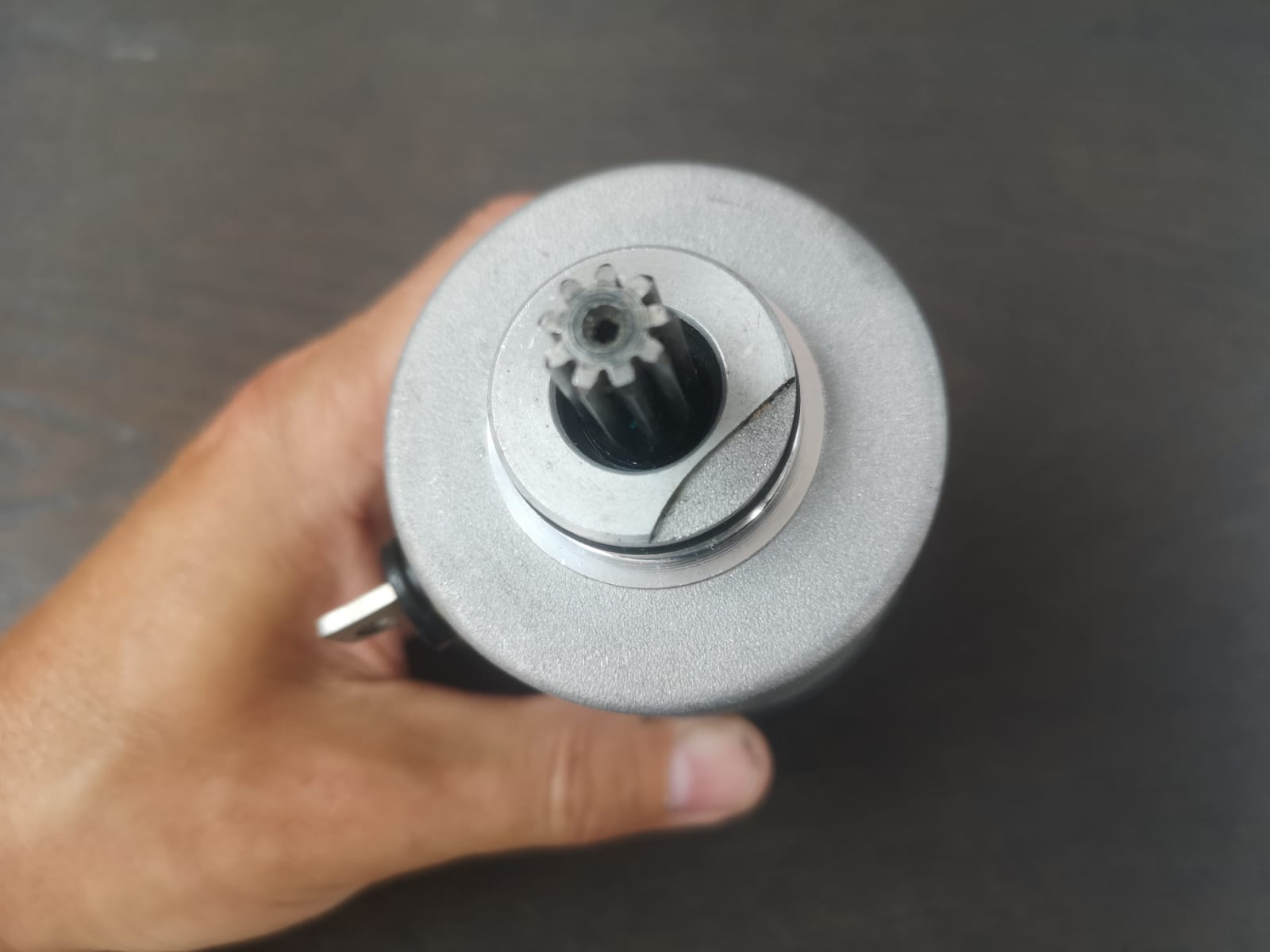

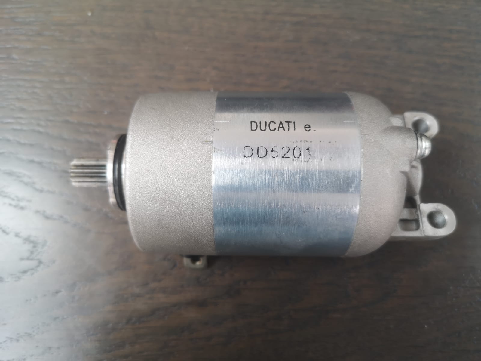

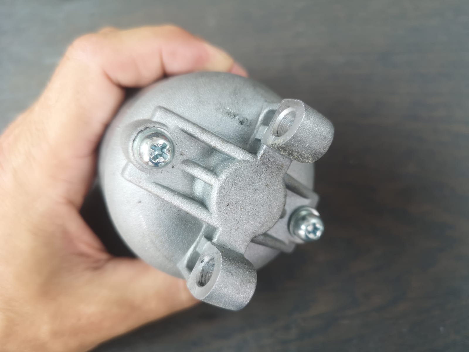

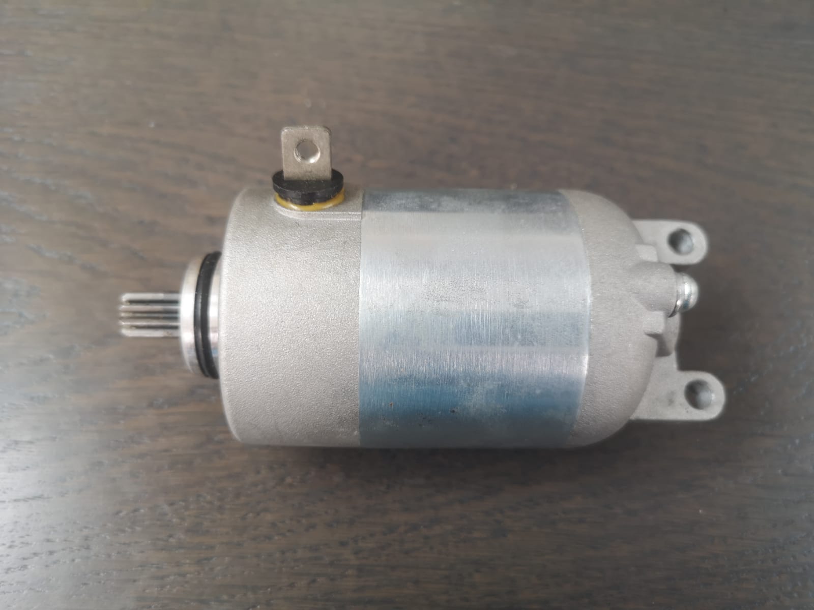

  1. Found this in a box of spares... only markings I can find are "Ducati e" and "DD5201" T'interweb turns up nothing exactly the same, though the Panigale starter looks similar...:thinkingface::thinkingface:
    Any ideas?
    Cheers
    Grant

  2. Looks like a starter motor
  3. It's like mastermind....
    "Here is your starter for one"
  4. ...So not a "Ducati" part then. Ducati Energia is a Ducati subsidiary... looks like it's a starter motor off the list below:

  5. Doesn’t the Panigale use this type?
  6. it does look similar, but the mounting flange is lower and the positive terminal is the other end...as far as I can find out. Found it in a box of parts!
