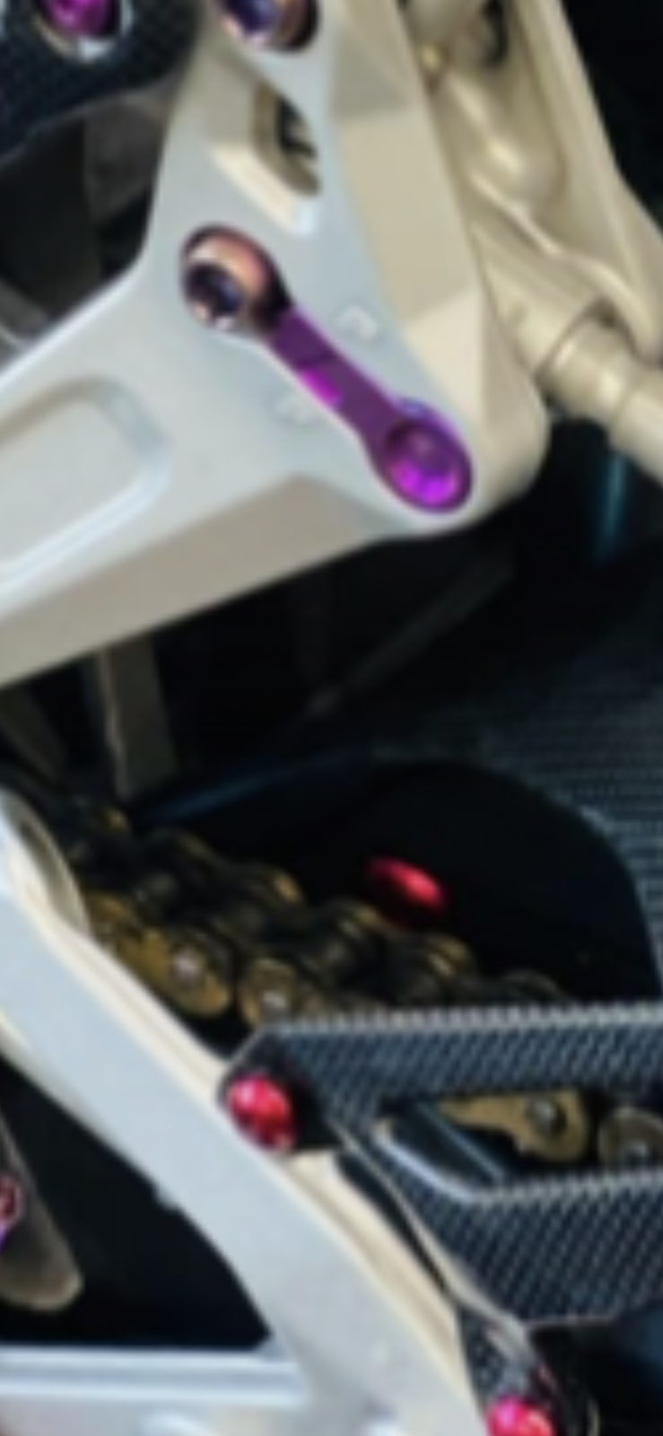

  1. Anyone know the part No or description of this little purple part and is it easy to swop back to stick colour
  2. 71319522AA for the standard grey piece
    71319522AB for the Magnesium coloured part from the Superleggera

  9. Can I just pull this out and replace it with the stock part or is it holding up something under tension?
  10. Pull it out; please. For the love of God, pull it out:joy::joy::joy::joy::joy::joy::joy::joy::joy::joy::joy::joy:
  11. The bolt that’s holding up the rear suspension passes through it so you need to take the weight off the suspension to pull that bolt out.

  15. If you are going to be taking that particular bolt out you should search the forum for posts on Flat rate vs Progressive linkage positions.
    It’s currently in the Progressive position which is supposed to be more suitable for road riding and occasional pillion use. Lot’s of solo riders like to change it over to Flat rate and definitely do if they are using the bike on track.
    If you are going to the effort of supporting the rear of the bike to change out the anodised part then you may as well decide if you want to change the setting while you are at it.
  16. Good to know will have a look it’s mostly road riding so may leave as is. If a second person just holds the rear end up will that be enough to get the bolt out and back in ok?
