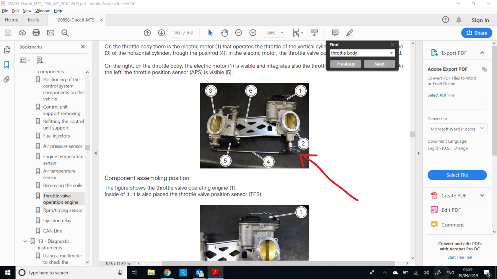

    Just finished installing my Tuneboy Cruise control but I seem to be left with a fairly high idle of at least 1500-1600 RPM.
    I've searched everywhere for a way to lower this but always seem to come up with nothing.
    SO
    I thought I'd have a little play and adjusted the srcew in the picture and sure enough it lowered my idle to 1300RPM.
    However everywhere I read about this screw says it is factory set and should not be adjusted, could anyone shed and definitive light on this for me please?

  2. As far as I have been adjusting so far regarding balancing and throttle arrangement is that the screw on mine was far out. adjusted it by eye when I removed the throttle bodies and re-set it , so far good, the idle speed was also too high so I compensated by using the air bleed screws to bring it down.
    I have ordered the tuneboy kit and waiting to it arrives hopefully to set it up properly with it as it shows both readings from the MAP sensors.
    You should be able to re-set the TPS also when adjustments are done.

  5. I've now put that screw back to where I found it.

  7. Bike now runs lovely
    I turned the front cylinder air bleed screw right in then balanced them by using the TB software and winding in the rear cylinder bleed screw, that brought the tickover down, then reset the throttle position sensors.
