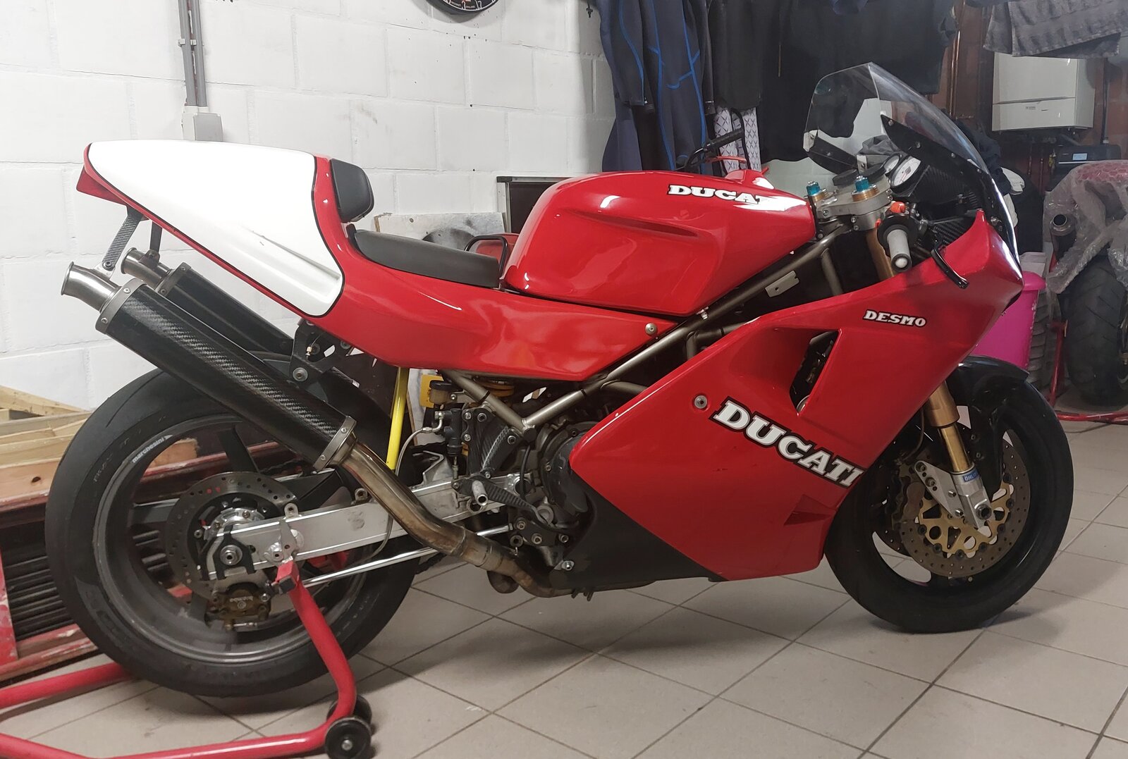

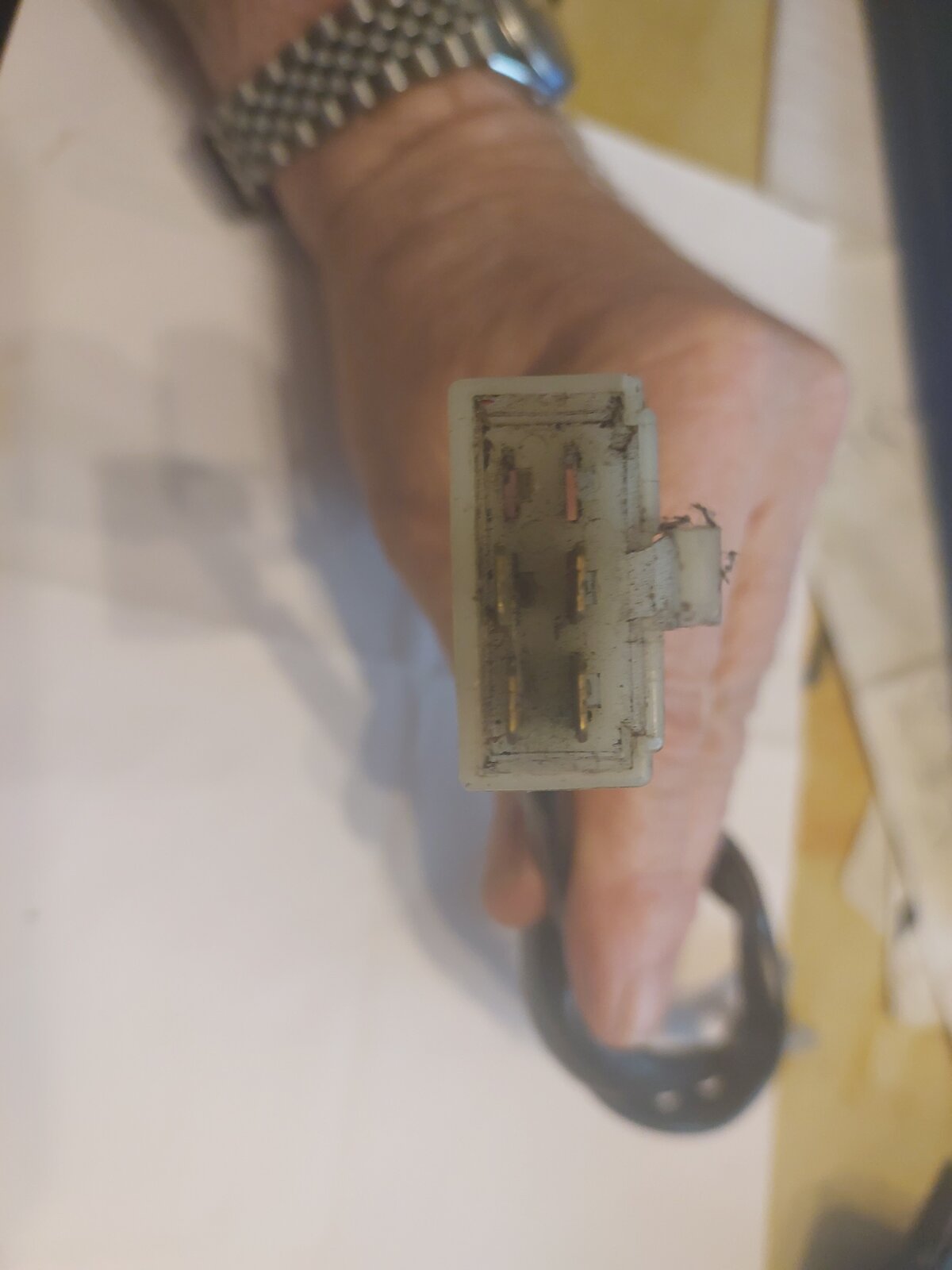

I want to take off the ignition switch with key and replace it wit a toggle switch. Took the ignition switch off years ago and can find it back to measure it. So does anybody know what wires i have to connect together on the toggle switch? This is what i have: -one white wire -one orange wire -one red and white wire -three yellow wires on one connection Henk!!!
I carried out this modification years ago on my 851. I'll have a dig around in my workshop and see if I can find it.
Hey Steve, Could you otherwise just tell me what colors you connected on the toggle switch please? Henk!!!

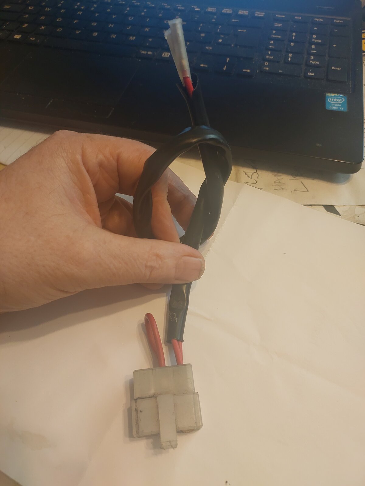

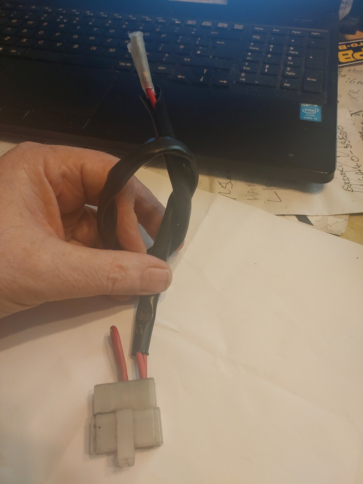

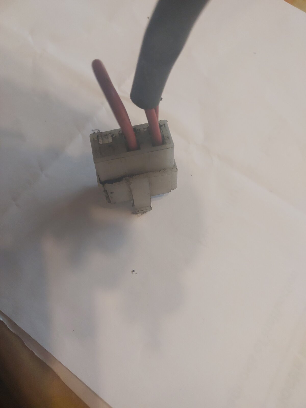

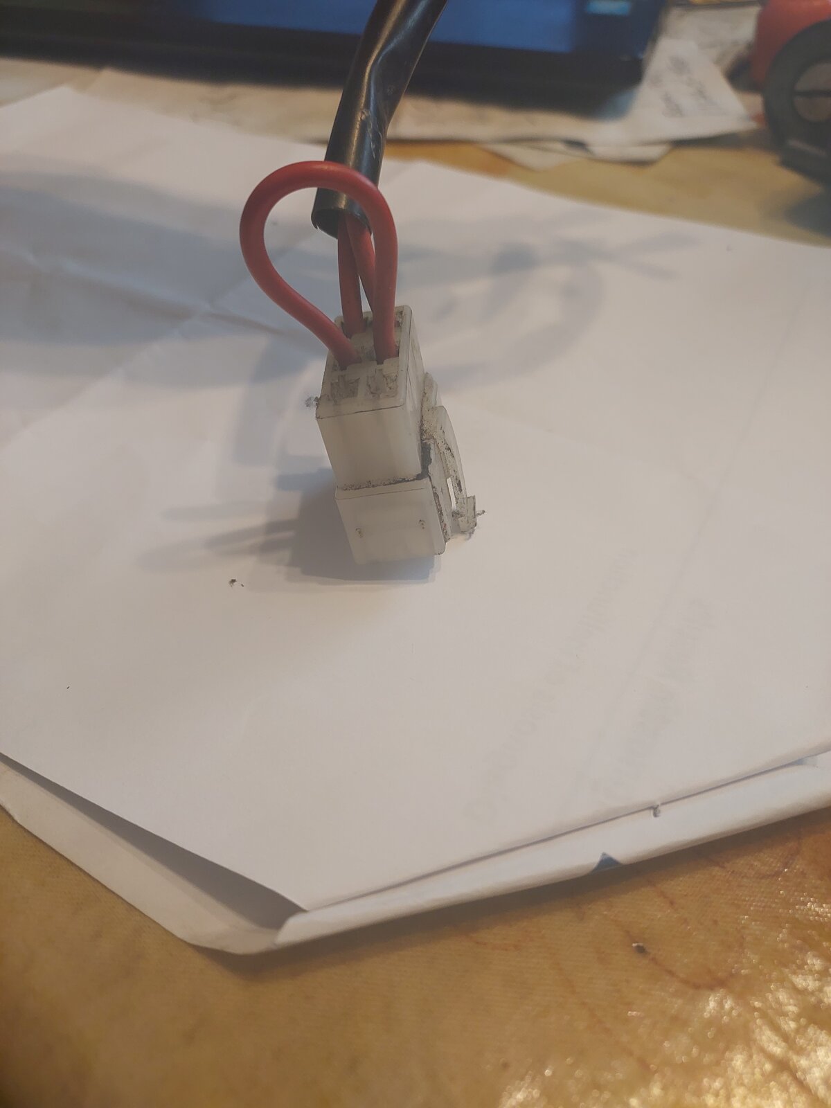

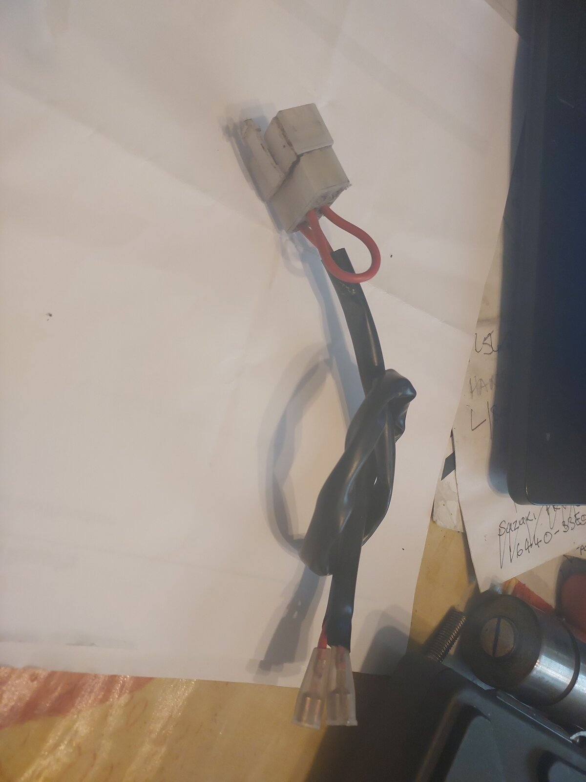

Here you go Henk, this set up works perfectly, it works the ignition and all the rest of the electrics via a two way toggle switch. I've used this with 851/888 and 996SPS looms.
