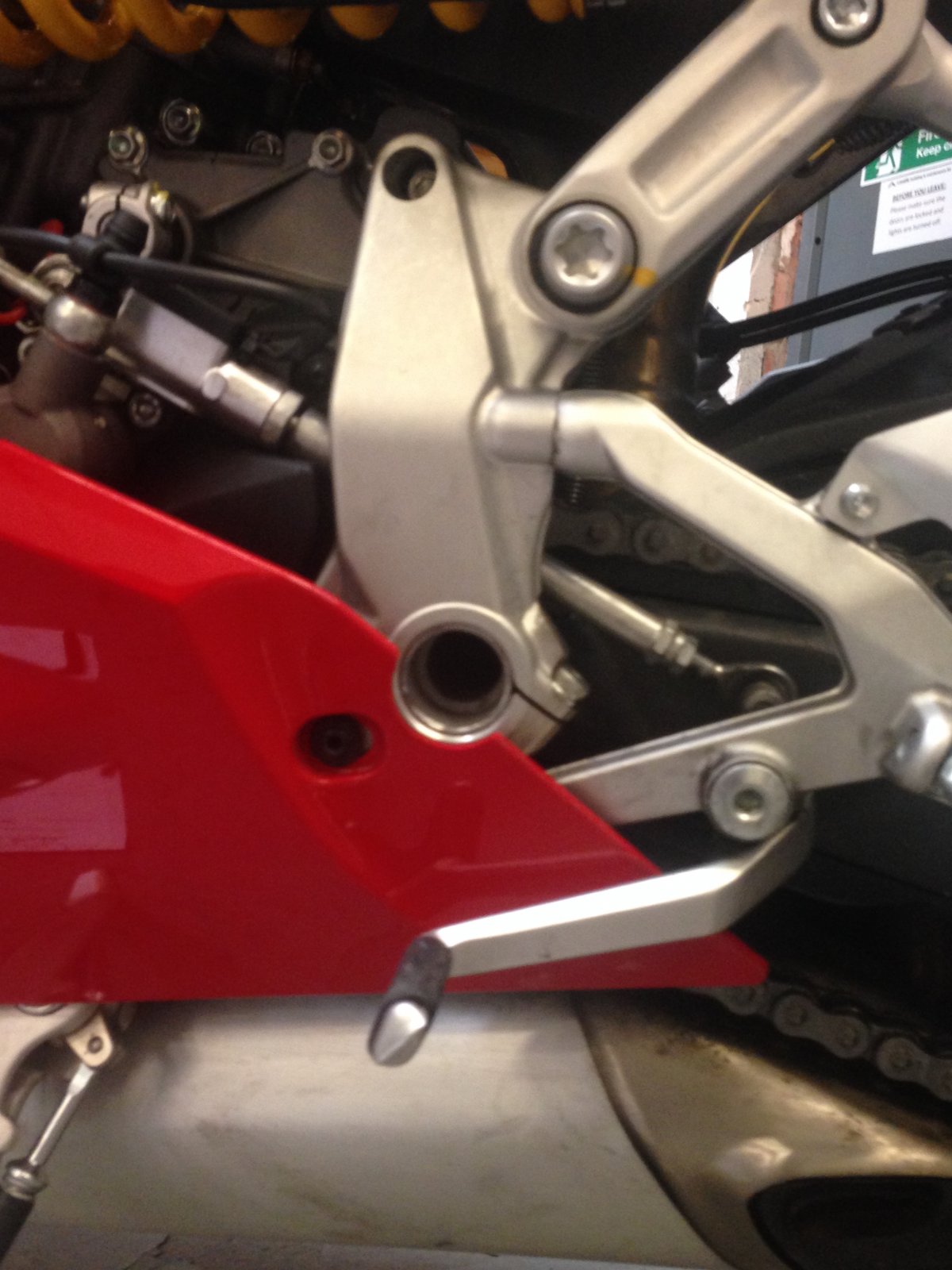

  7. Thanks Niven770. Any chance of a picture of your adaptor and its pins? Does the lower pin sit under the swinging arm? If so, surely it damages the rubber chain guide? Thanks
  8. Oh and the top pin is like a prick in a welly in the frame hole!
  9. My lower pin is different (unless you have an R). When I got my 1jac the lower pin didn't fit due to the R having an adjustable swing arm pivot. Between 1jac and myself we managed to develop one for the R which is quite a bit different from the non R version. The top pin is a very snug fit as is the lower one.
    The lower pin goes into the swing arm pivot hole. The lower pin is only to prevent the bike from swinging/rotating when lifted, all the weight of the bike is on the top pin.

  10. The top 2 pics are from Chris at 1jac, I think they are for 899 but basically the same and it shows the cut you need to make in the fairing. A 2 min job with a dremmel. The lower one is from my bike.
  11. Thanks Niven, very useful!
