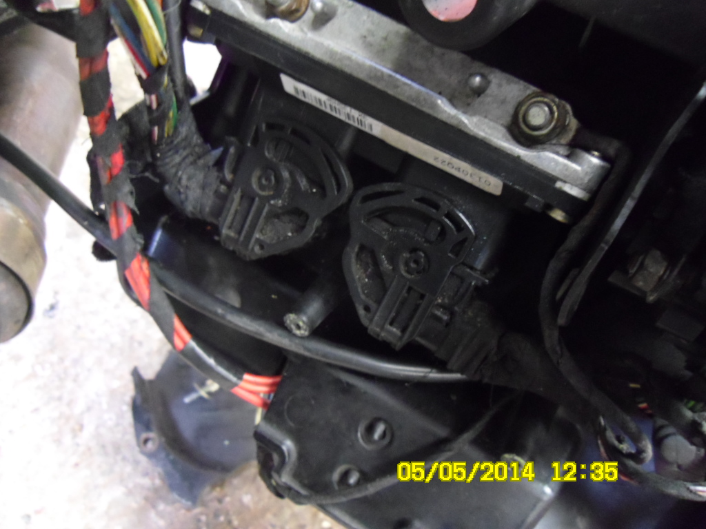

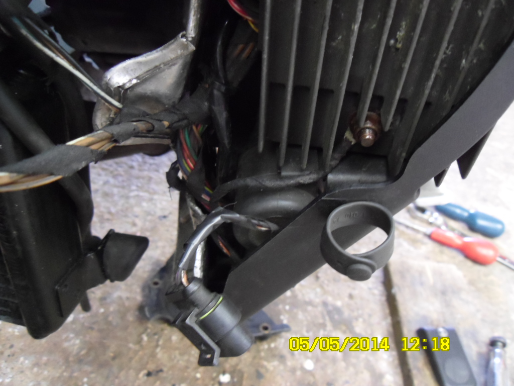

  6. Have you had the ECU out or unbolted? There is a little earth fly lead that goes under one of the bolts that secure the ECU to the battery box. It may even be broken loose.
  7. I have removed the battery box but did not remove the ECU connections
  8. Is this it - connected to the rectifier bolt?
  9. My first suspect would be the earth fly lead. Unfortunately, to get to it you need to take the battery box off and remove the silver heat shield on the rear. These sort of errors are associated with earthing issues.
  10. I have re-positioned the earth fly onto the ECU bolt and will see if this works. SAM_4600.JPG
  11. I have re-positioned the earth fly onto the ECU bolt and the EOBD light went out and the engine cranks.
    Thanks so much, I'm well impressed.
