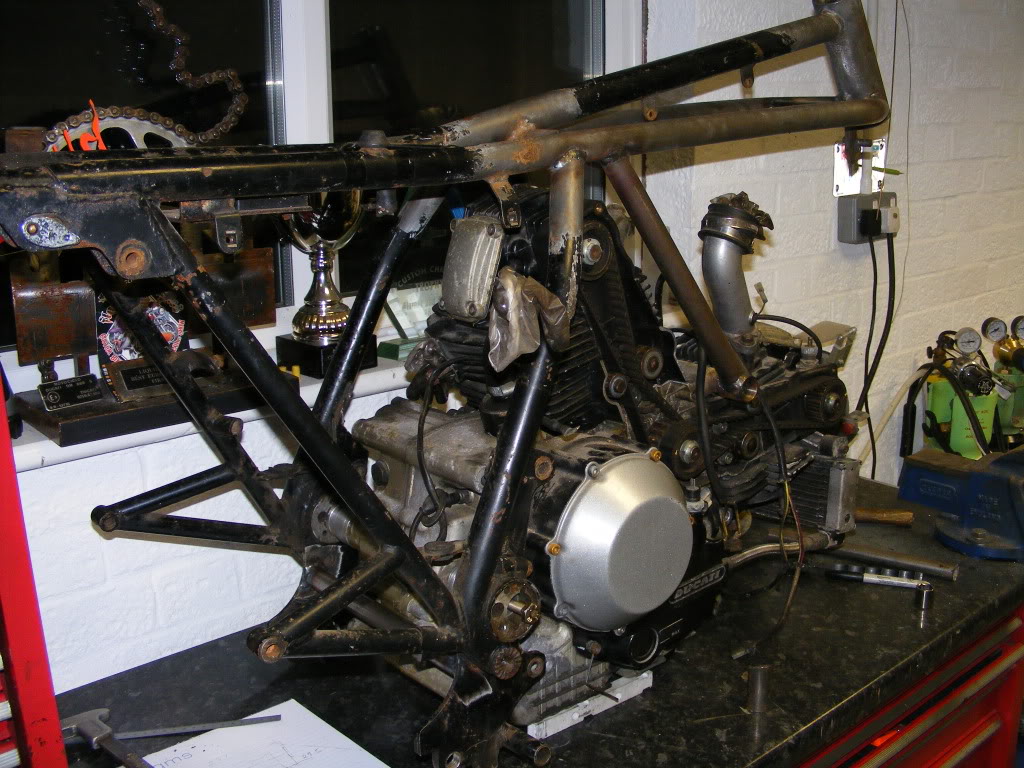

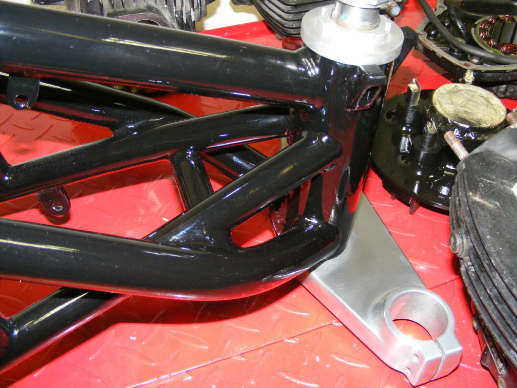

  1. The project started with a bare 900GTS frame and tired '91 900SS engine, each purchased for 250 quid
    Some may find the following butchery offensive:

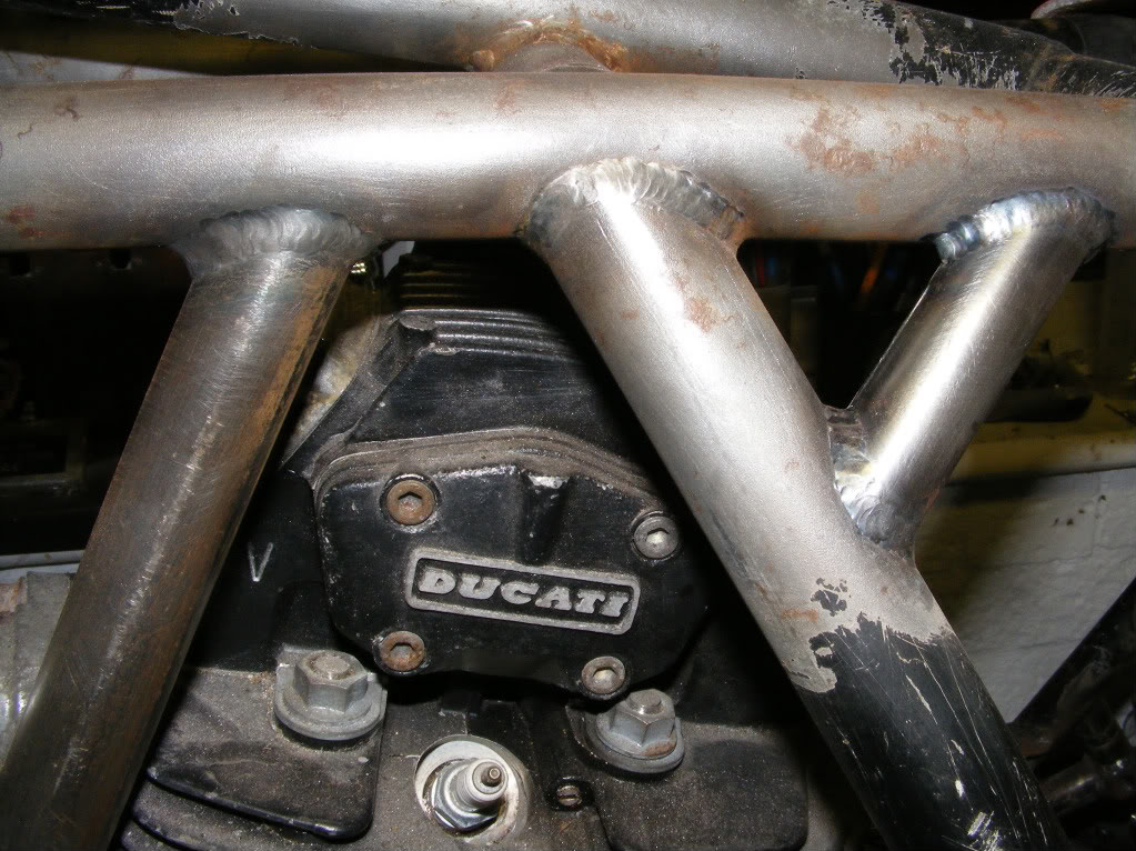

    Fabricated the Y by cutting and splicing tube

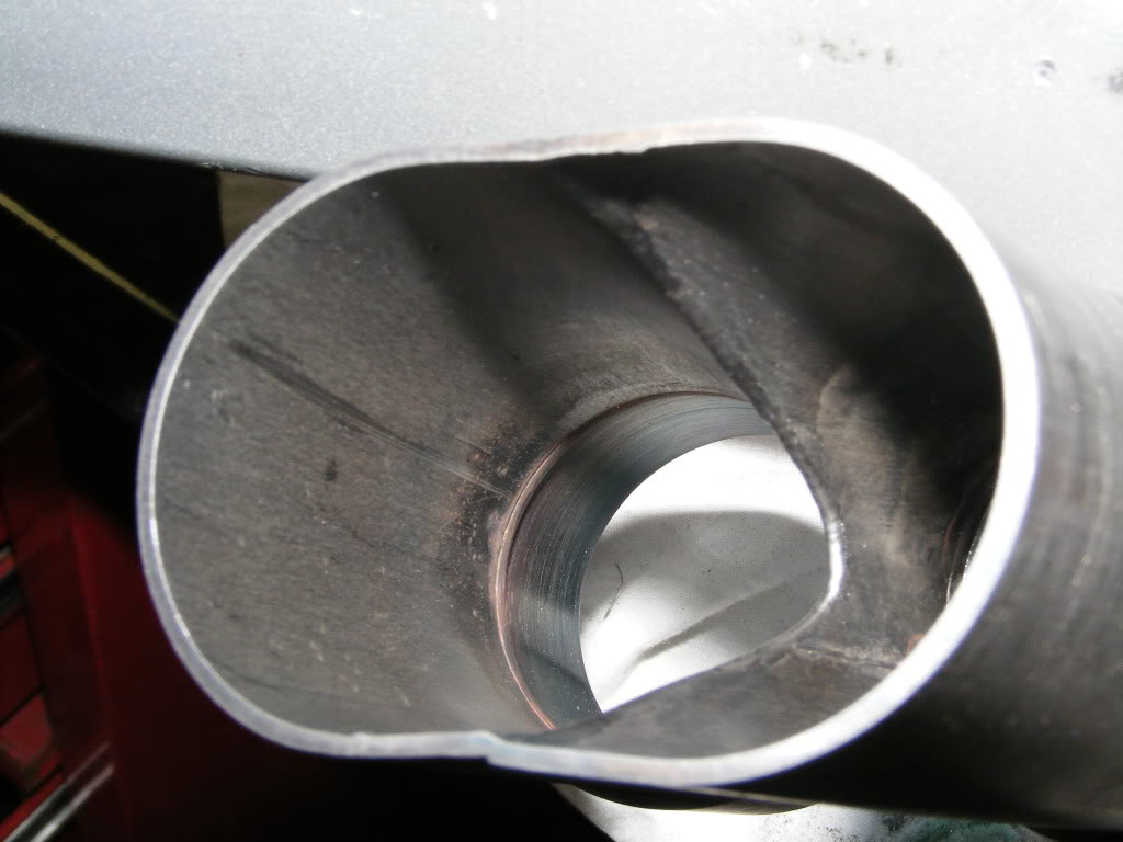

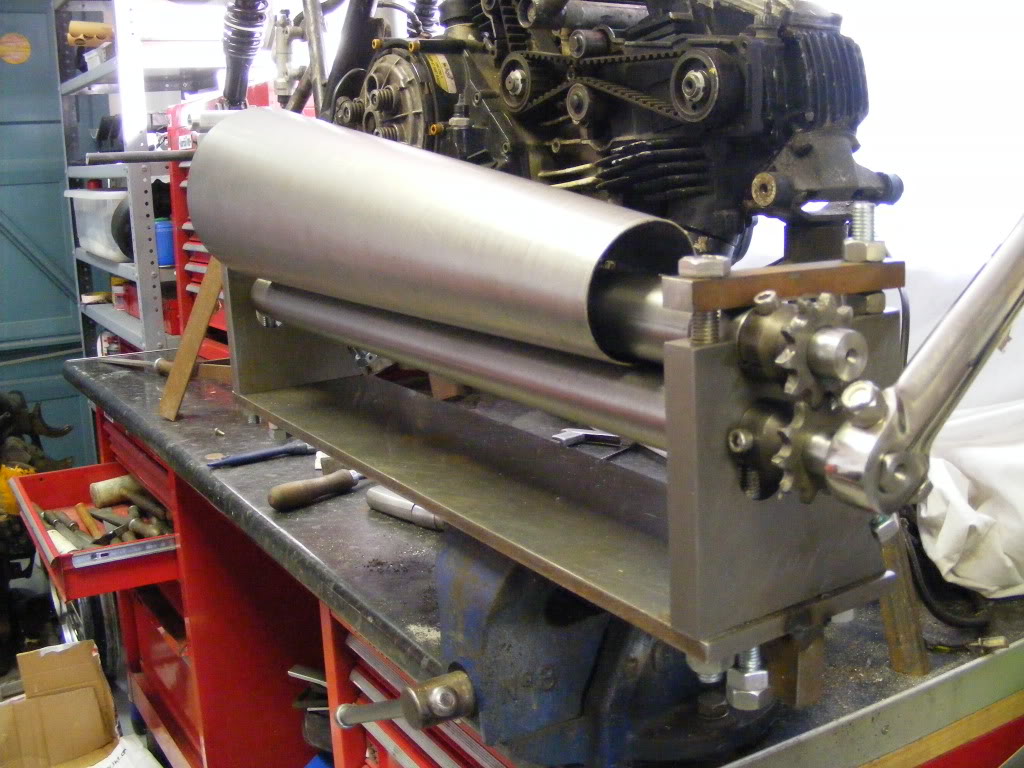

    Made a roller to fabricate the megaphone....notice the Harley kicker for a handle and moped front sprokets

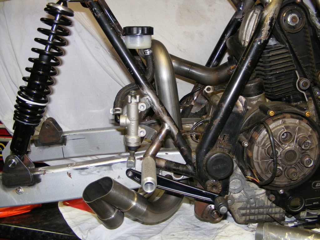

  7. Nice work! Just my two ha'porth... I have a similar home brewed rear caliper hanger, based around the Superlight type, to give a floating action, and as soon as there was any wear in the bush which the spindle passes through, the caliper mounting bolts wore a groove in the disc. I sorted it in a MkII version, which had a grease nipple, and a tighter interference fit.
    Just got my lathe up and running last week. Don't think that Im competent enough yet with it to attempt anything too complex though!
