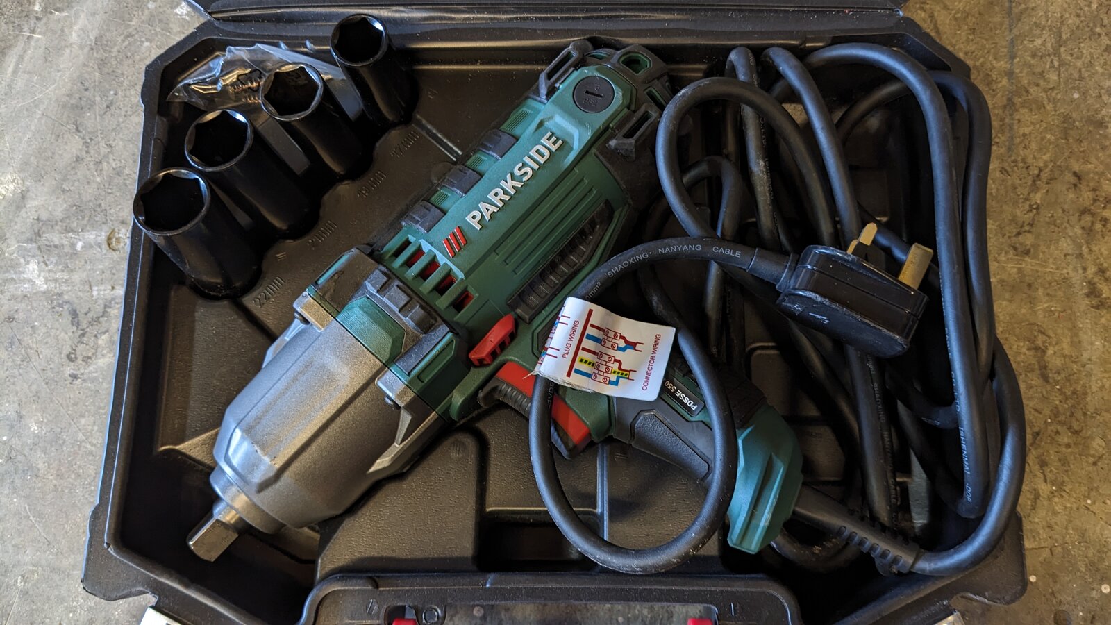

  4. Lidl ..... now in stock again.get the mains corded one ...(not battery one) ...I got one a few years back .... rear hub and wheel nuts straight off ....no messing. Also engine sprocket same .....
    Can't remember if they're £49 or £39 ...
    If it don't work...then just take it back for refund. I only use for undoing not tightening...... they are limited to 100nm tightening anyway.
    500nm undoing torque ...
    3 years warranty iirc ....
    If you search on here ....rear wheel nut or similar ...you'll get a good few recommendations..... including the Clarke corded gun from machine mart and other places. Similar to this Lidl one.
  6. I’d not want to torque up using an impact driver. Far more control with a torque wrench, even on Ducati Rear wheel nuts. Mains-powered Clarke for undoing those reluctant ones.

  8. Snap! bought one of these years ago and I only use it for the engine sprocket nut on the Raptor. It takes longer to take it out the box & plug it in than it does to whip the nut off. Worth every penny.
    Don't try it with with hex bolts unless you have a really tight fitting hex key cus it might round the inside... don't ask how I know that :(
