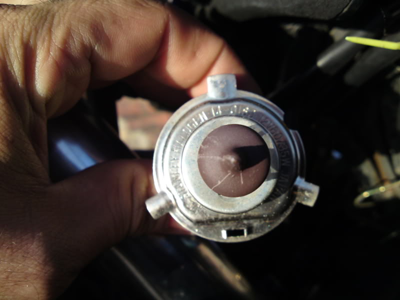

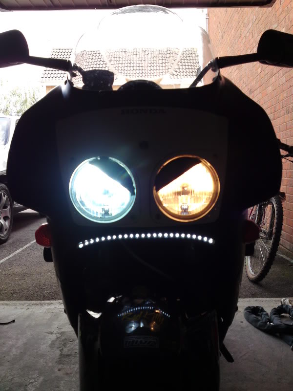

  4. This is the HID kit in my old CBR4 Triarm? Superb bikes! As standard they come with a Jap-only I4 bulb??
    Both bulbs were 35W60 and terrifying at night, my 400/4 had a better headlight! The tags are a strange fitting? You can however fit H4 bulbs by folding in/cutting off the lower tabs. :biggrin:
    Unfortunatly the increased 55w low-beam frazzles the switchgear, meaning it can take forever -
    to change from low beam to hi-beam, with darkness in the middle! :eek::eek:
    The HID kit only pulls 35W & uses a sliding shield to provide hi and low beam? In the end I just ran the HID side, such was its awesome brightness! :upyeah:

  5. Your bike looks pretty pissed off :mad:
    lol
  6. It made for good filtering! The blue light stands out a mile over standard yellow headlights? :upyeah:
