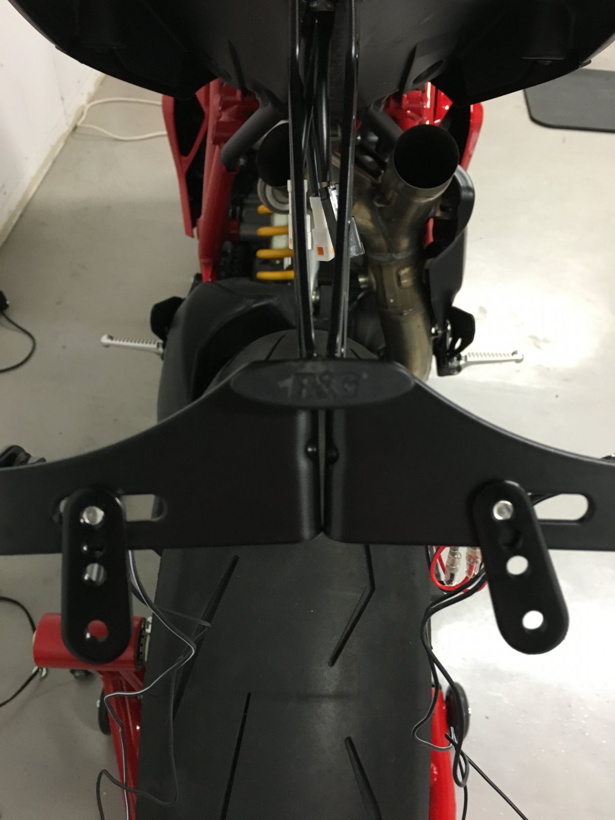

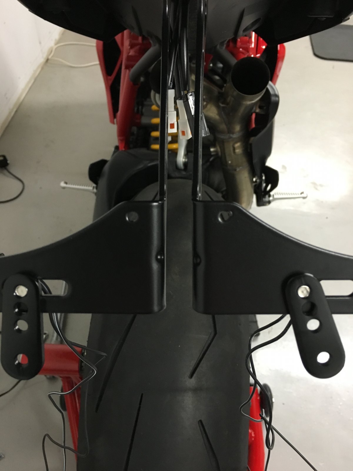

  9. Hello again guys.
    I received the R&G tail tidy today but have come across a problem.
    The hole for the LED number plate light seem too far apart on the bracket.
    Here is the bracket without the number plate light attached:
    To fit the light I have to pinch in the 2 legs for the holes to align.
    Surely this isn't right. It looks ridiculous plus it will probably break the threaded pins on the light over time with the pressure on them.
    Could they have just packed the wrong light?:
