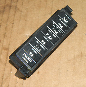

  7. If there's no power at the flasher unit, it's not the switch. Assuming you haven't got some spangly modern bike with canbus. Circuit for indicators is battery-fusebox-flasher unit-switch-bulbs-earth, flasher unit also has a third pin which goes to earth.
  8. Jammy I thought fuse was a 7.5A one (#4 unless my diagram is for the wrong MY), it does indicators, parking lights and idiot lights
  9. Mystery solved, it was the fuse! The confusion was caused by the fuse box cover showing the indicator fuse as the 3rd one down (though it is listed as a 7.5A fuse).
    (Not my actual one)
    So now I've replaced that fuse with one of the spares I've got my indicators back (well, three of them). Just need to either go and find replacement incandescent front indicators, or an LED flasher unit and LED rear indicators...
