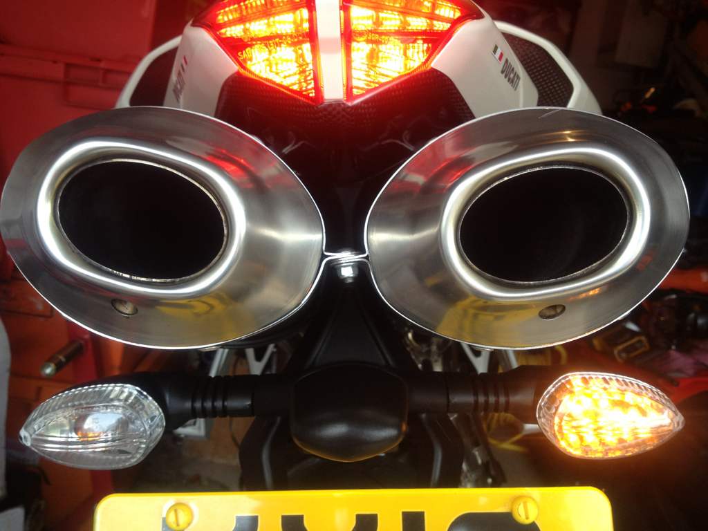

I like those as it follows the contours of the cans...wot would be nice is if you could make a pair that sit in the air vents next to the brake lights.
Hyabusa Let me google that for you :wink: Only thing is you don't have the legal indicator spacing, this shouldn't fail an MOT but if the tester is a pernicky b******d it might John
