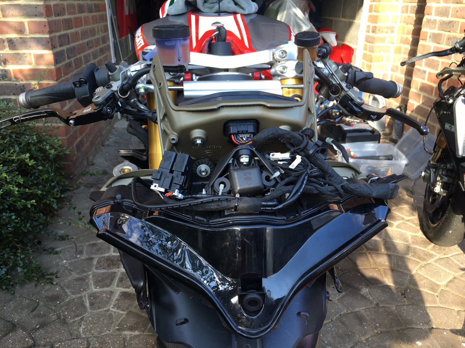

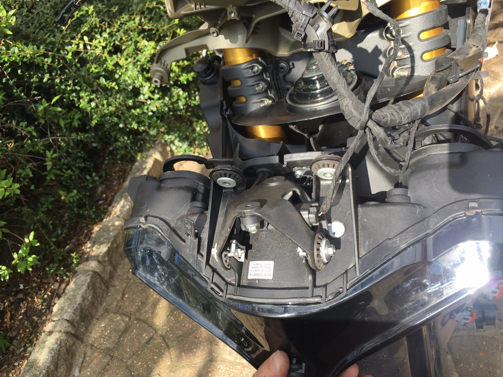

    I thought this was an interesting discussion over on the ducati1299 forum as I've been fitting fairings and doing some DIY mounting of the IMU which lives on top of the light unit over the weekend.
    The unit has it's own mount that bolts onto the top of the light unit and it looks like it's at close to 45 degrees, about the same angle as the dash display.
    I'm speculating that the unit is more interested in sudden change of level rather than actual level as otherwise it would be getting confused on steep gradients?

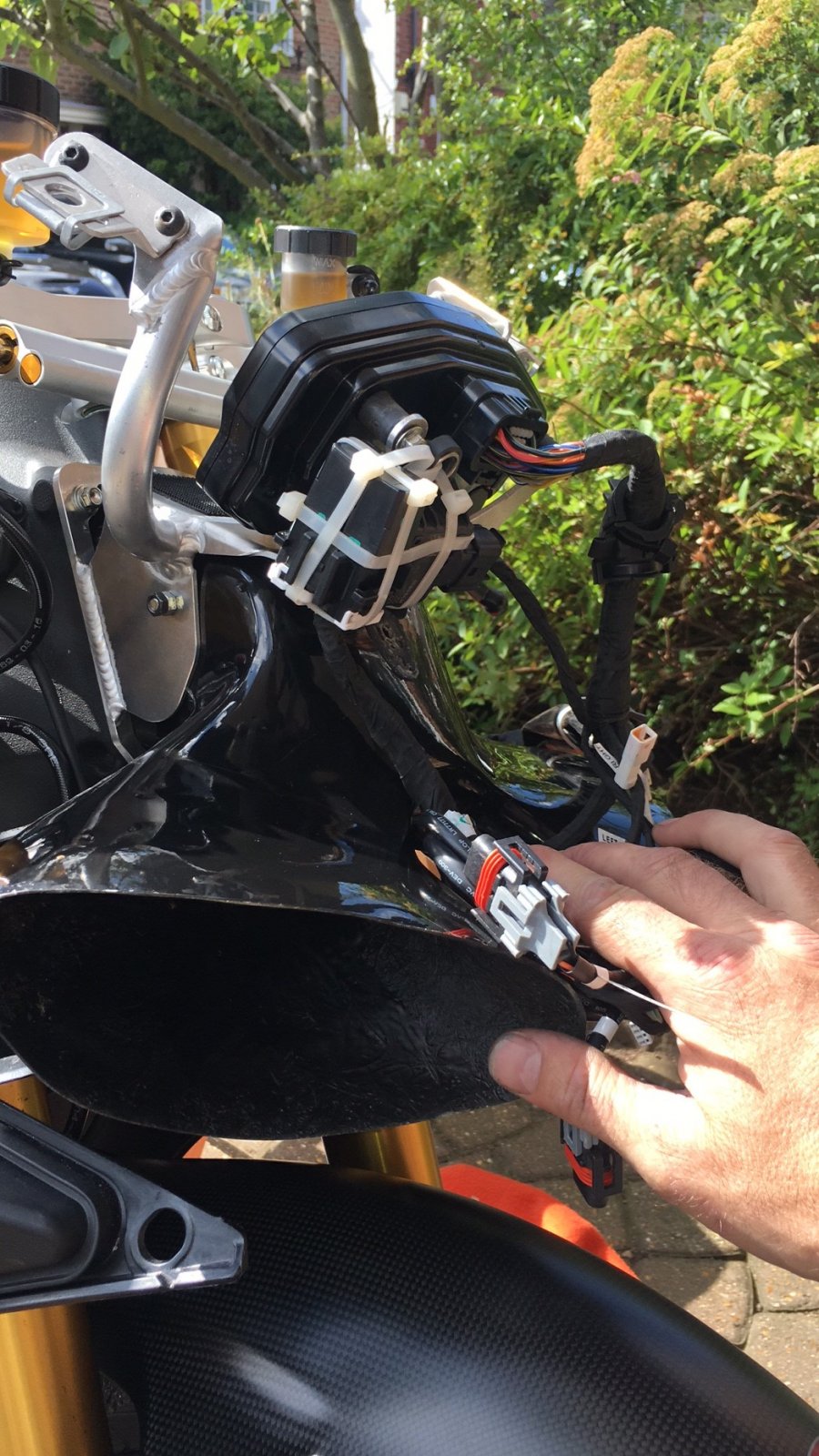

    I've added pictures of stock setup whilst fitting older style fairing stay to my new R last week. The IMU is underneath my DIY cable tie GPS mounting. You can see the upper shiny silver bolt.

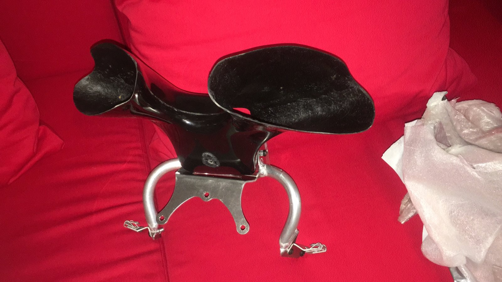

    Also added phot of the MWR fairing stay and what I currently have. It's made for the 1199 but I'm using it on the R with some DIY mounting of the IMU etc, hence why I'm interested. I got the rather lovely fairings from @Niven770 :)

  3. Looks like I did miss some details and the unit is at the same angle as the dash. Hopefully my cable tie genius will work ok. I'll try and do some testing tonight if I get home on time.

  5. Were can i get the proper bracket that holds the imu ?
  6. The 1 in the first picture
  7. WARNING! My DIY cable tie job did not work!! You need to mount the IMU on a proper custom made bracket otherwise you'll have a nightmare with the electronics malfunctioning. I had to turn them off on the trackday I did and ended up high siding the bike as the R is a bit of an angry b*stard.
    James - Haven't you got one on the bike that holds the IMU? I ended up putting the DP fairing blank in with the original IMU bracket after having a load of problems and a crash!
  8. Hi i got the kit off a memeber but he fotgot to send me the bracket that comes with the kit hes sending the bracket next week cheers for the reply
