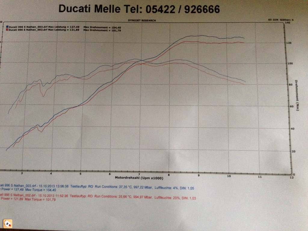

    as above, 50mm system, ohlins rear and standard stg damper. small P6 ecu with Twin injector throttle bodies.
    mine also had the TI rods and made 128hp at the back wheel after a power commander PC3 map..

  16. the 996s was particularly bad with the fuelling in the midrange, but a PC3 cleared it up

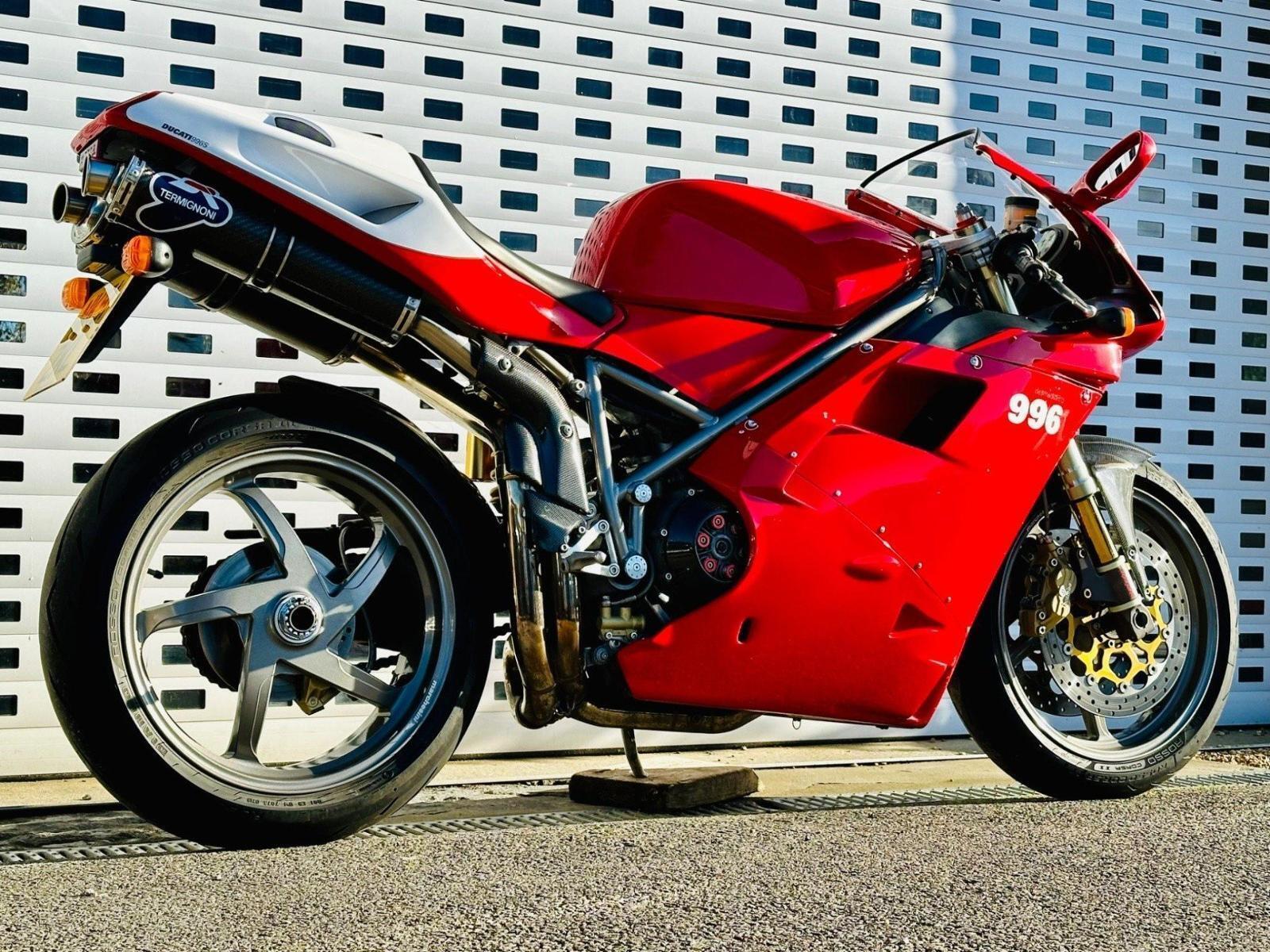

  18. Guys thanks for all the info, Put my mind at ease on a few things i needed to know,
    I ended buying one that was on ebay that was in Churches performance cars, Photo below,
    Regarding carbon parts is there a make out there that is recommended for these older Ducatis?
