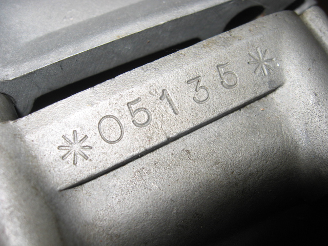

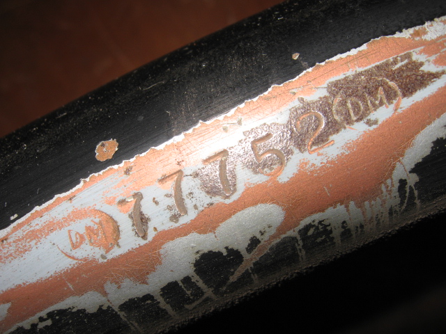

  2. The frames are not usually a problem, if it doesnt show signs of damage its probably fine.
    A word of caution. You dont say if its Spanish or Italian...Just bear i mind virtually none of the parts are interchangeable although look similar. . Crankcases, cranks, bevel gears etc are all different. If the engine/frame number starts DM its italian, if it starts MD its spanish.
    I am pretty sure it's Italian...
