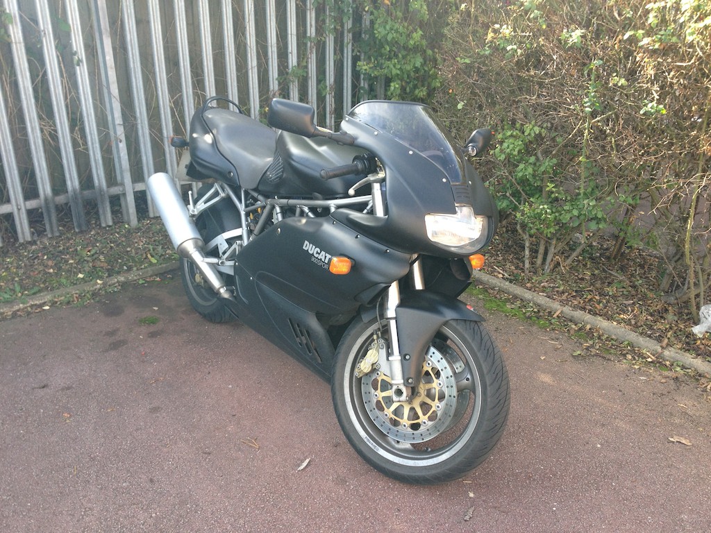

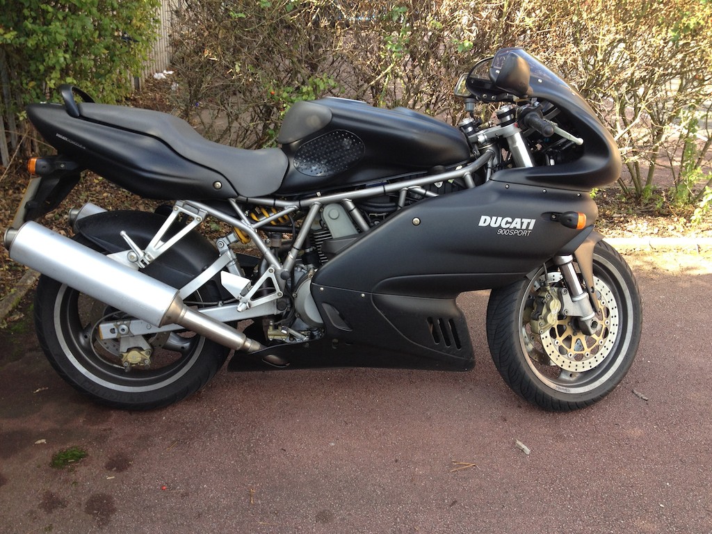

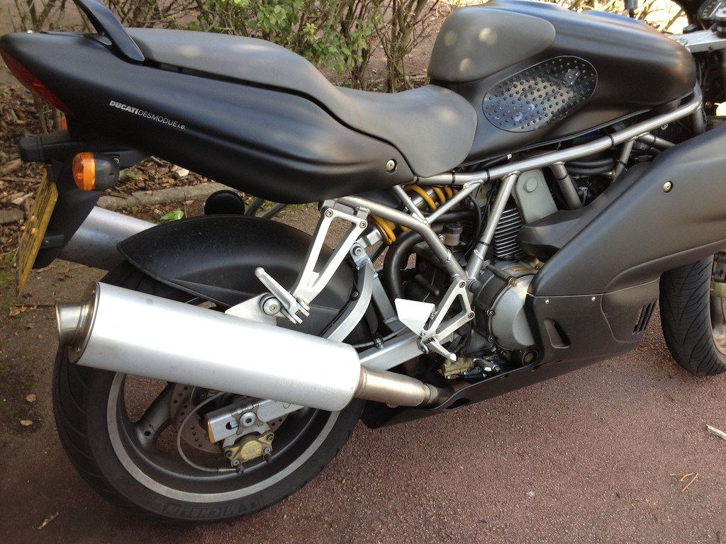

    I think even if it's a case that it was sitting somewhere since 2002, it was a good deal, it was first registered in april 2011 by the first owner, i'm the second owner. The original owner was a lady rider, she had a monster before this one for 2 years brand new, traded in the monster and some cash for this one, had this one for a year I have receipts for a full service and a couple minor upkeep services she has done for this bike within the 1 year she had it, all done at a ducati dealer, and she spent about £1500 on the full service (crazy!!!) and about £500 for each minor service. nothing major done, all belts replaced, she replaced tires just before trading it in again, oil filter changes. like I said bike looks good. She traded this one in again for a triumph this time...
    I'm attaching some pictures to give you a better idea. The bike is a matt black, 3 spoke wheels.

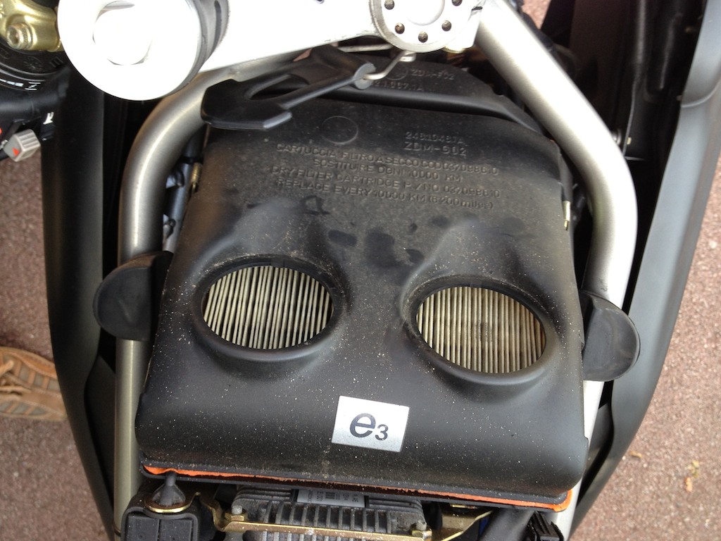

    I have taken a look as advised (and I apologize I'm really not much mechanically inclined, but I'm learning ;) ) under the tank for the air filter to see If i can remove the trumpets, are they the rubber ones that direct where the air is coming from? I will also attach pictures of what that looks like so possibly you guys can advise what would be best. Does taking those out affect performance at all? As I'm assuming their purpose is to direct the air to flow into the filter more rapidly?

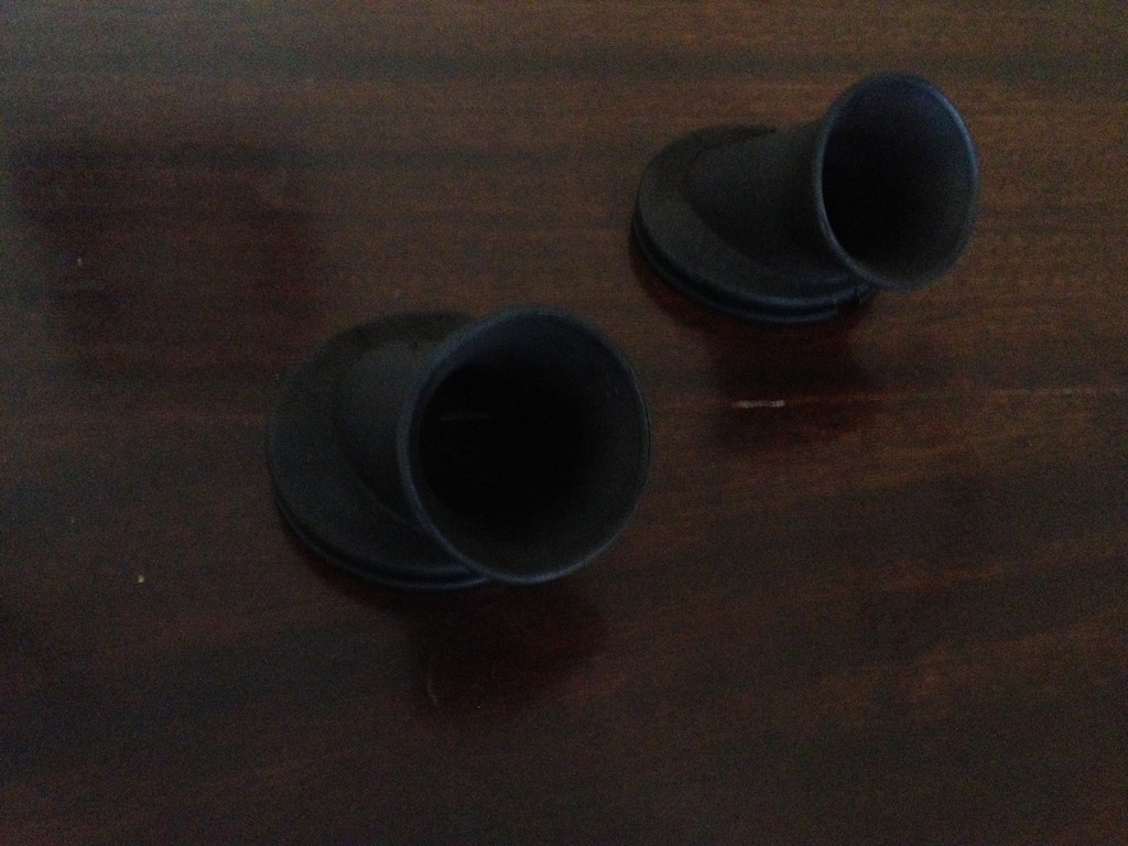

  13. FYI I have removed the rubber bits from the air filter as seen in pictures above. The bike sounds a LOT better :)
    Just wanted a little insight into whether this affects gas mileage, power or anything else.
    Thanks a lot for that tip, any other ones??? ;)
  14. Having removed the rubber trumpets, I would be inclined to check your plug colours after a good run......removing the trumpets may have weakened the fuel mixture slightly.....

  17. It might have knocked the power slightly if it has weakened the mixture....best way to check is to try with and without the trumpets.....
    In simple terms, plug colour near light grey to white is running weak; black is running rich; light brown/grey to rust colour is correct.......but take it for a good run first, don't just start it up and run it until it gets hot.
    BTW, taking the trumpets off only makes more induction noise, not more exhaust noise......that means the only person that really hears it is you...
