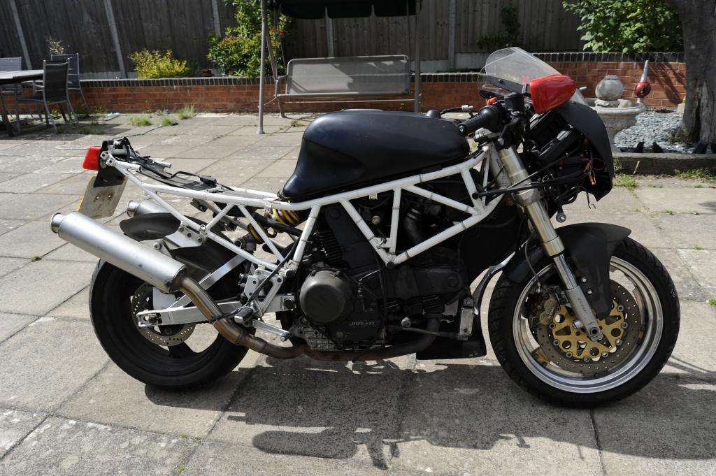

  8. The black one is going to undergo a full resto by Simon who did MKI #110 very recently so should look very good when finished!

  11. He was fine before, then afterwards the power scared the shit out of him so much he became the president B-)
