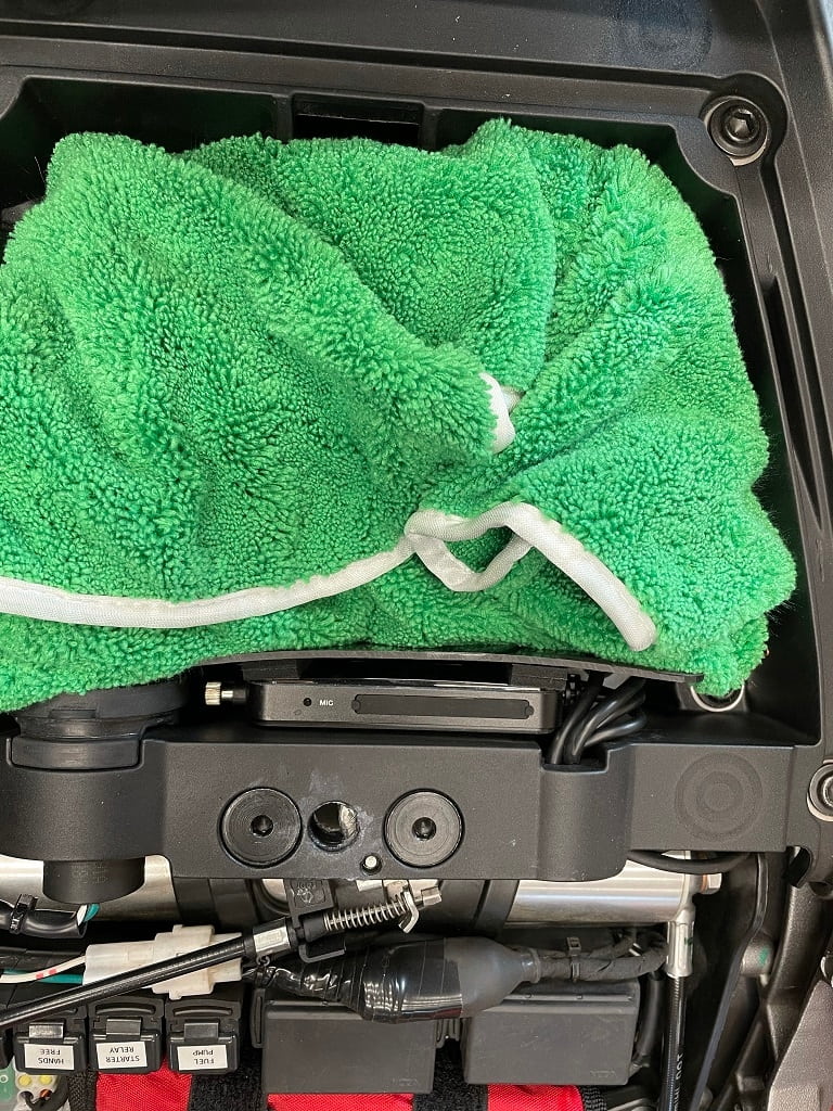

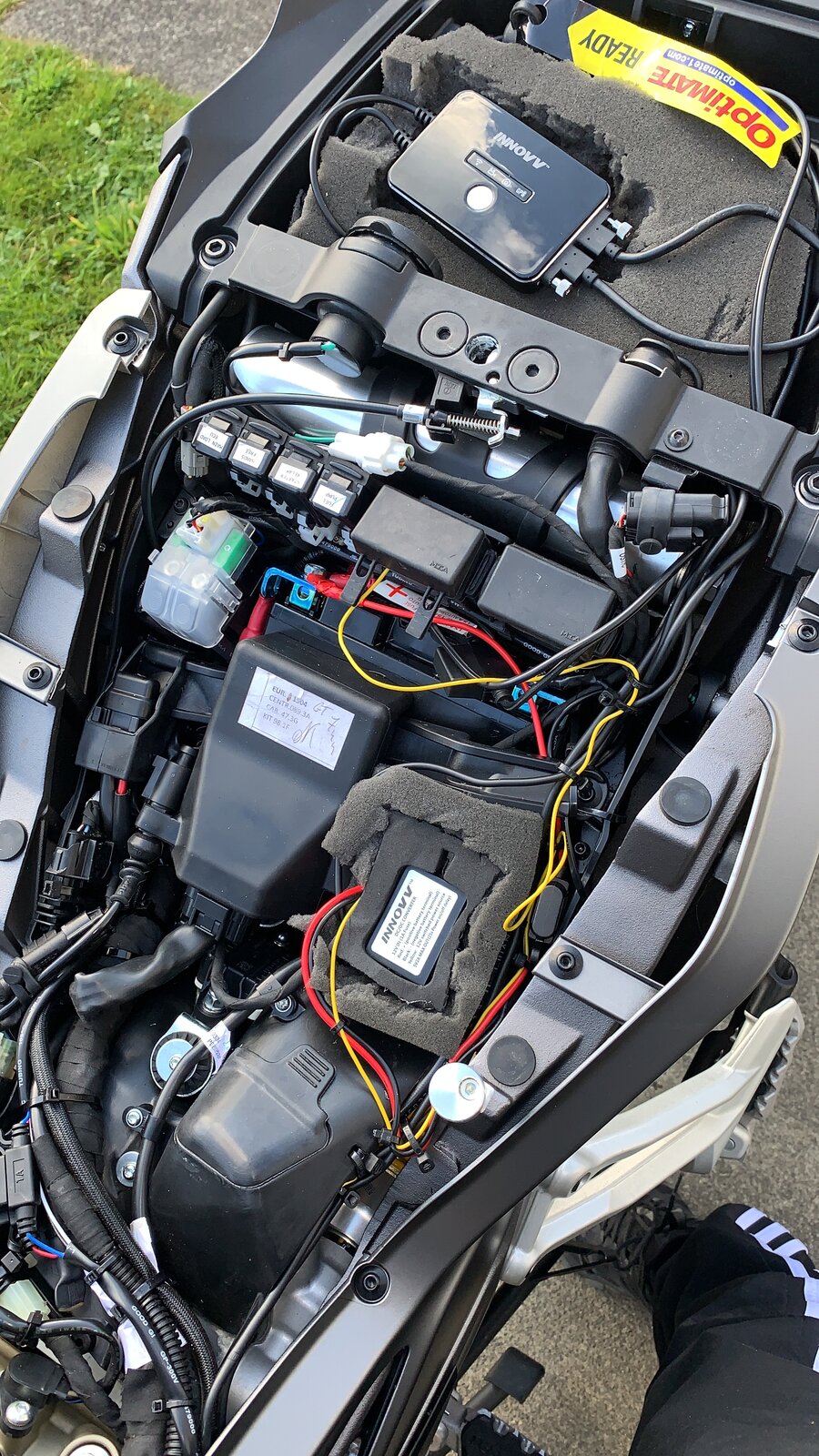

  11. HI LARS
    i have it fitted to my 1260gt 2020 it was fitted to my v4s first works great
  12. IT IS VERY GOOD VIDEO QUALTY

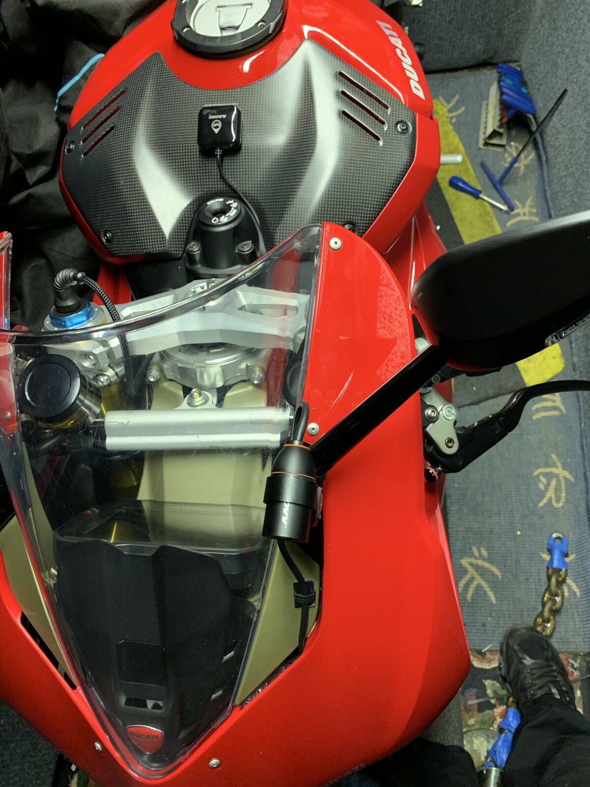

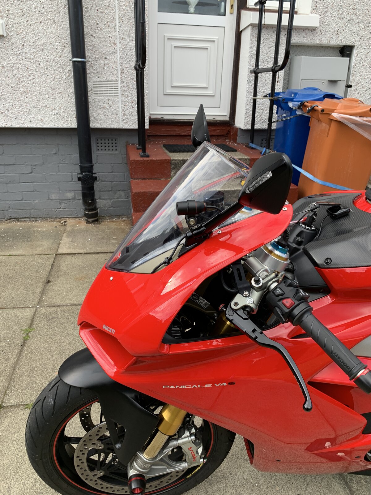

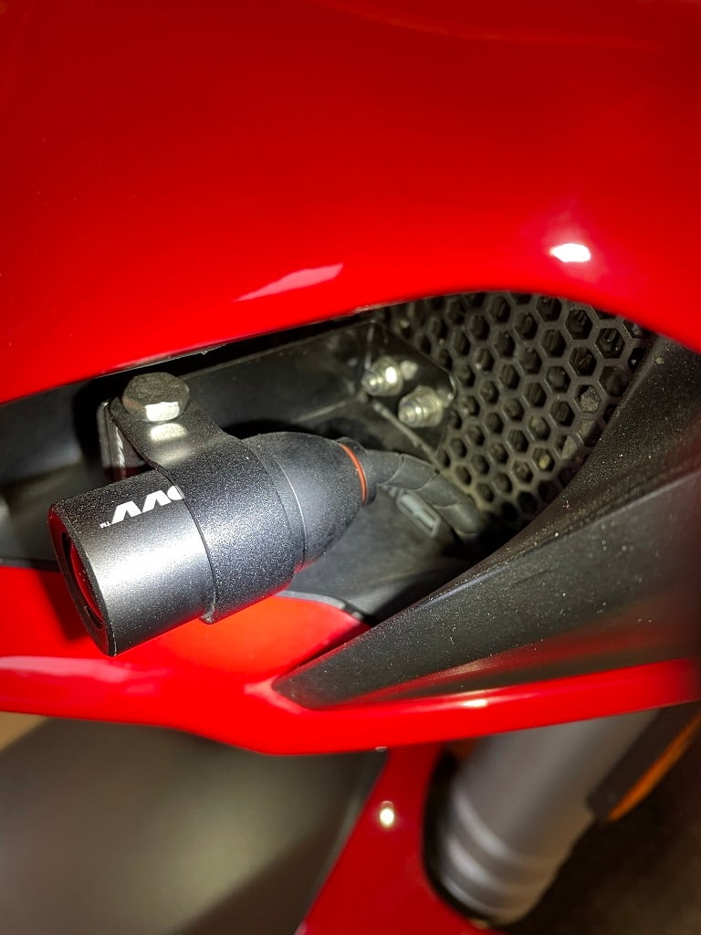

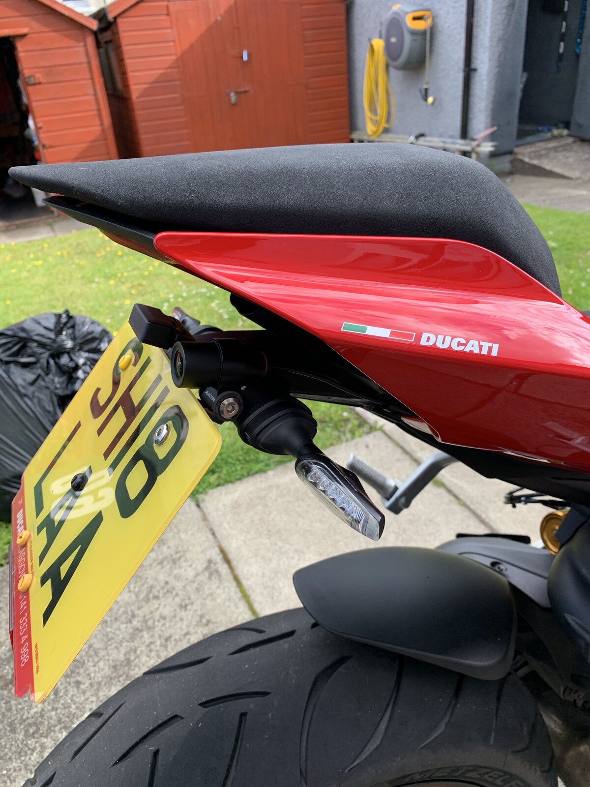

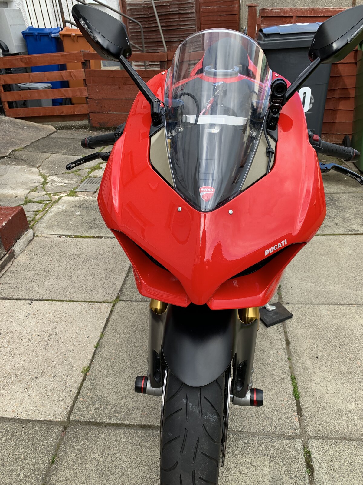

  14. I HAD THEM ON MY V4S PANIGALE

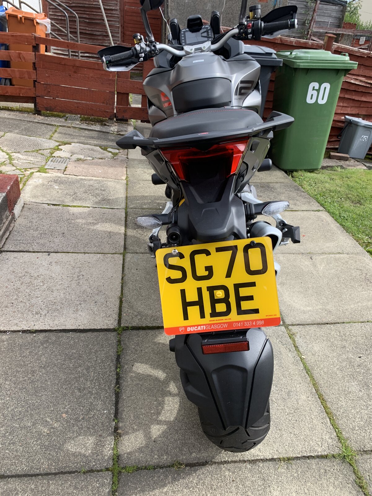

  15. HI the lights come with 1260 so i just fitted it to them and on the back number plate
    videos nice clear i don't use the sound on it

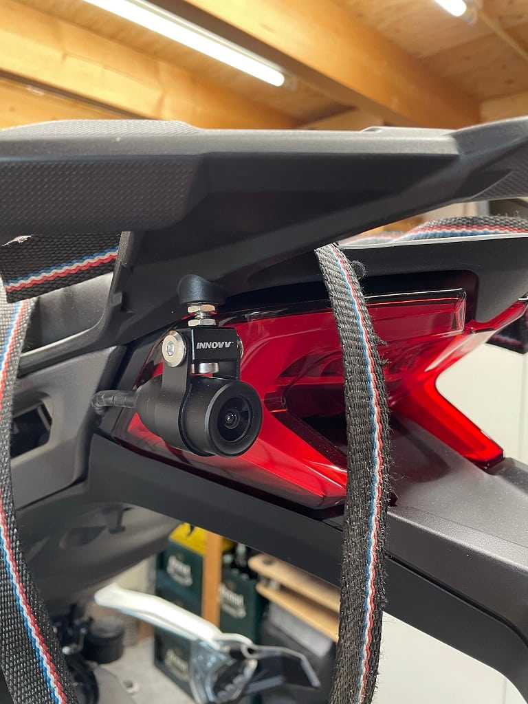

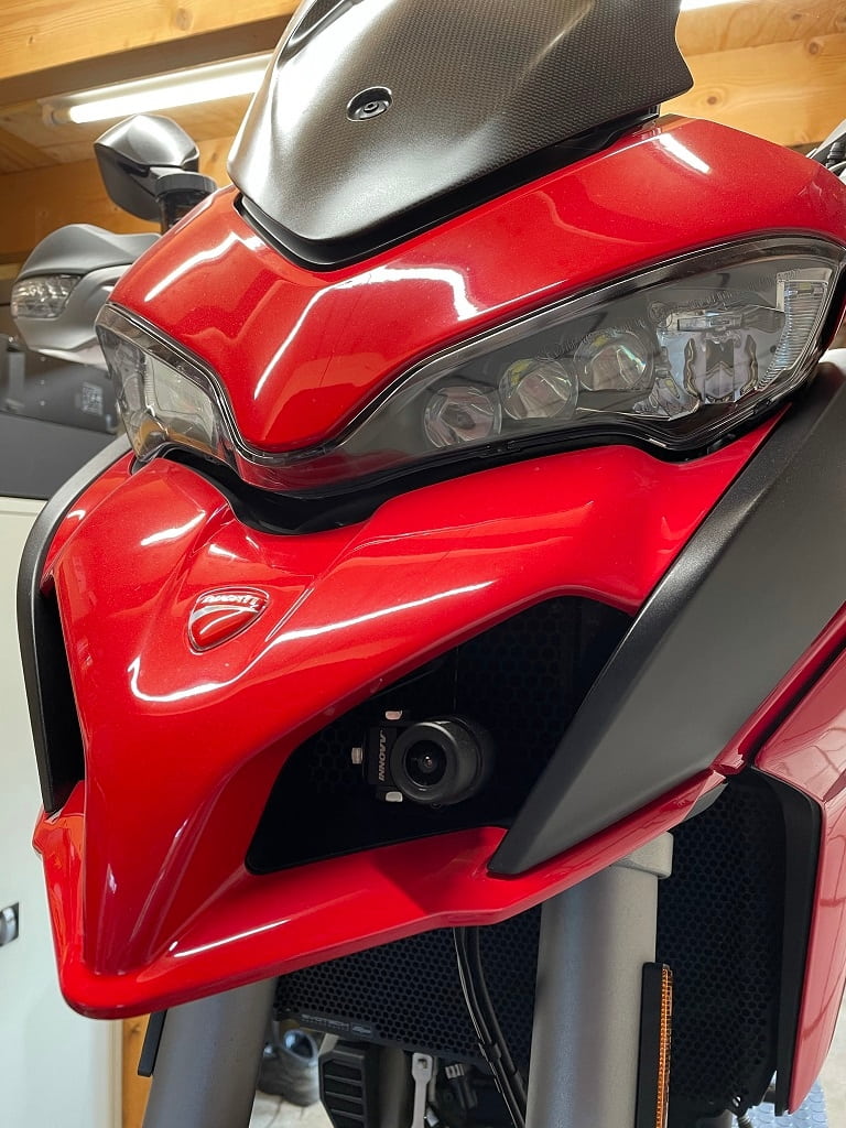

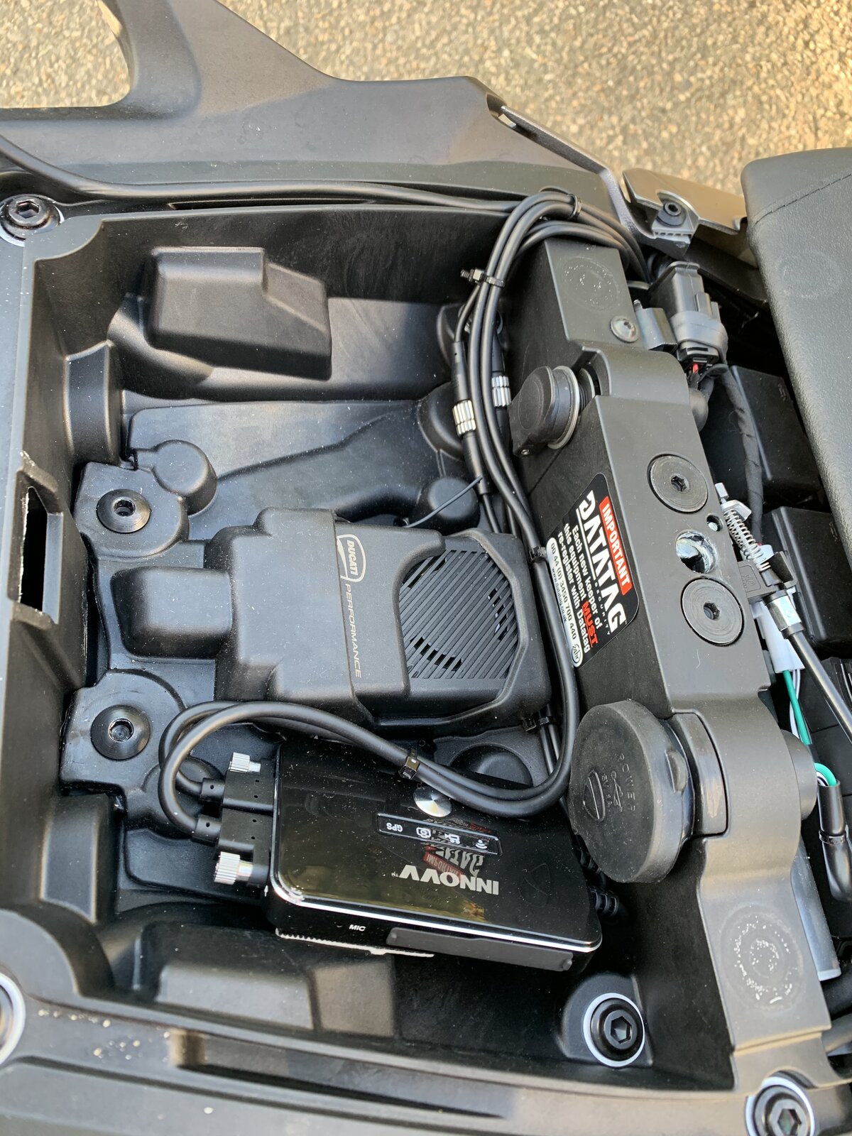

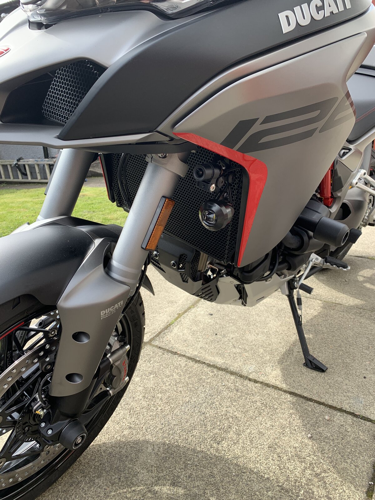

  19. I've mounted the stuf this way on my 1260S, took the power from the 12V socket cable (socket taken out)
    The front camera has only very few shivers when running the engine in low revs and powering :)
    The rear camera view is rock solid.
