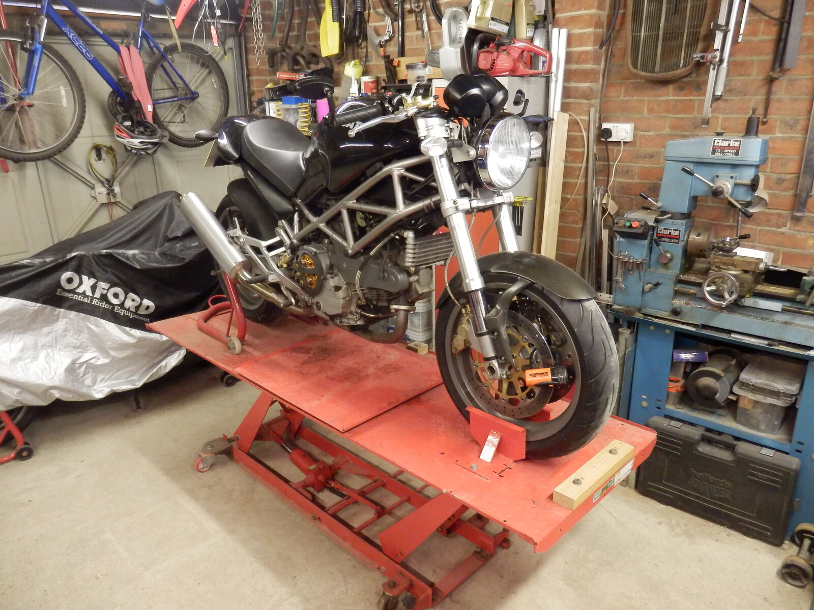

  1. I have a Clarke lifting table which uses their equivalent of the WCR01 Sealey clamp. You clamp it by winding the left side clamp to pinch the tyre. With the Clarke version it is difficult to apply enough clamping pressure to hold the bike really firmly by the front wheel alone. So I either put it on a centrestand (which most my bikes have) before applying the clamp, or use additional tie down straps.
    I have used similar to the Sealey roll in clamp in a van. It would be difficult to put a heavy bike on a centre stand with this design as you can't roll it back. As their ad says, the bike should be further strapped, not just relying on the clamp.

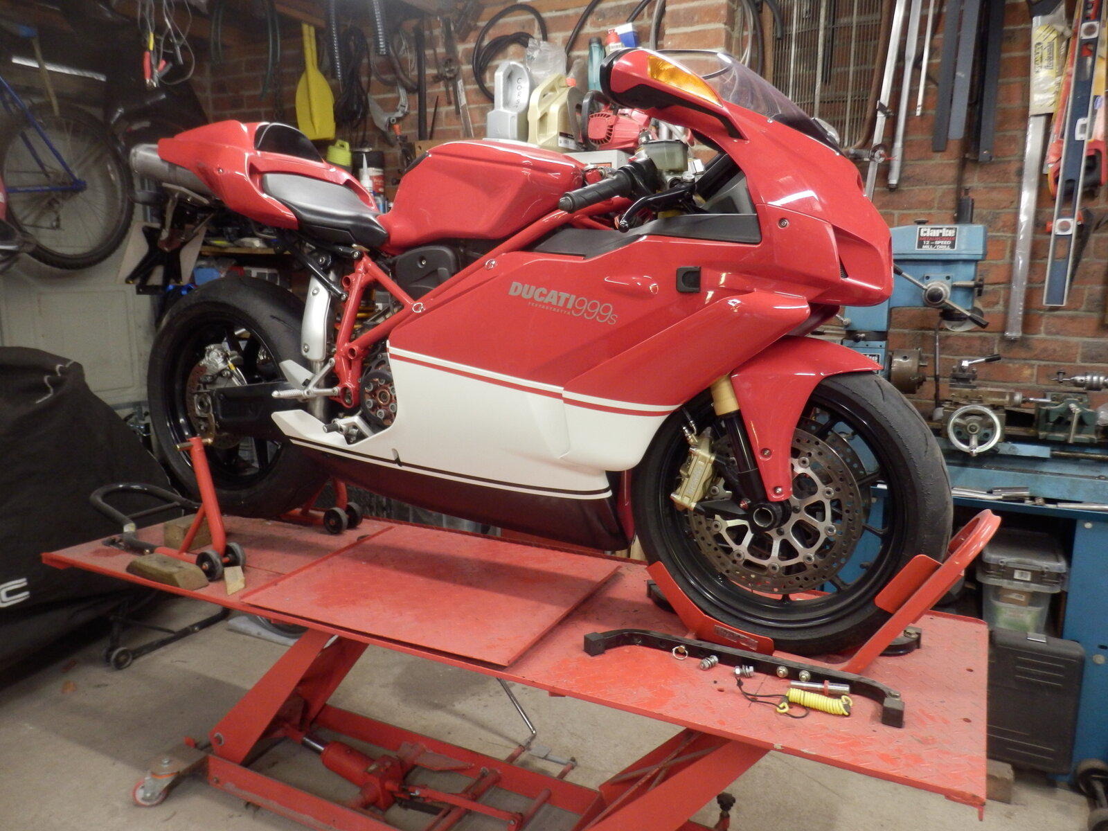

  2. I junked the original vise style clamp as soon as I brought my bench and bolted down a roll in style one, sorry, I can't remember where it came from.
    As has been mentioned by Geoffrey Lebowski neither design lends itself to the use of a centre stand. I only use rear paddock stands with hooks or clamps that flip themselves forward on wheels as you use them.
    The clamp grabs the front wheel really securely the moment the rear part flips up, and I'm more than confident to let the bike just sit there on its own for a while whilst I get the rear paddock stand in place.
    Note if I'm going to be working on the bike I often also have a small ratchet strap either side to strap the bike down and stop it falling over.

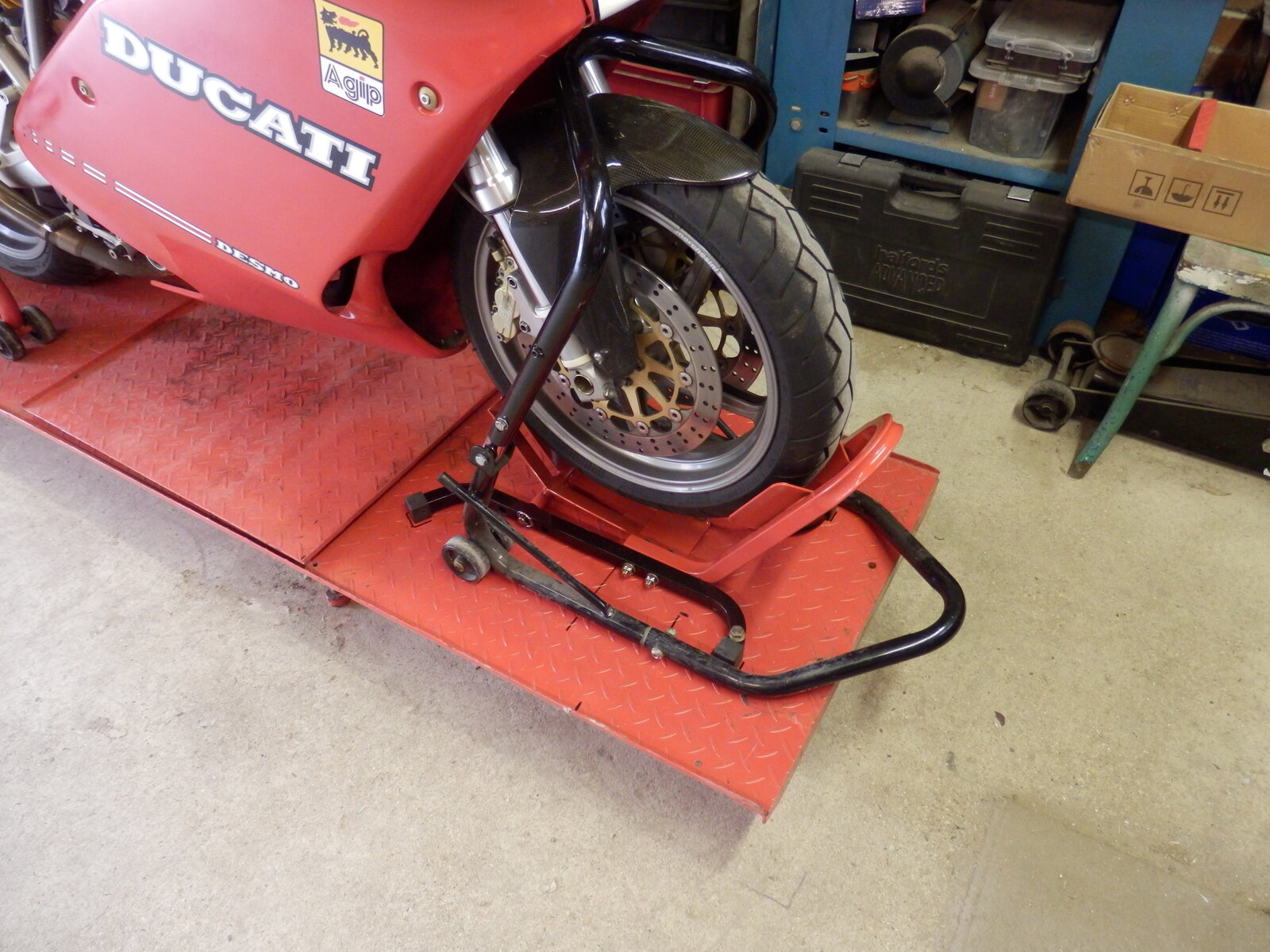

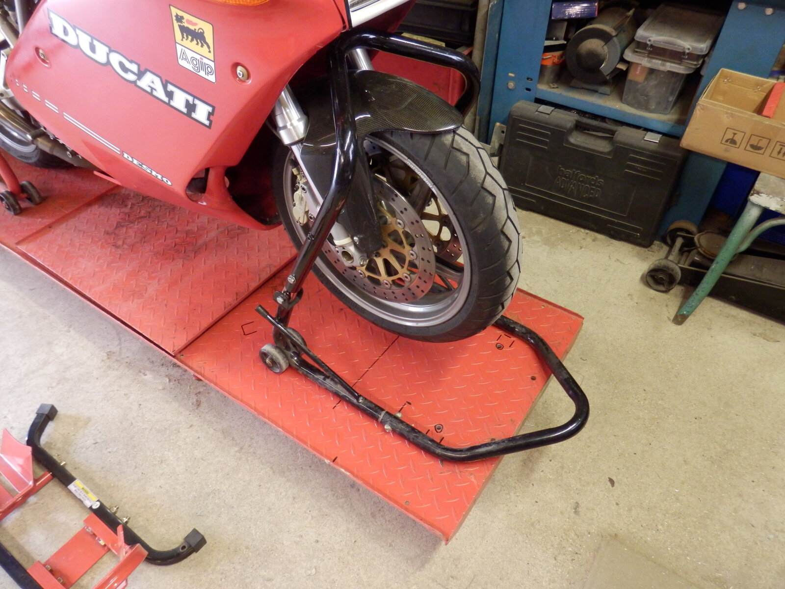

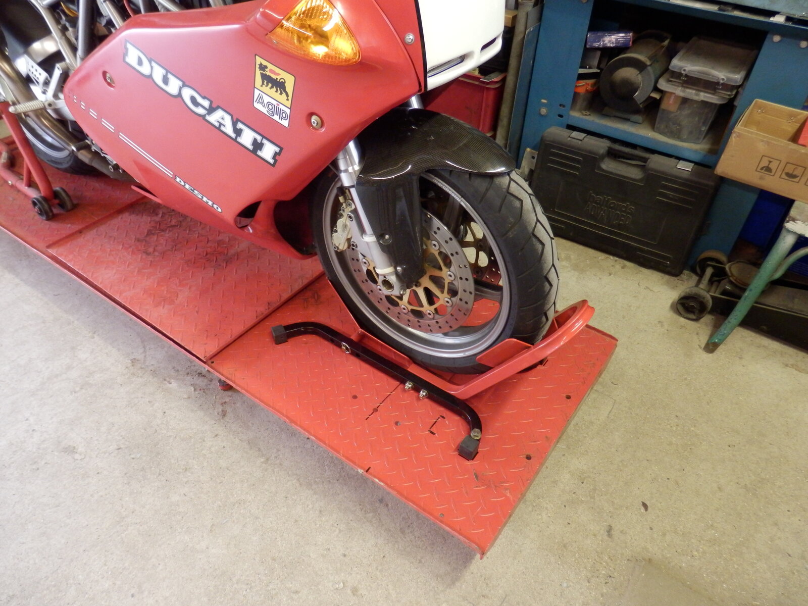

    The obvious disadvantage of this type of front clamp is the inability to raise and remove the front wheel, Forks etc.
    I wanted to be able to do this, so shortened the front legs very slightly so I could get my preferred under-headstock front paddock stand in as well.
    I get the bike on a rear paddock stand:
    Then lift the front end on the paddock stand:
    Then disassemble the roll-in clamp from around the wheel:
    Then do the reverse when I'm done.
    It's all far more stable than the original clamp that came with the bench.
    With that you had to hold the bike upright whilst trying to get a stand under it as well.
