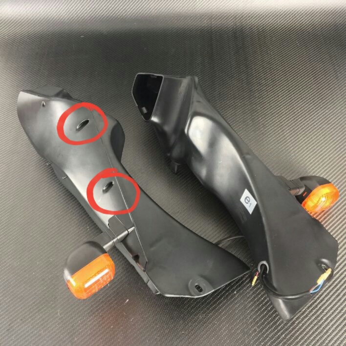

  1. So my intake runner tubes no longer seal properly due to stripped wellnuts.
    Airbox pressurisation not happening, no funky Helmholtz resonator sounds :(
    I've tried ordering M6's, M4's.... none fit! What size are the furshlugginer nuts??
  2. Where are these wellnuts fitted?

    • WTF WTF x 1

  4. Ah, ok....so to clarify, I'm talking about the nuts that hold the circled screws in:
    Mine have stripped the rubber wellnut and no longer pull the two pieces in tight.... at least I think they're wellnuts?
  5. Think there self taper screws mate, if they have stripped it will be new air tubes.
  6. try a soldering iron and an plastic cable tie and try to melt the 2 together in the threaded hole and the self tapper should be a tighter fit

  8. Great, those are the ones. Mine are definitely not self-tapping. Must be a quirk of the early bikes.
    Thanks for the links, it might just be time for new runners if I can't get these ones sealed.
