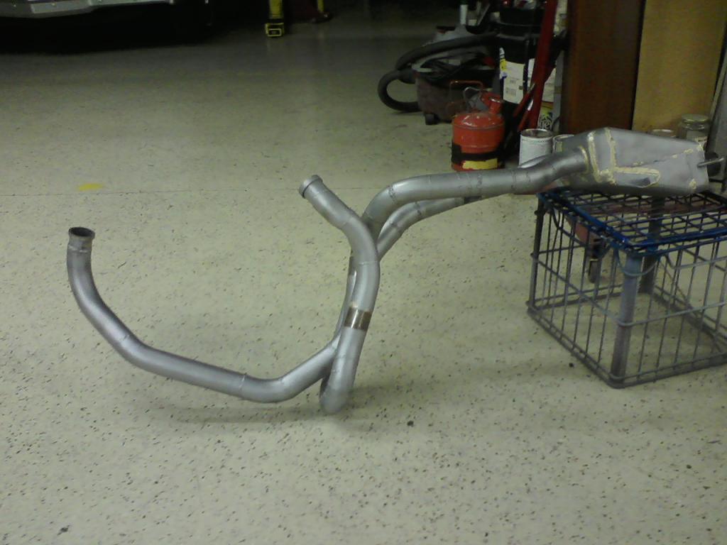

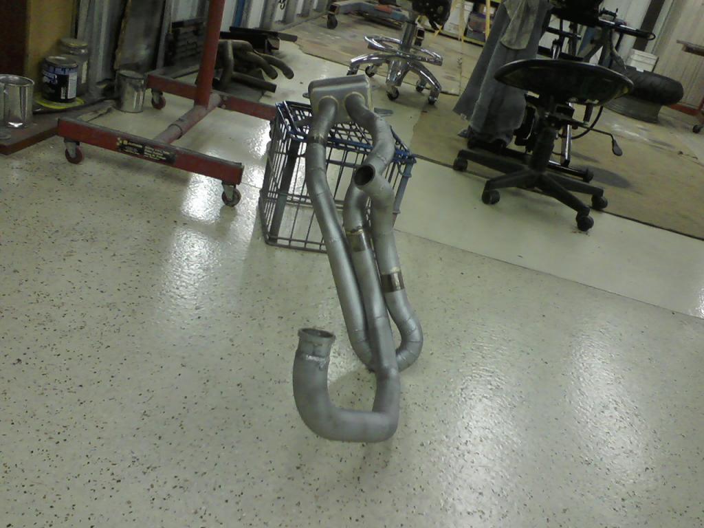

  1. A chap who made contact with me from Alaska last year, while I was doing up my 900ss, and who had also just completed a similar build
    just sent me the below link and photos, I figured I should share, its the right thing to do...right?

  2. Be interested to see what it looks like when bodywork and seat etc all in place, not sure about he twin outlets but may work with height seat unit

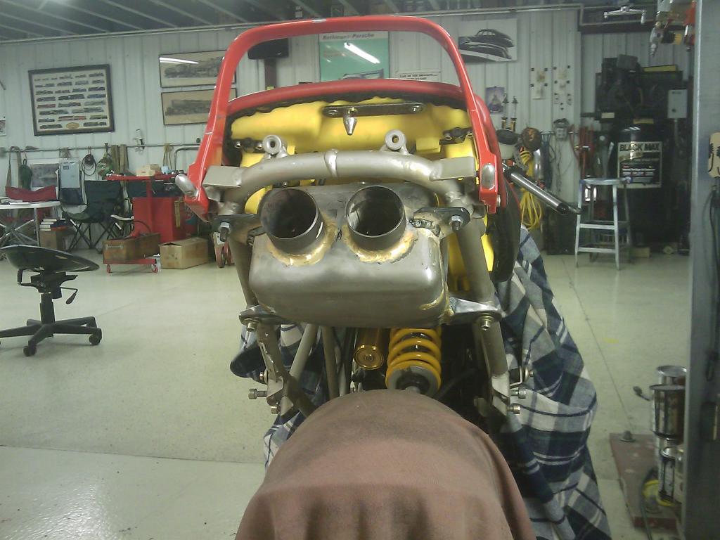

  5. Looks incredibly neat, and some of the changes online all round, radial calipers, relocated ignition switch? Not sure tho, the 2 out pipes look a little unfinished. Clearly loads of time effort and planning gone into it

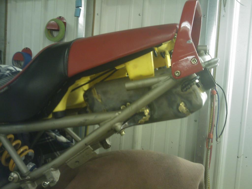

  6. I like that look, but what sort of heat shield would be needed to save the plastic under seat from melting on a regular basis??

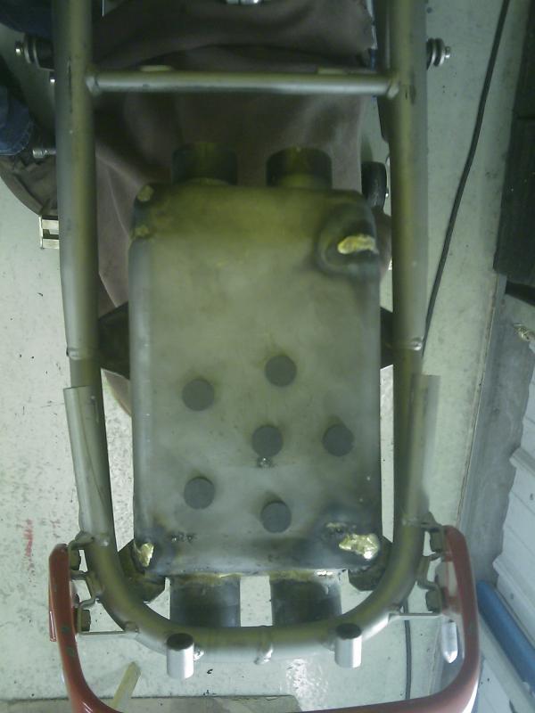

  7. I wonder how he gets at the baffles or repacks the box.......
    ...and unless he has 'through' pipes inside the box, then the gases won't escape easily.....
  8. I would not think they are packed Al....it all seems very tightly welded up.
    I would agree with Bradders the outpipes look a little short.
  9. If there isn't any packing in the box, then there isn't any point in being there, really........I wouldn't think a Ducati would like back pressure much either.

  10. No different to a straight thru race can tho is it?
  11. Fair point..in fact points...maybe it is packed...and he has to get out his brazing torch to re-do the packing...or he has packed it for life.
    Who knows...shall I ask him?
  12. Well.....Yes it is different....because if he has pipes that go straight through, then the box isn't necessary......or if they do not go straight through, then he has created an expansion chamber (not necessary on a Ducati or any four stroke really) and doesn't allow a smooth passage of the gases to escape.

  13. I'm sorry, but if I had made that, I wouldn't want pictures of it on a forum. Yes he has put some work into it with segmented bends etc, but its not aesthetically pleasing.
