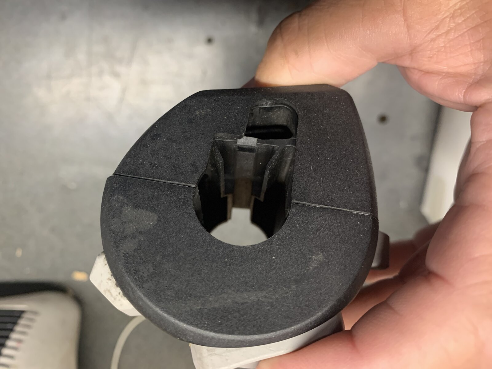

  7. Thanks Hill. I'll check that.

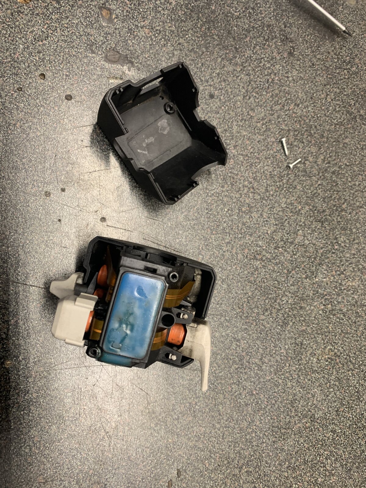

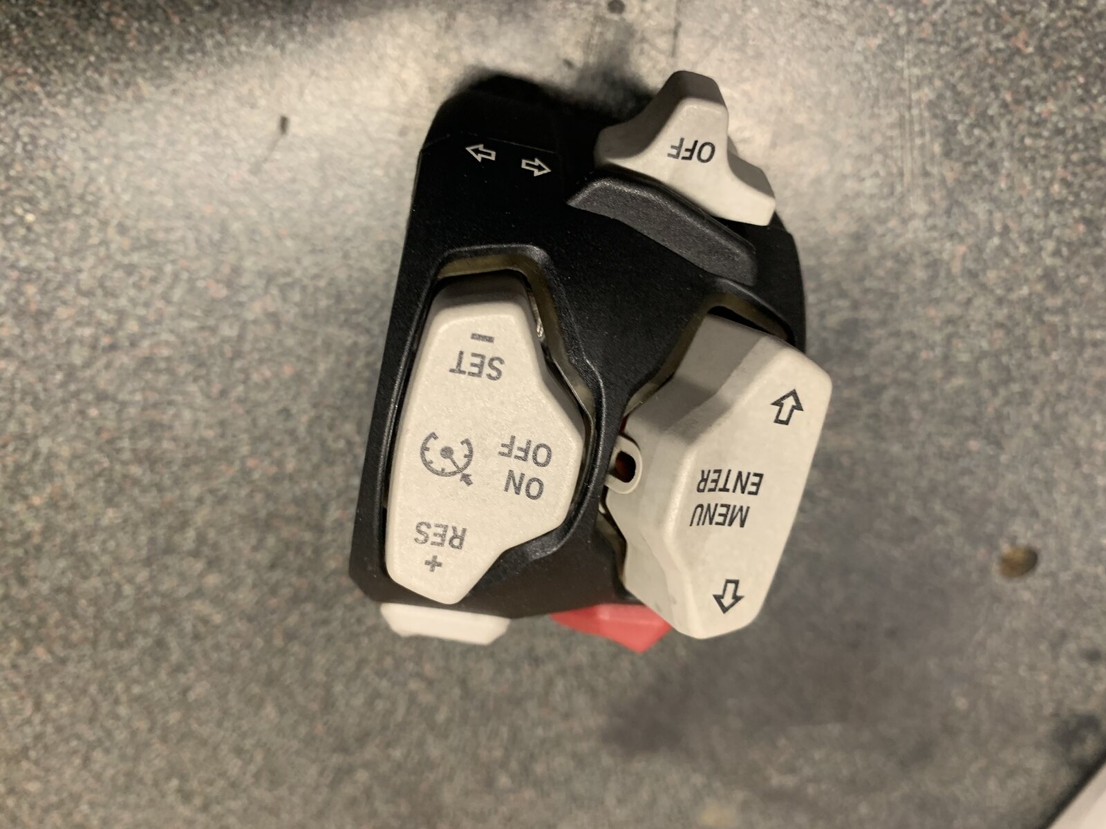

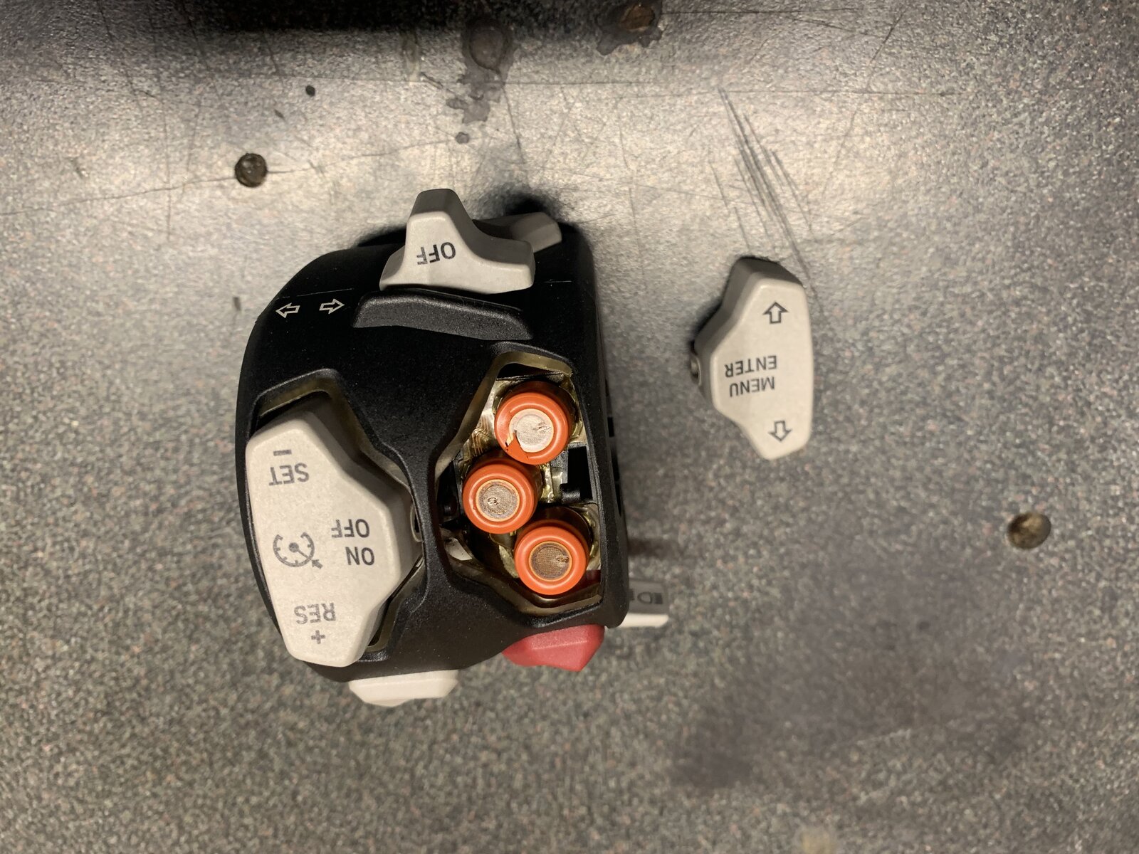

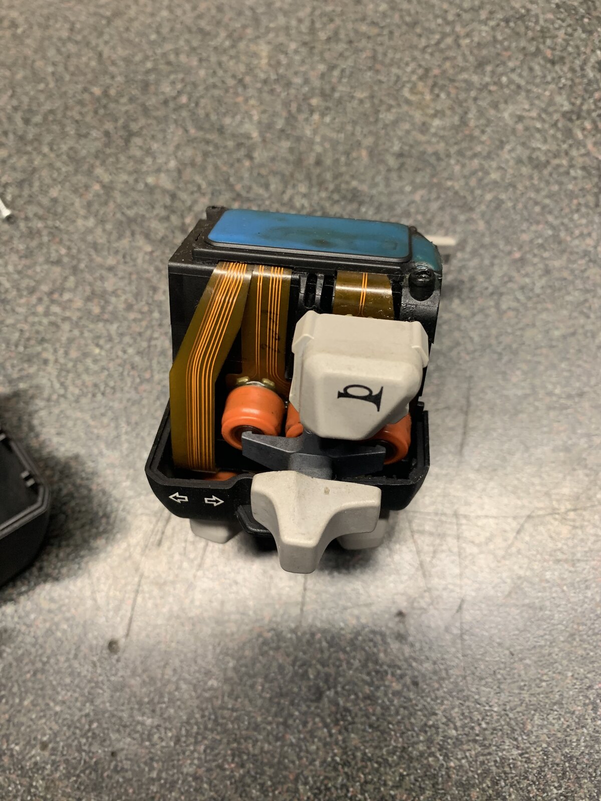

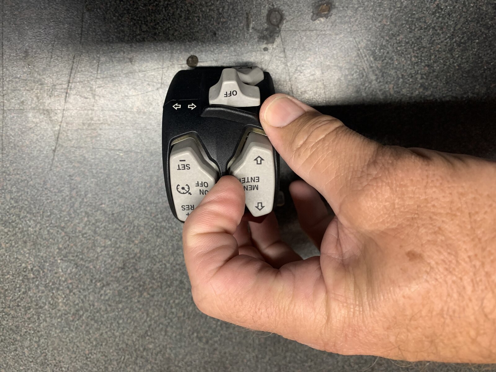

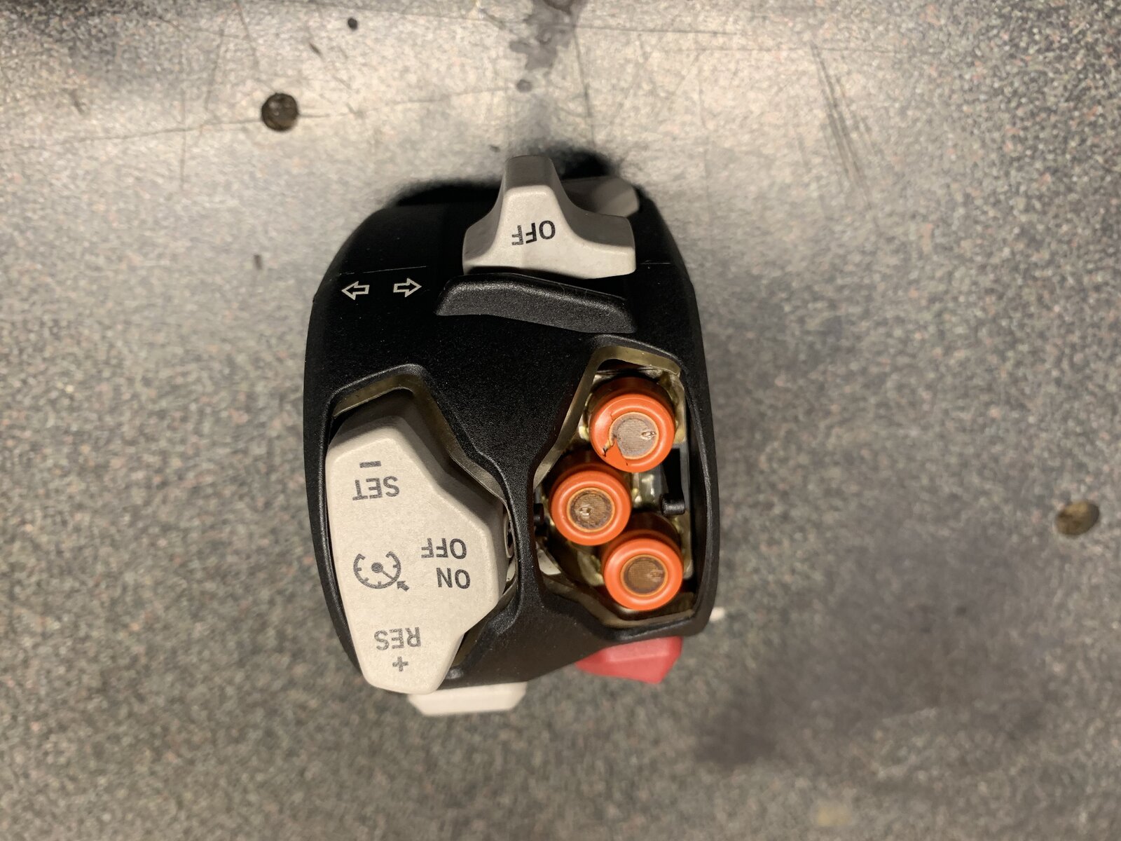

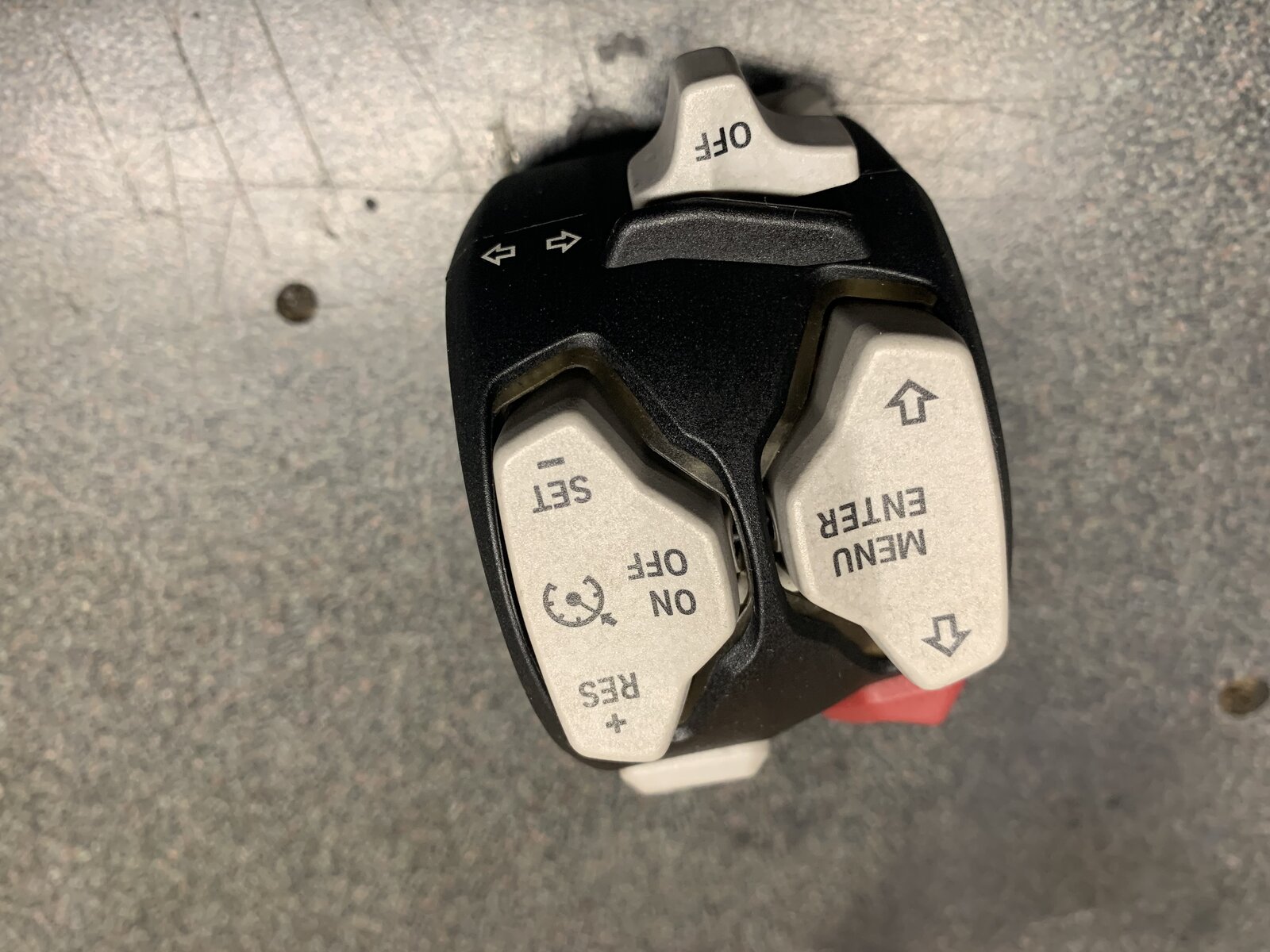

  12. The inside of the switch is all circuit board and sealed switches
    I’ve had a look inside mine as the buttons were sticking
    The rocker parts spring out to reveal the actual switches, the loom plugs in at the lower side, worth checking to see if it’s plugged in ok- usually get a warning triangle if it’s not
    Hopefully some photos for you IMG_2814.jpeg IMG_2815.jpeg IMG_2816.jpeg IMG_2817.jpeg IMG_2818.jpeg IMG_2819.jpeg IMG_2821.jpeg IMG_2822.jpeg

  18. I didn't know that. I didn't think those little screws were man enough to clamp the switch to the bars, but didn't know about a special tool being required. Do you think it is something you can get by with a little imagination and usual tools? It will be very annoying to have to pay dealer rates just to do a little job like that.
    Or can those rocker switches be popped out without having to dismantle the switch?
  19. It’s a shaped bit of spring steel just to depress a retaining tang in the switch body
    I’ll post a picture of mine later this evening so you can see what’s involved
    Yes the rockers “spring out” with the switch insitu, if you consider an independent rocker that activates a waterproof switch under it you get the idea
    One of the photos above shows the pivot pins that hold them
    The lower cover also comes off no problem
