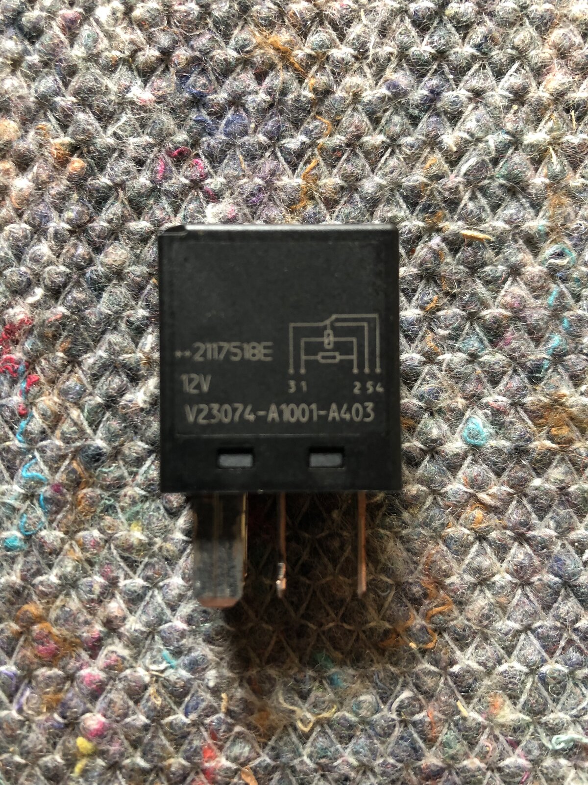

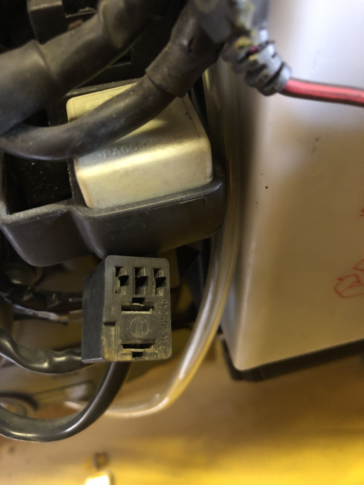

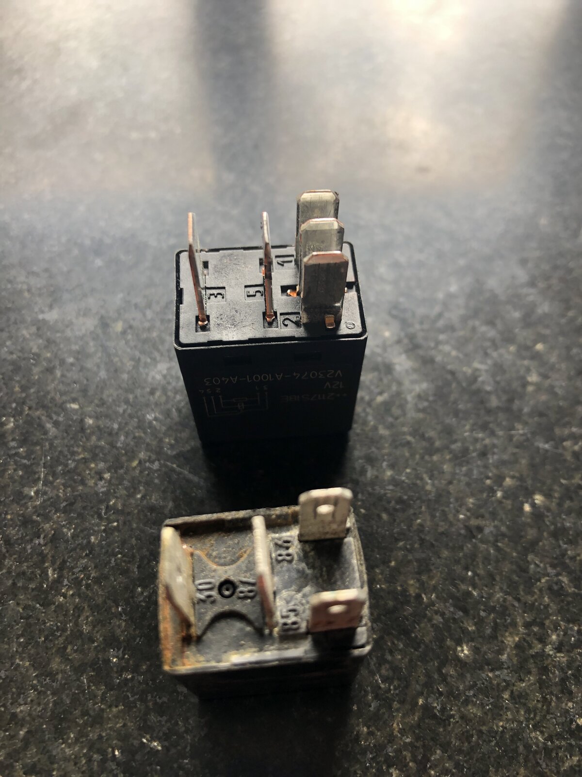

  6. New replacement relay at the top, but oddly has 5 pins, whereas the old one has 4 pins (connector block has 5 slots)
    Seems to work, fuel pump primes and bike fires up ok :)

    New relay supplied by Moto Rapido, product code 54140181A

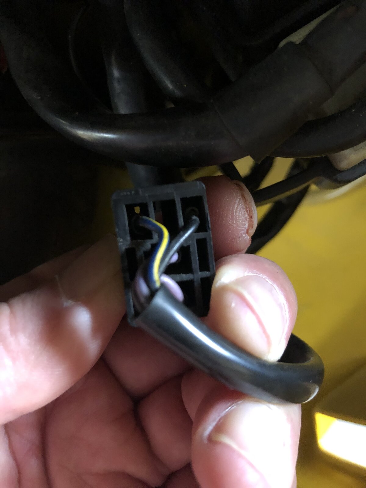

  8. No such switch on a 916 …
  9. The top middle slot on the connector block isn’t wired anyway so 5 pin relay seems to work fine
