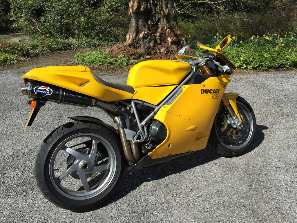

    I've just taken my beloved 998s (owned from new) out of storage after nine years. Spent several weeks prepping it (belts, much oil-priming, plugs, forks, etc.) and today was the first run out. OMG it's like going back in time!
    Anyway, all good except one thing -
    Very intermittently, (but always if I short-shift) the bike "misses" for about half a second and then picks up again. If anything, I'd say performance is subdued somewhat overall, but this could just be down to elapsed time not riding it. Anyway, I wasn't for totally caning it when I knew it wasn't running right. The issue isn't at a specific rpm range and (apart from feeling like the thing isn't quite so sharp as I recall) running doesn't feel lumpy at all. In fact, apart from this, it feels bloody great!
    What I also noticed is that the rev-counter needle is fluctuating quite a lot all the time (say +/- 500rpm). I think in the half-dozen instances where it coughed, the rev-counter needle may have dropped to zero for a split second (I stopped short-shifting to avoid the problem, so didn't always catch the behaviour).
    The only thing that's changed since the bike going into storage is that I had to bypass and remove the Meta alarm as it had failed.
    Anyway, as ever, any advice would be appreciated very much.
    Thanks in anticipation!
    L
