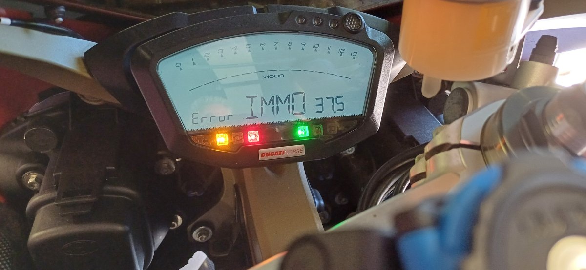

  11. A failing crankshaft position sensor will result in no crank/start with yellow fault light. My sensor started to fail intermittent causing no start for a few minutes before coming back to life.
    A good thing to do is getting a diagnostic cable and guzzidiag so you can check the codes.
    On my bike, immobilizer error shows on the dash.
