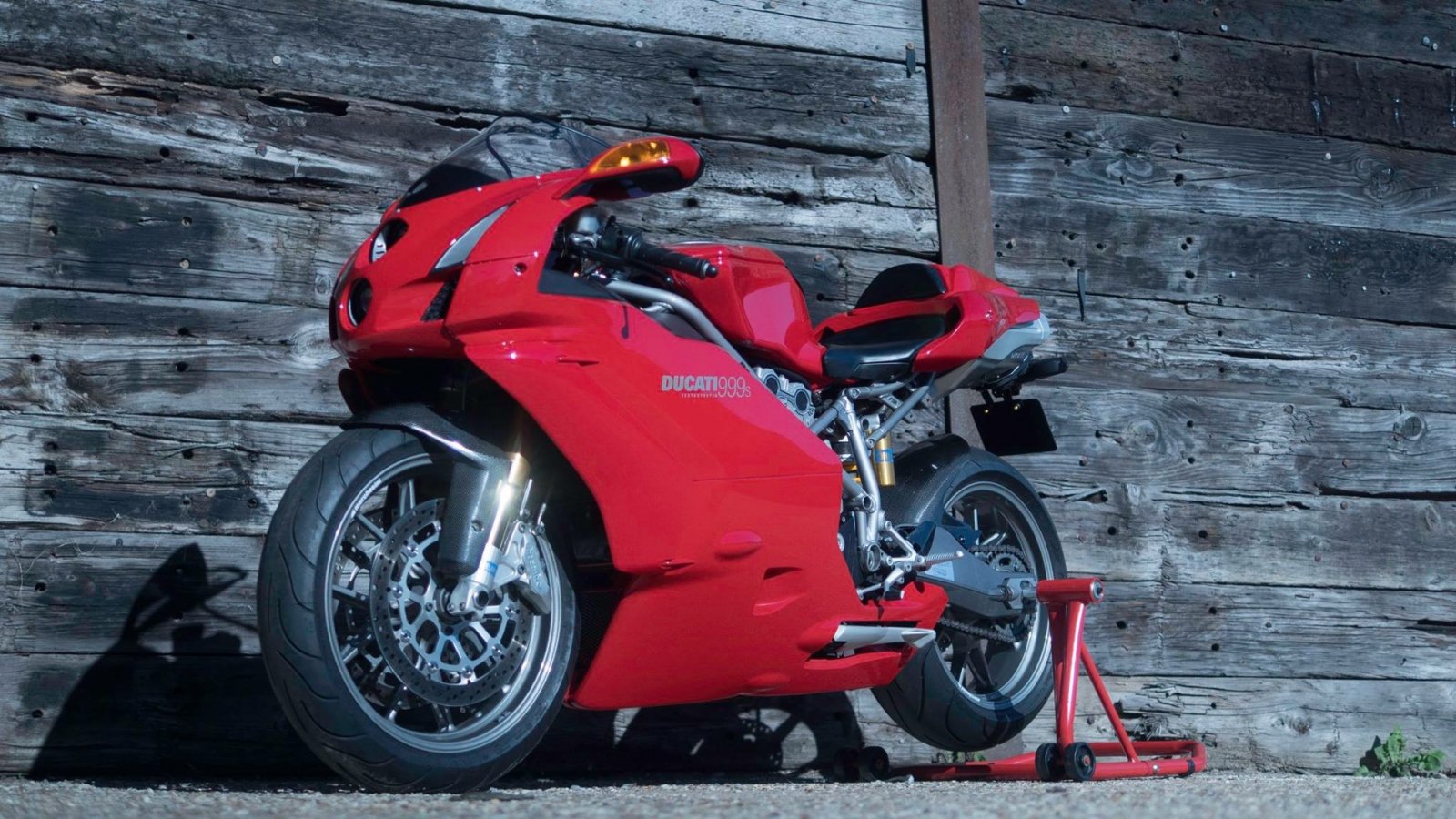

  1. looking to purchase this 999s unsure on mono or bip
    V5 says mono seller says bip - checked with ducati.....
  2. it's hard to tell from that pic but I think its a bip with a pillion seat cover on.

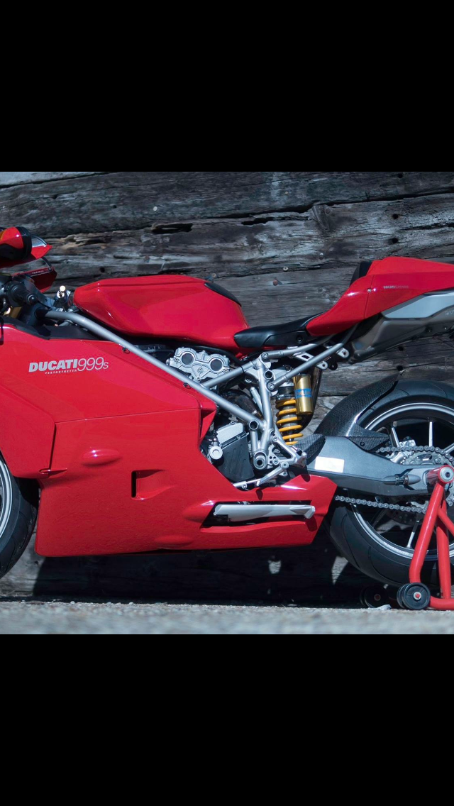

  6. Has them - ali pegs but not Fitted
  7. Looks like a bip to me. You can see pillion footrest mounts.

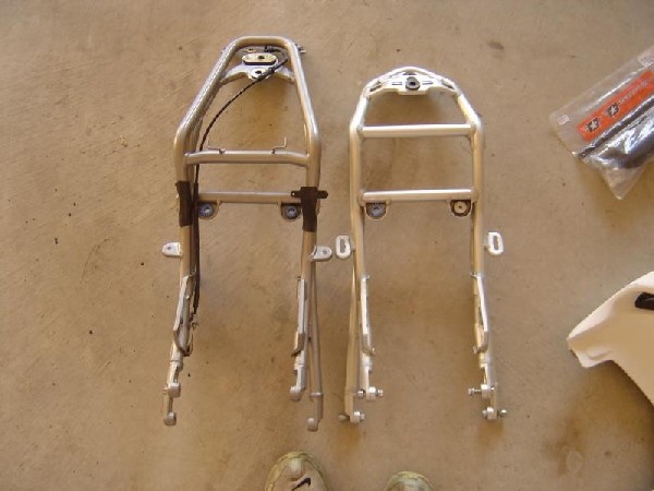

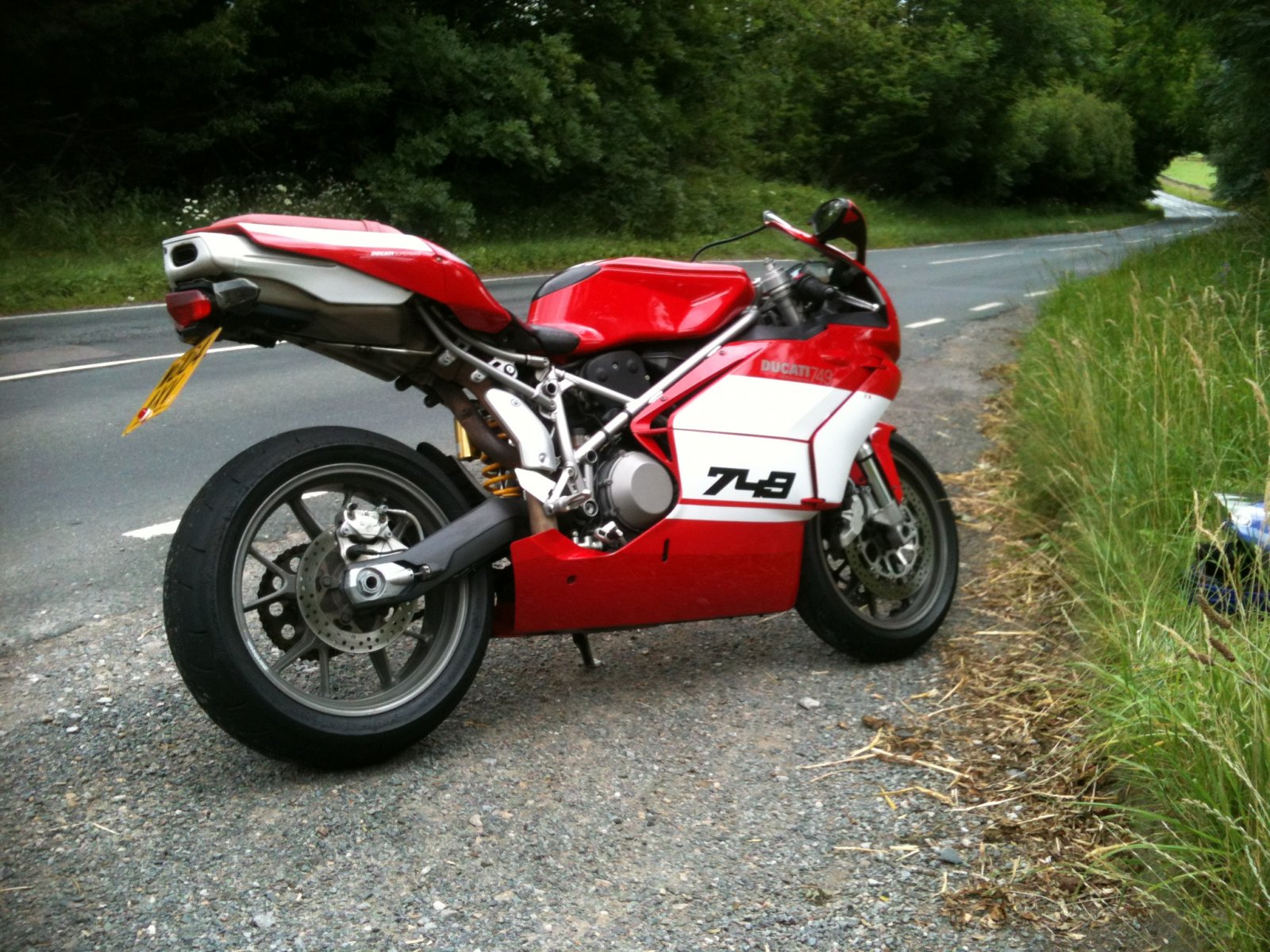

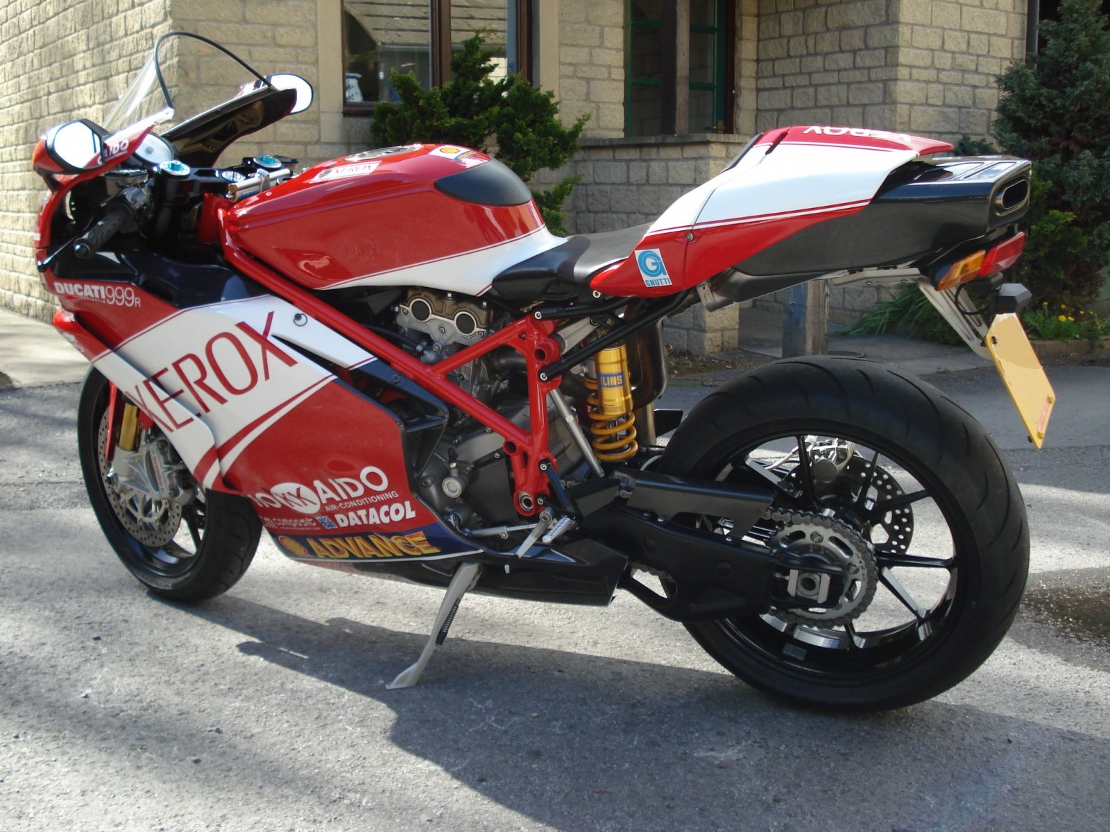

  15. the rear frame is a bip with the pegs taken and the seat taken out and a seat cowel in place of it also they will be a key lock on the right side which is not on a mono a seat will go straight back on with the lock a mono frame is shorter than a bip f you look at the frame on the 749 that is a bip same as your thinking of buying look at the Xerox frame that's a mono see 43184d1233930692-749-mono-subframes-subframes.jpg IMG_0162.JPG DSC03005.JPG the difference
