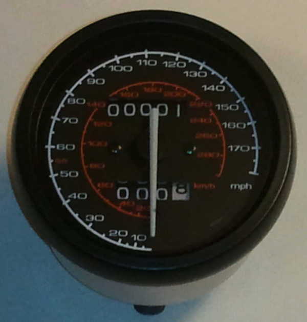

  1. I've recently purchased a 998S and I've noticed that although the speedometer is correctly displaying speed in MPH, the odometer and trip are recording Km. The previous owner did not mention this, so this means the bike has covered around 9,000 miles less than I thought - which is nice.
    I'm assuming this means my bike was a parallel import rather than the norm for 998S, but is this the case? Is there any way of confirming this?
    I've tried contacting Ducati.com but they seem to insist on gathering every piece of information about me short of a DNA sample before they will even confirm if they can answer my question.
  2. The only way the speedometer will record kilometres on this model is if it is a kilometric speedo. These models had dual readings on the speedo face in MPH and kilometres but the mechanism that records the mileage will be different for the UK compared to Europe.
    I replaced the speedo dial on my hybrid 748R when I rebuilt it with a UK dial on a Kilometric speedo, that is another possibility. But this would require the speedo to be opened up and the dial replaced which is not an easy task and largely beyond anyone who has not had experience of doing it. The faces read the same sweep of the dial and in the same way.
    You probably just have a kilometric speedo fitted. What is the main readout on the face. UK speedos have the MPH readings around the outside of the dial with kilometres on the inside. I assume Europe is the other way round.
  3. The speedometer reads in mph in larger white text around the dial and kph (in smaller red text) on the inside of this.
    I've tried to cut a paste an image below
  4. If you have that on a 998S then it is not the correct speedo that is one from an earlier model or a different model Ducati and it appears to be from a bike prior to at least 2002 when the newer models appeared with both MPH and Kilometre speedo readings on the faces. This was due to an EU law requiring this.
    The correct speedo will look like the one below and the rev counter should state Ducati Corse and not Ducati Racing. Temperature gauge should be in Centigrade.

    I'm guessing that the face of the speedometer has been replaced then, but the workings of the km based dial remains hence the trip and odometer still reading in km.
  6. Now that I can see it more clearly it's not an early speedo from a 748 etc. as the 55MPH mark is not on the face. It could be a custom face which you could discern by removing the speedo to see if it has any marks from being opened up. The way to open them up is to lance them with a soldering iron and then break the glue away from the body around the bezel with a blunt knife blade like a short letter opener.
    Otherwise it is from another Ducati model, although I can't tell which. Someone else could advise.

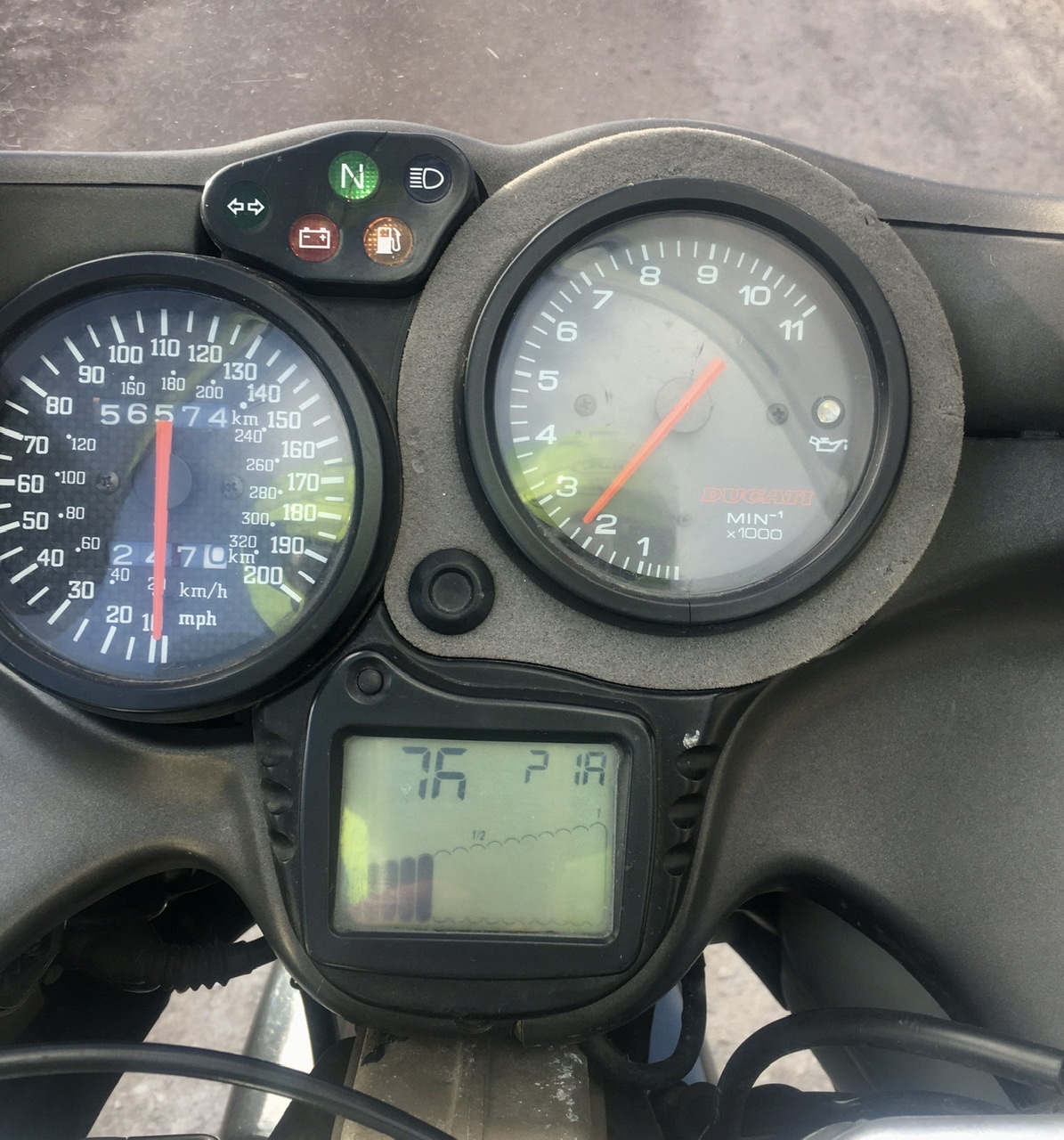

  16. Hi...I have just purchased a new to me 2002 ST4 with exactly the same clocks ...and exactly the same issue ! ( speedo accurate in mph...odometer and trip meter recording in kms )
    Any further updates on this ?

  17. My speedo and tach are the same I should have said

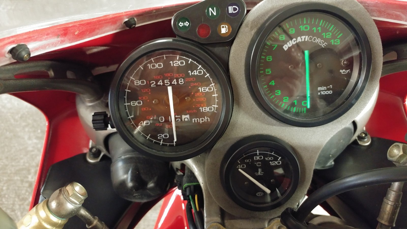

    99MY ST2 clocks
    UK bike originally. Speedo indicates mph and kmph but odometer records KM; see the Km indicator to the right of the total distance covered. I’ve only had this bike 2 weeks but can confirm that on the road it’s Km travelled being recorded.
  20. Thats very interesting...Thanks Paul. Mine goes to 180mph in 20mph increments and is as per the one shown by Biggins in the original post on this thread.Its definitely recording distance in kms though as a point I know to be 10 miles away showed as 16....seems theres quite a variety of speedos out there !!
