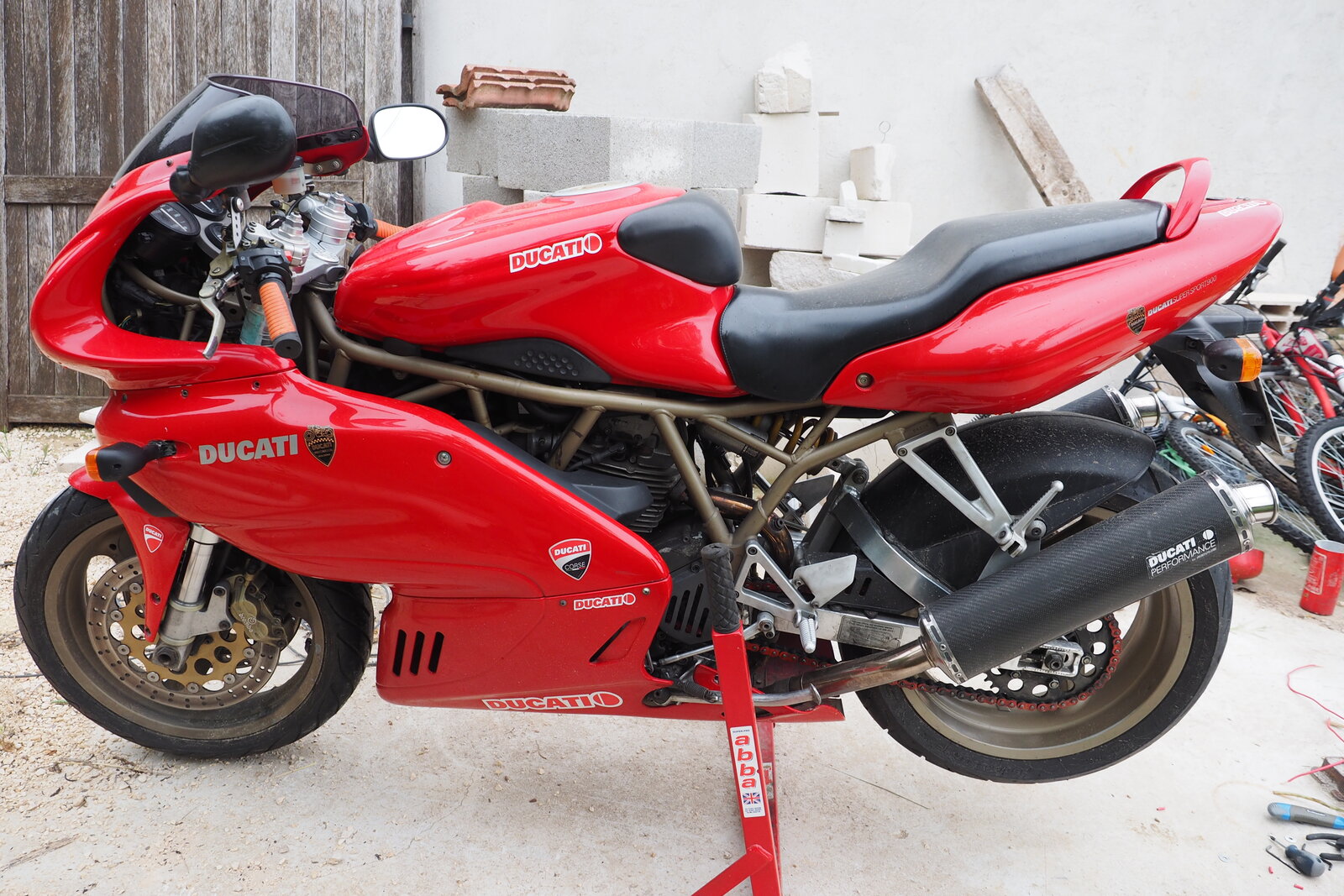

    I currently own a 1997 900ss in Superlight guise that has been very well used for the last 10 years or so.. and a year or two back I also purchased a 06 999..two very engaging bikes. The 999 is (in my eyes) too much for the roads..I do however use almost all of the 900's performance in the hills (I live in the South of France near some amazing roads), it however needs a tiny bit more puff, but the lightweight and character are a joy.

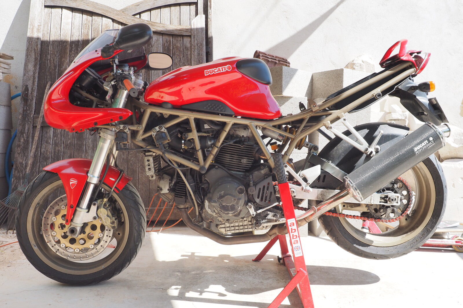

  3. ...back home didn't look at the bike for a week. Stripped fairings and tried to be objective...(tricky!) It was a bugger even starting it as my carb battery is a different size... Got it running without fairings in place and tried to diagnose.
    ..look at that...The previous owner had assembled the exhaust bushes that fit inside the exhaust clamp to the heads back to front.. I could pull the exhaust pipes about an inch off the heads! Corrected and fired up.. and we have now doubled the value of the bike (still a dog though) At this point my well reasoned.. rational brain kicked in..sell it now!!

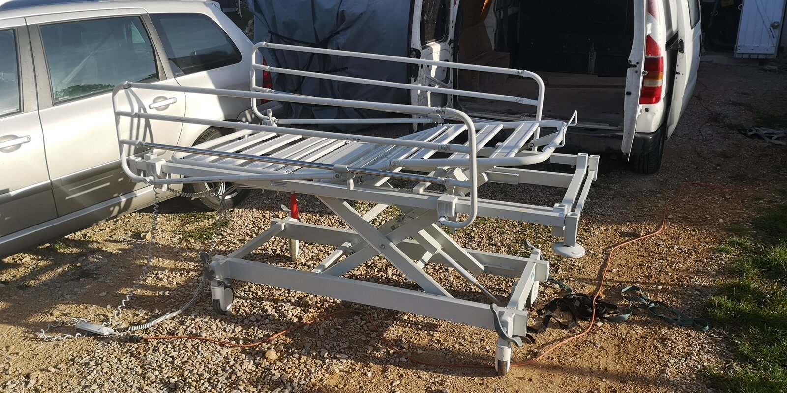

  4. Tools..hmm..you can never have too many.

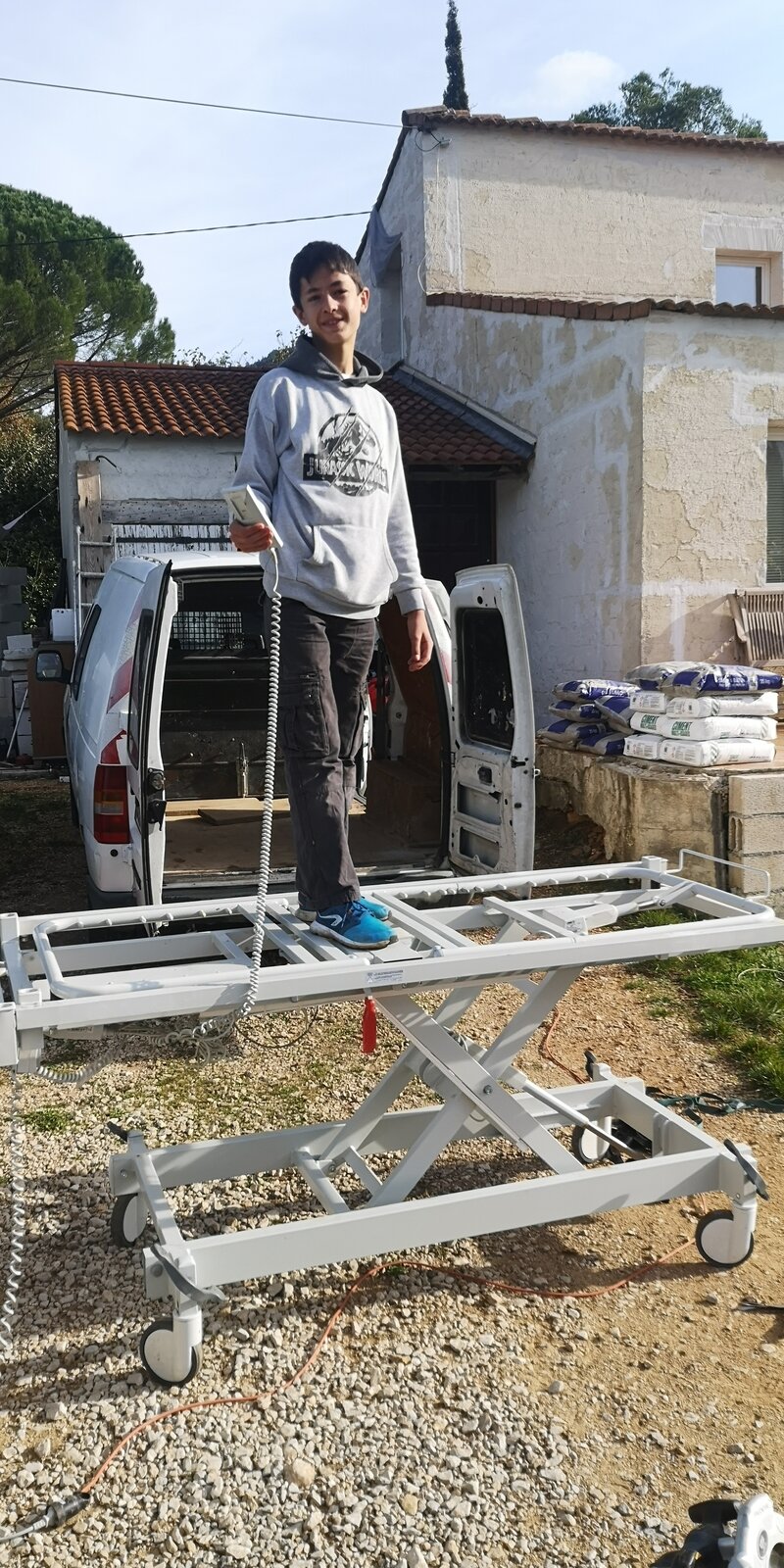

    So...managed to find this for a measly 100E:
    no..it's not for sleeping on the job!
  5. Early testing was encouraging:
    PS: I've been building the house in the background for +8 years..so if this project peters out you'll know the reason!

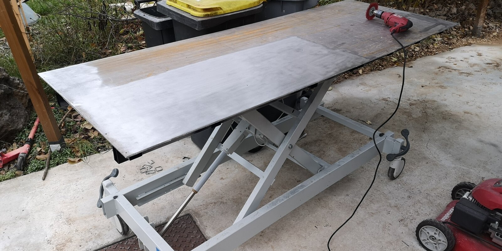

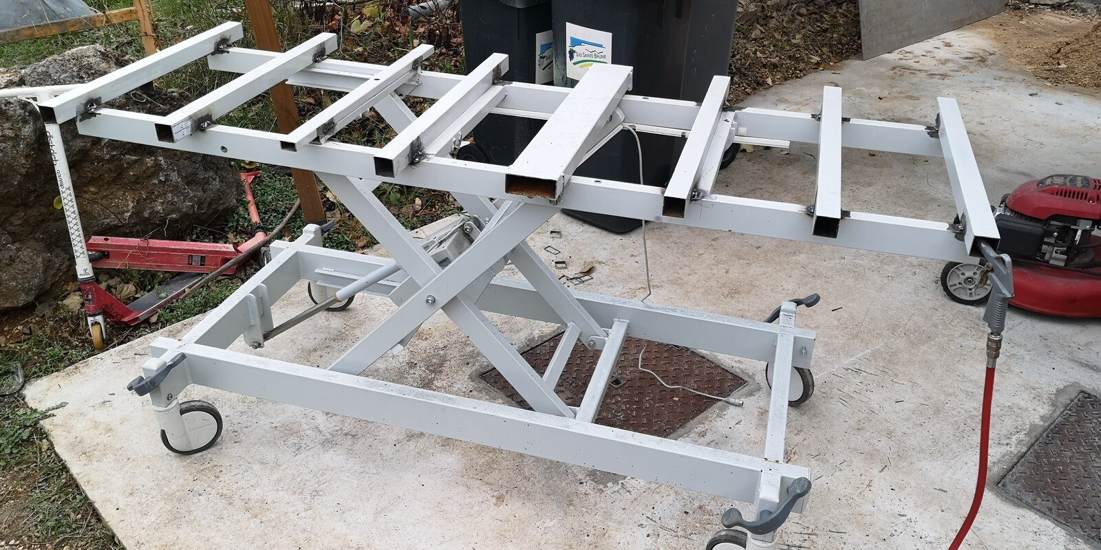

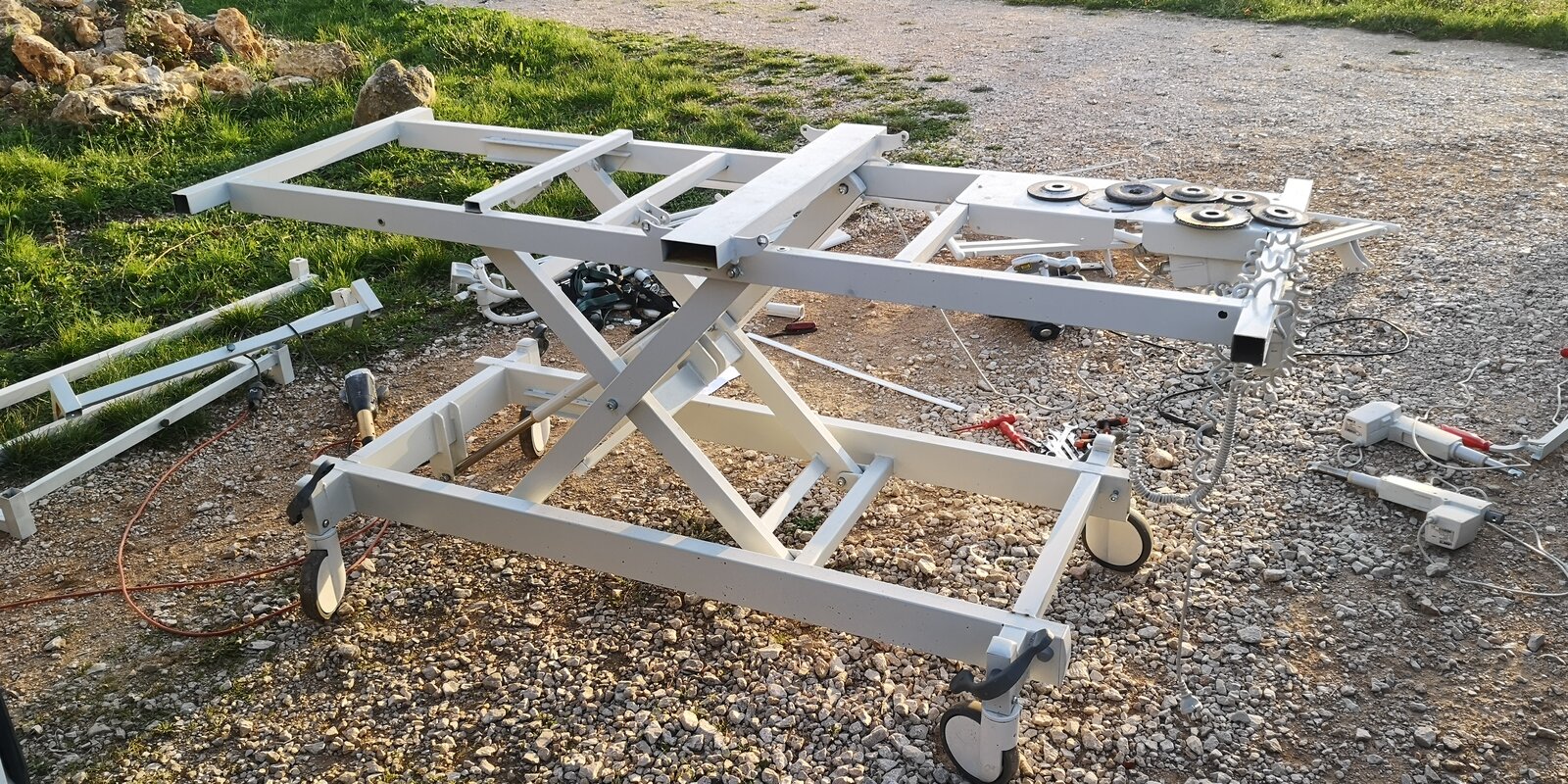

    Attacked with a cutting grinder... gives you this:
    • Like Like x 7
  6. welded up gives you this...
    One of the things about learning..hmm arc welding... what a **** I only blew holes through maybe six times.. but I checked that the welds ended up solid, and they are invisible in the end! I'm on the hunt for a mig and/or tig welder! (more of that to come for sure!)
    #6 The Royal Maharaja, Nov 27, 2020
  7. Managed to source an old plate of 5mm alu for 50E..bargain!
    had to polish it (a bit)...

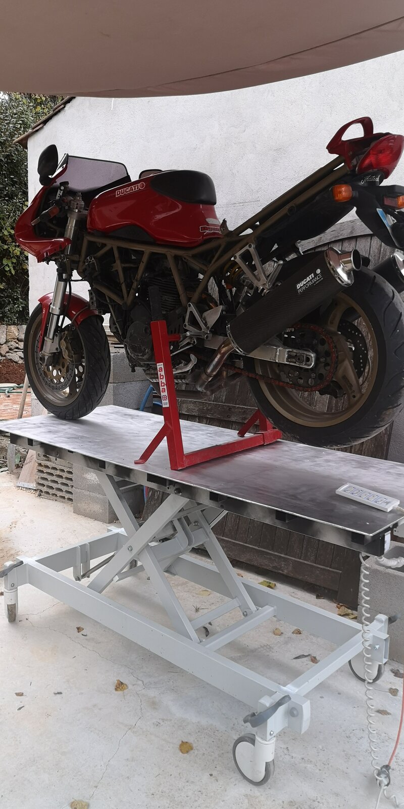

    fixed with rivets and relocated the power box and remote control...and..

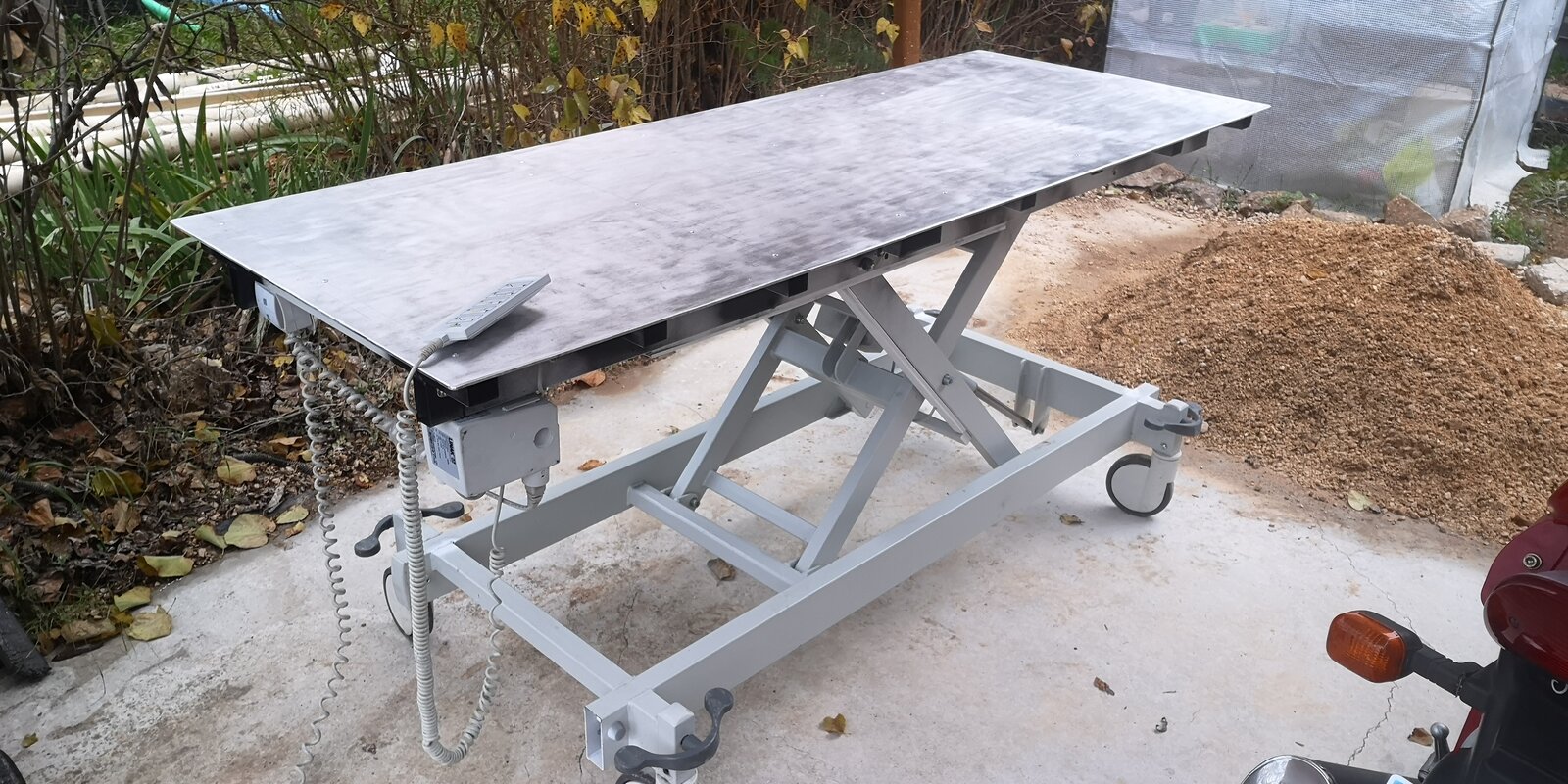

  8. Great. Love this thread already with the alternative hydraulic workbench
  9. We have a electric motorcycle lift (rated to 200kg..but tested by having the whole family on it..262kg) ..150E plus about 6 hours stolen in lunch breaks, evenings and one afternoon of the weekend. Whoohoo!
    Going up!
    If you decide to do the same, a few things:
    There is enough metal tubing spare in the structure of the bed framework that you don't need to purchase any more, it's just a case of cutting and welding. The lowered height is a tiny bit too high.. I was using a ramp to get the bike on. I see that I can purchase decent locking wheels for about 20E for four (second hand), that have a much smaller diameter..I may fit these in time. With the current setup the bike will be on the lift for a while so once it's on there, no issues. Currently the grey foot brakes are connected, so one closing motion blocks all four wheels. Nice!
    Catch you later

  10. Good stuff..in time I may really need your motivation! Cheers ;)
  11. brilliant job :grinning:
  12. Do you know the innovations of changing items to something else amazes me to what can be done :)
  13. Lift looks great, I would look at some clamps to secure the ABBA stand though.
  14. Good advice..thanks.

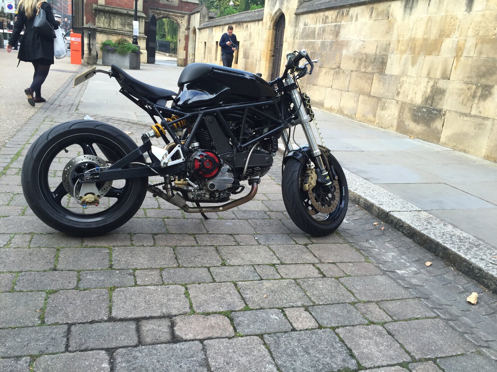

  15. Great stuff! I'm quite interested in building a supersport custom but I'm definitly not cutting up my carby so I'm looking forward to the next installment.
  16. Good luck with the project.

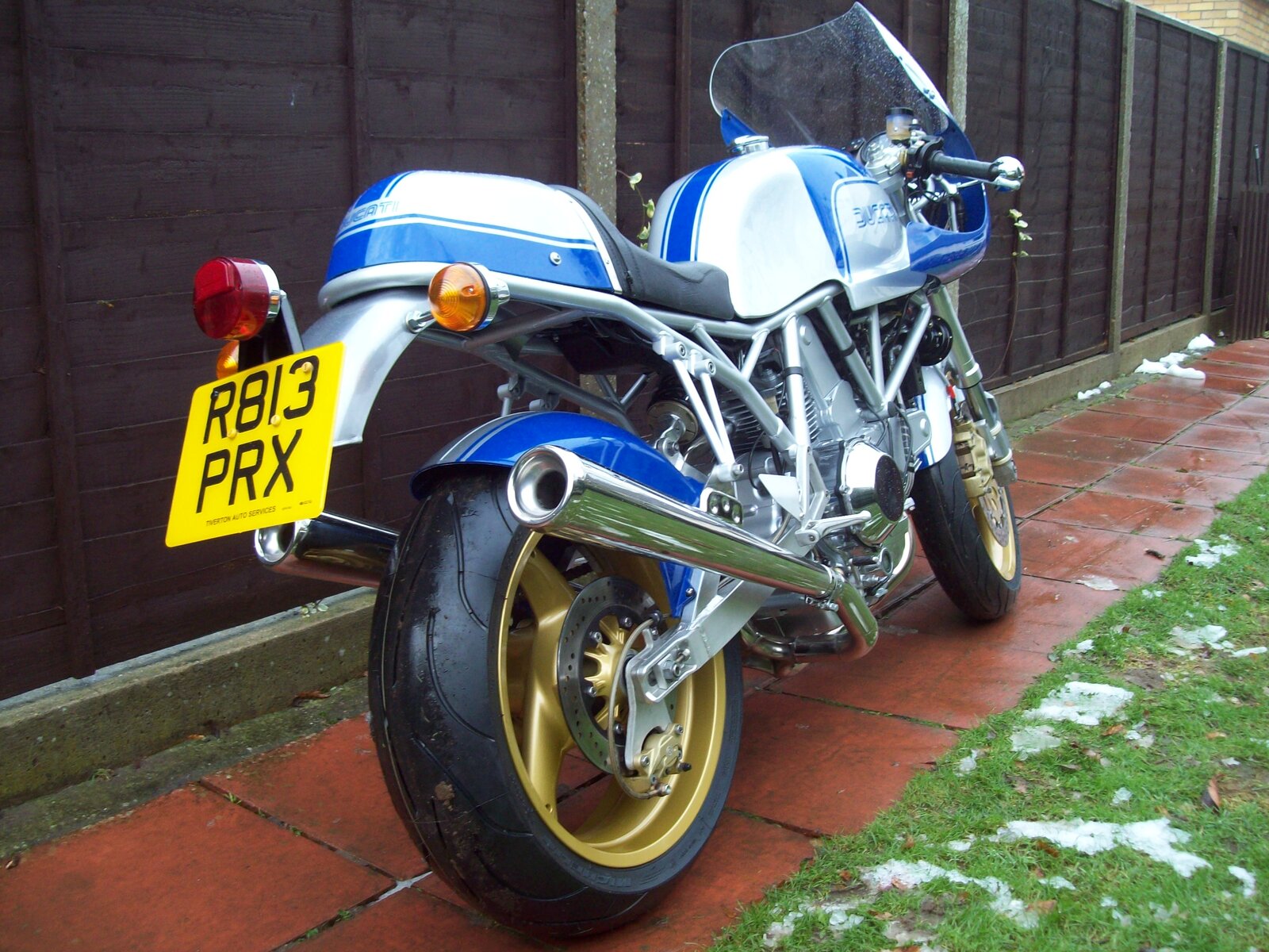

    I butchered a couple of 900ssie's myself a few years ago.
    • Like Like x 17
  17. Super looking bikers. Well done :upyeah:
  18. Now that's what I would call proper mangling!!:p
