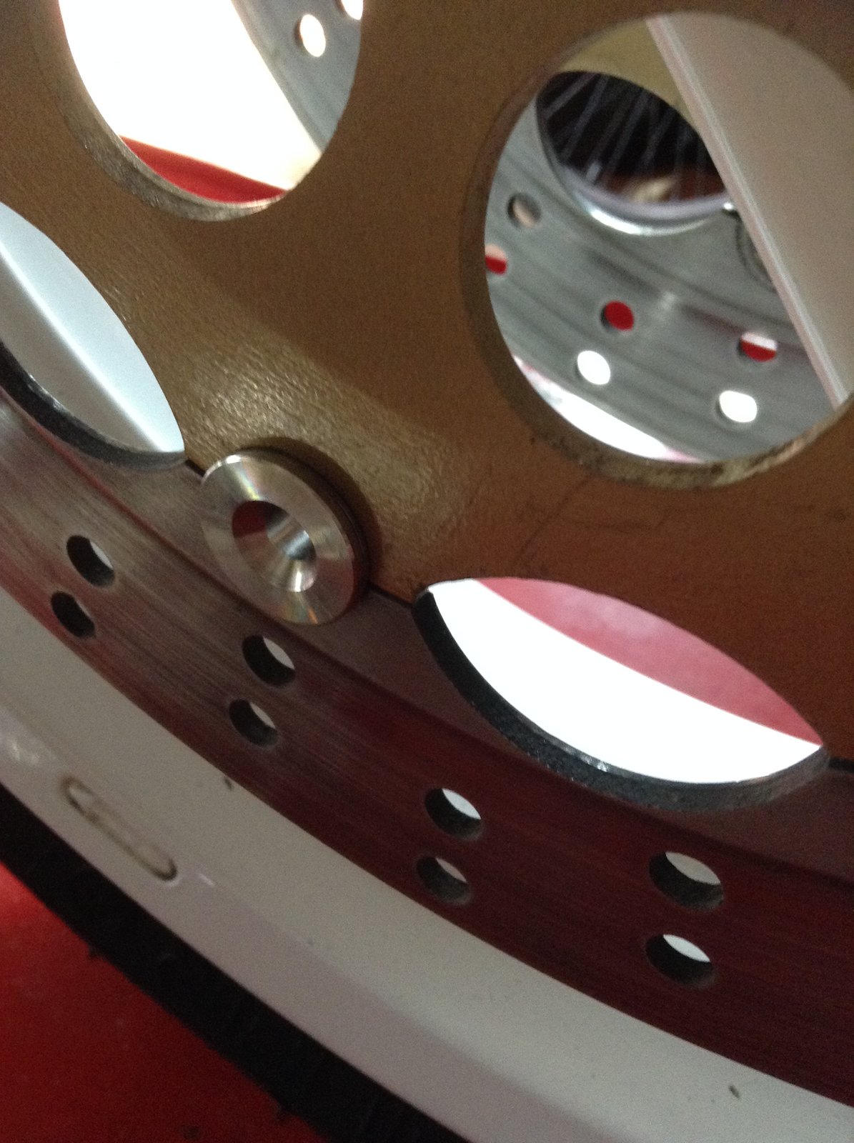

  15. image.jpg These could be ok
  16. I thought that it was the alloy carrier that the bobbins wear, more than the disc. The discs may be ok but the carriers knackered..
  17. Yes spoken to them about the issue, they cannot repair them.
