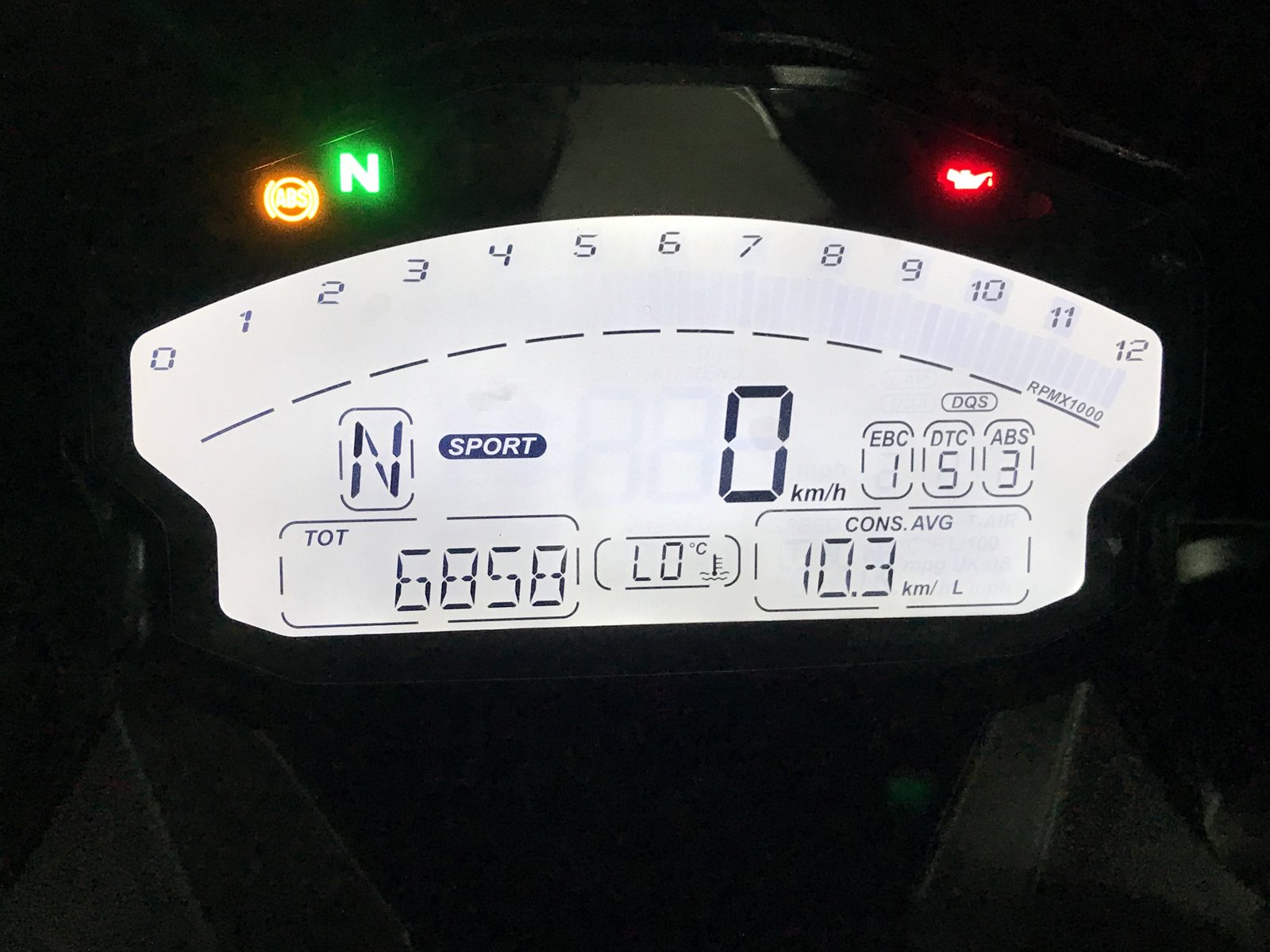

  3. Ohhh, I didn't know it could be enabled or disabled... I'll do that first thing when I get home, thank you! Any idea which menu I should look under?
    Pic for reference... Is the DQS on or off?
    #3 psych0hans, Feb 20, 2018
  4. Pretty sure that the DQS on the dash indicates that it is switched on... As mentioned above, what you're describing doesn't sound right. So you may have an issue :confused:
    Edit to add: does the DQS remain on the dash once the bike is running? It is reasonably easy to navigate the menu to check if it is turned on... Maybe cycle it off/on while your out for your next run and then try it again??

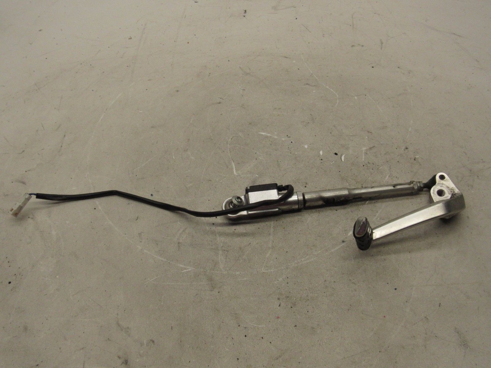

    If you do have an issue it could be the sensor by the gear change leaver that is U/S? @nelly may be able to offer some guidance too?
  5. Im about to take my 899 to the dealer within the next couple of hours. Normally I have DQS switched off for Sport and Race (its doesnt show DQS on the dash) but Ill switch it on and let you know what happens
  6. as Ben said - "DQS" displayed tag on dashboard means that it is enabled. If the throttle isn't dying down when you put 'upchanging' pressure on the gearshifter then something isn't right and needs investigation. Plugged in ok etc?
  7. Hi guys, the DQS was definitely on, will need to have it checked out. It’s been on the diagnostic tool a couple of times, but nothing came up. Might need to call the SVC tomorrow and make some enquiries. Thanks for all the answers guys! Y’all rock! :kissing_heart:

  8. Just to finish up, with DQS on and displayed on the dash I was able to change up without going anywhere near the clutch

    Has the shift rod length been messed around with?
    Have you adjusted lever position at all?
    Is the harness under the seat clean and plugged in correctly?
    Also try cleaning shifter sensor and spraying some penetrant oil into the part of the sensor that moves and work the lever up and down. If shit gets in they can play up.
