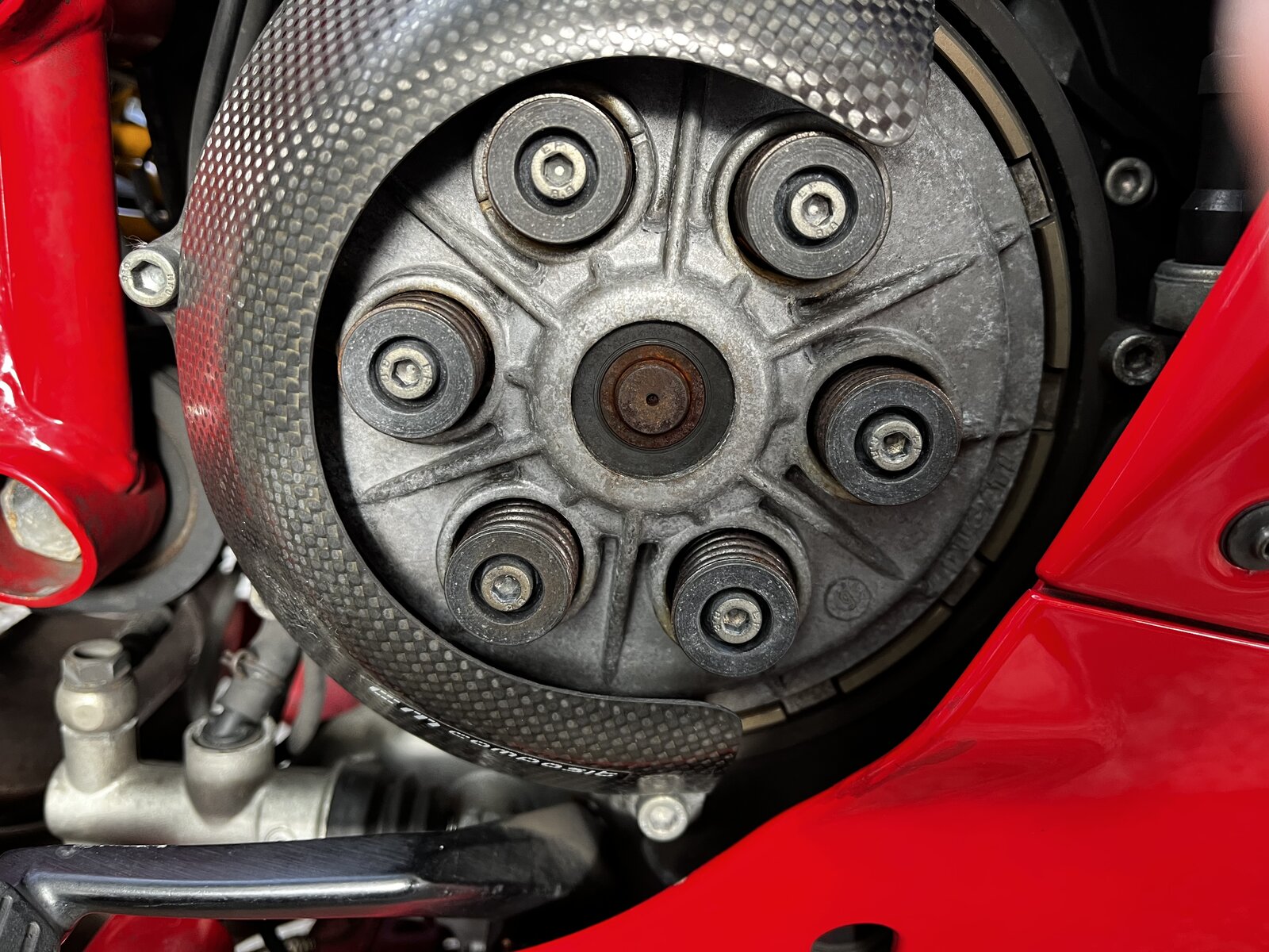

  1. Hello, is this a dry clutch. Just wondering if you can tell from the pictures? Thanks in advance.
  2. Yes
  3. Yes most definitely
  4. Thank you, and is it a slipper clutch?
    • Disagree Disagree x 1
  5. Driza-Bone.. ;-).. until you start riding in the rain.
  6. You need to take the pressure plate off to tell if it's a slipper.
    What bike is it?
  7. Looks completely standard.
  8. ...and you really should get a better cover for it.

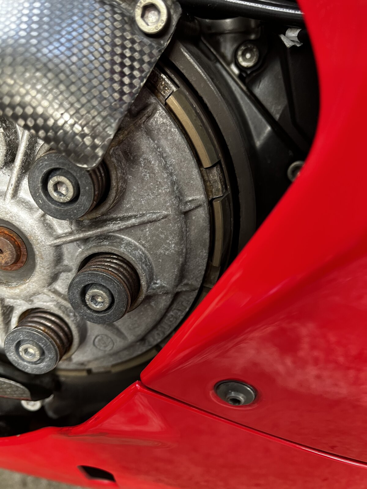

  9. does look standard, I would think of changing the spigot bearing in the middle, or at least check it's not binding. This isn't that bad a job, and documented on here and YouTube. On the plus side, it looks like you have a virtually new basket (gold bit) showing zero wear. :upyeah:
    if this was mine then would treat to 1/4 of a can of GT85* as bound to be corrosion on plain clutch plates and oil within* is light enough that it will help not hinder the mechanical clutch action.
  10. If it wasn't a dry clutch, those plates would be bathed in oil (hence a 'wet' clutch) and there would need to be a closed cover over it to prevent that oil spraying everywhere.
    I believe dry clutches are used in racing as it's just easier and faster change a dry clutch than a wet one.
    They also sound terrific ;)
  11. It's dry now but, by the looks of it, it hasn't always been so...
