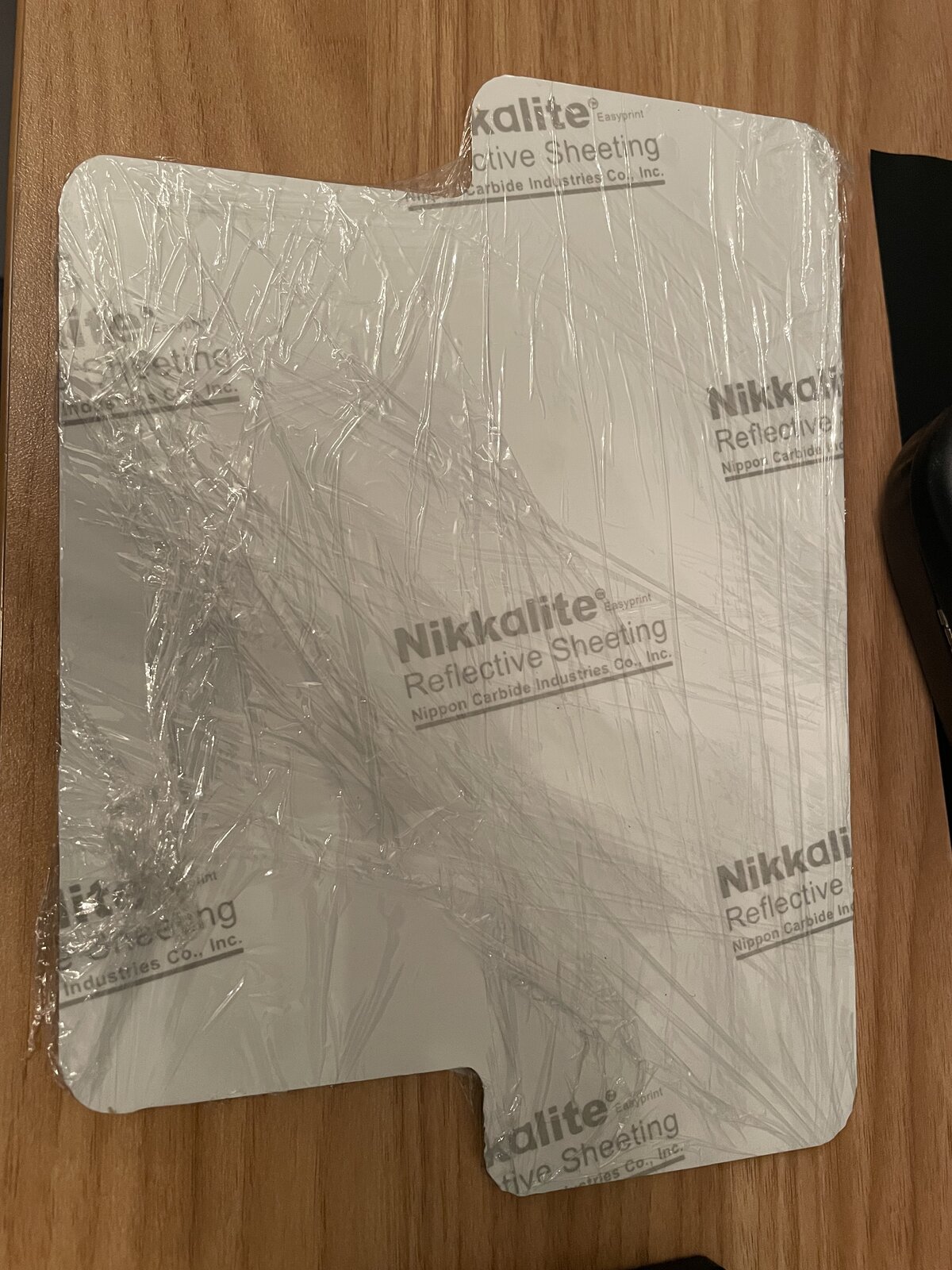

I bought a number plate from a company called JDM. I selected the profiled option expecting it to be something else. I’ve been sent a weird shaped number plate. Is this really legal? Also my plate was sent without holes drilled in it. Has anyone else used them? Is this normal? I’m not really comfortable doing it myself!
The plates must - in order to be legal, be marked to show who supplied the number plate be marked with a British Standard number - this is ‘BS AU 145e’ for plates fitted after 1 September 2021 Spacing requirements are: https://www.gov.uk/government/publications/vehicle-registration-numbers-and-number-plates You could be fined up to £1,000 and your vehicle will allegedly fail its MOT test if you drive with incorrectly displayed number plates. BTW, on one of my cars the plates don't conform to any of the rules and I've never had a problem in 8 years. They are stuck in place with double sided foam pads - no drilling required. Though TBF they are the typical shape which yours appear not to be?
It’s for my motorbike. There’s nothing to stick it to. i know the spacing is legal and it has the manufacturers details printed on it. I’m concerned about the weird shape though.
I've had a few small as possible type plates from them, but not with that type of shape, I prefer the more standard look. Shape is legal as all measurements are correct, shape is personal taste. They can't come pre drilled as all tail tidies, plate holders are different. Holes are easy to drill, I just hold the plates up to holder and use a pen to mark the holes, then carefully drill, I use a small pilot from the back to front then go from the lettering side to the back with the correct size drill bit, 5 or 6mm I think. If fussy, match the the holding bolts to lettering, eg black on black.
Thanks very much. I wish I hadn’t gone for this shape (which I did by mistake). I’m worried it might draw attention from the police who might then take a closer look at my exhaust
So long as the distances between the characters, the distance between the 2 lines and the distance between the character and the edge of the plate, meets the requirement, the shape of the plate isn’t mandated. Andy

Just read the regs and there is nothing in them about plate shape. As long as all the other regs have been complied with the plate appears legal.

The Shape won't matter, as long as the letters are equally space and readable, don't need bs numbers either.

My experience is that if the letters are the legal size and font, plod won't give a toss about the shape of the plate; any interest you generate will be caused by the Death Star Termis on their own.
