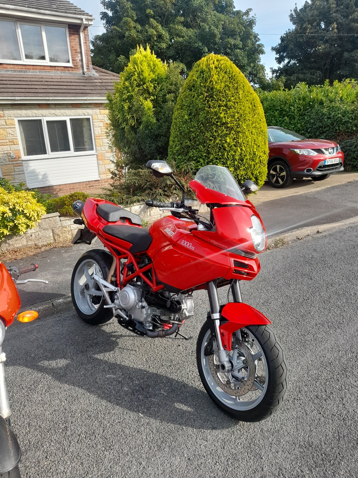

    • Like Like x 12
  12. You've made a nice job of that pal, looks fantastic.
  13. As others have said you've done a fine fine job there. It's always heartening to see tired & forgotten bikes given some care and attention and brought back to life.
    And although more expensive in time & hassle it's financially cheaper than buying a new or a pristine example plus infinitely more personally rewarding
  14. Great job pal. Looks fab.
