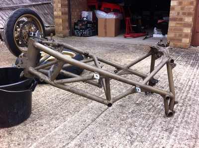

    SO I have just become the owner of a 2000 748S frame
    so what am I here for? information build threads and inspiration basically... this isn't going to be a quick build but will keep me busy over winter, with the plan to use the bike next year

  13. So why not write a wish list of what your build is going to be........though with that age and type of frame you have made extra work for yourself allready.......if you want a proper later type engine!
  14. Good idea but why have i created work for myself?
    i like the look of the 748, engine wise... thats where i need to do my homework... making things and fabrication isn't an issue as it's what i do on a daily basis and as a time served TIG welder I don't see anything being an issue.
    My challenge is to build the bike with parts only sourced from Ebay, nothing else... no dealer, no swaps... nothing but parts from Ebay, with a budget of £2000 for the parts. Refinishing and making look new is an unlimited budget as I would do that even if i bought a complete bike.
    I want the 748 to look standard but not necessarily in standard colours.
    Red frame, red wheels and black bodywork is the main idea.
    I like the idea of the single seat but I need to learn the spec of this bike so I get the correct bits
  15. Sneakily taken from the Ebay sale.
    HPi clear and V5 present...
    very happy for the money, especially as what others have been going for

  16. so what engine....
  17. Can the frame be converted to R spec?
    engine wise? no idea at present, still in the learning stage. Think of me as a kid in a sweet shop lol
  18. OK
    So most modern most power = 1200cc 1198= circa 3000-5000 pounds if you can find one
    next 1098cc 1098 = circa 2000-5000 pounds more available
    both of these require an airbox being made
    next a 998cc 999 = loads available, 2000 pounds would get you a singing and dancing engine circa 130-150 hp
    plus all the std bits are available to fit with minimal fabrication particularly around the airbox but would obviously go straight into a 748R frame:wink:
