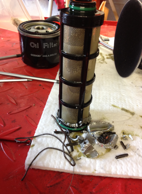

  1. Had a great trackday at Donington yesterday but had a couple of ham fisted missed gears. And the horrible mechanical violence noises that come with them. I decided to change the oil today and have a butchers at the magnetic sump plug whilst I was at it. The plug felt dubiously tight as I removed it. After cracking it loose its usually finger tight to remove.
    I also noticed my oil level was down so I whipped out the strainer that shields the oil feed suction. And this is what I found..... Whaddaya reckon?? Knackered transmission or engine... Or both. Eeek. 1098R.png

  4. Looks more like an oil control ring and some lands there!!

  8. I take it it got over revved then by looking at the debris!!

  12. What are those curley springy things?? They look and feel like lathe turnings..
  13. Oil control rings
  14. Definitely bits of oil control ring and piston ring. I can't tell from the picture what the alloy parts are, piston? Either way it needs a full strip!

  18. Whatever you do don't try to fire it back up again! :Wideyed:
