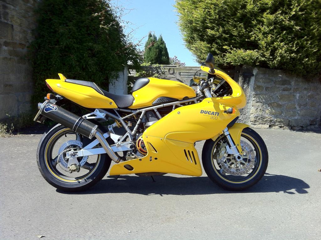

  16. Thanks a lot for all the advice everyone - for sure I WILL NEVER USE THE JET WASH AGAIN!!!!!!
    The bike is out in the sun for a bit now Chris :upyeah:
    Cheers !!

  17. Ah, well as I suspected from your name.................The yellow one's have much worse electrics than the red ones.............
  18. Ohh that's HARSH......and you have been so helpfull :wink::biggrin:, cheers though mate i appreciate all the help!!
