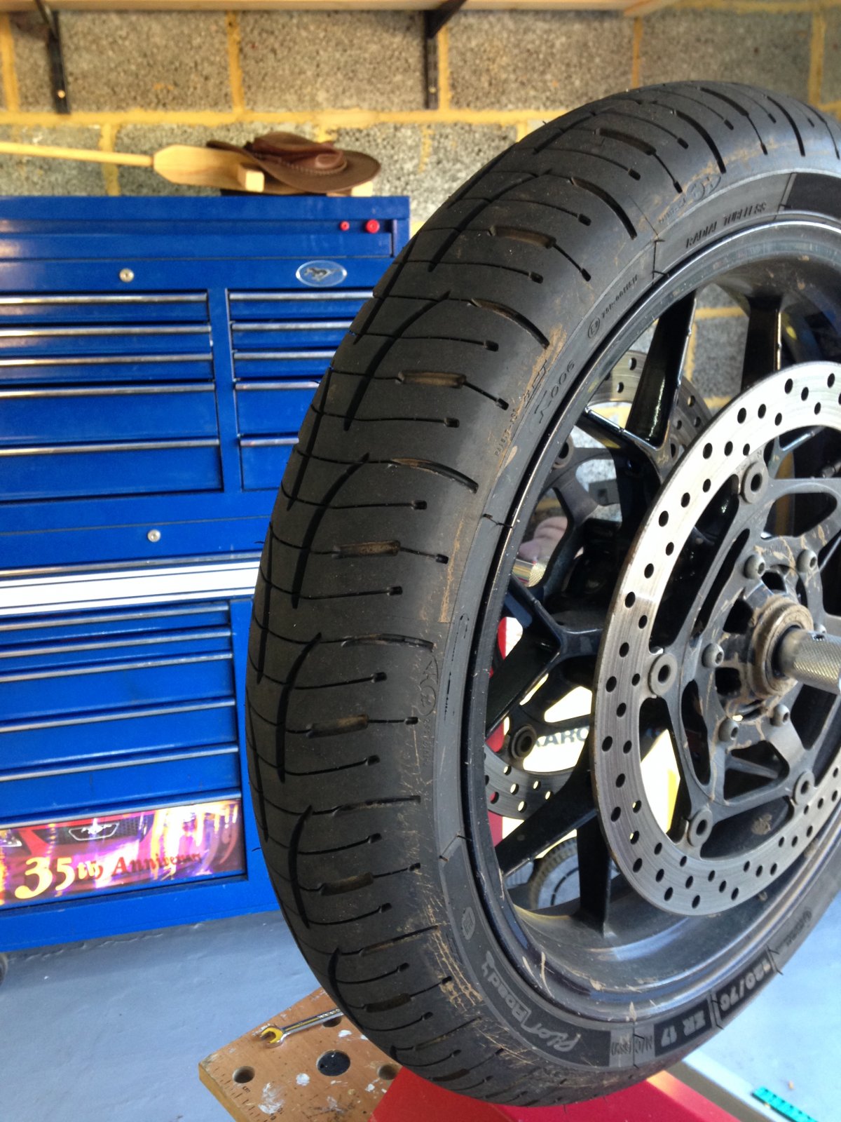

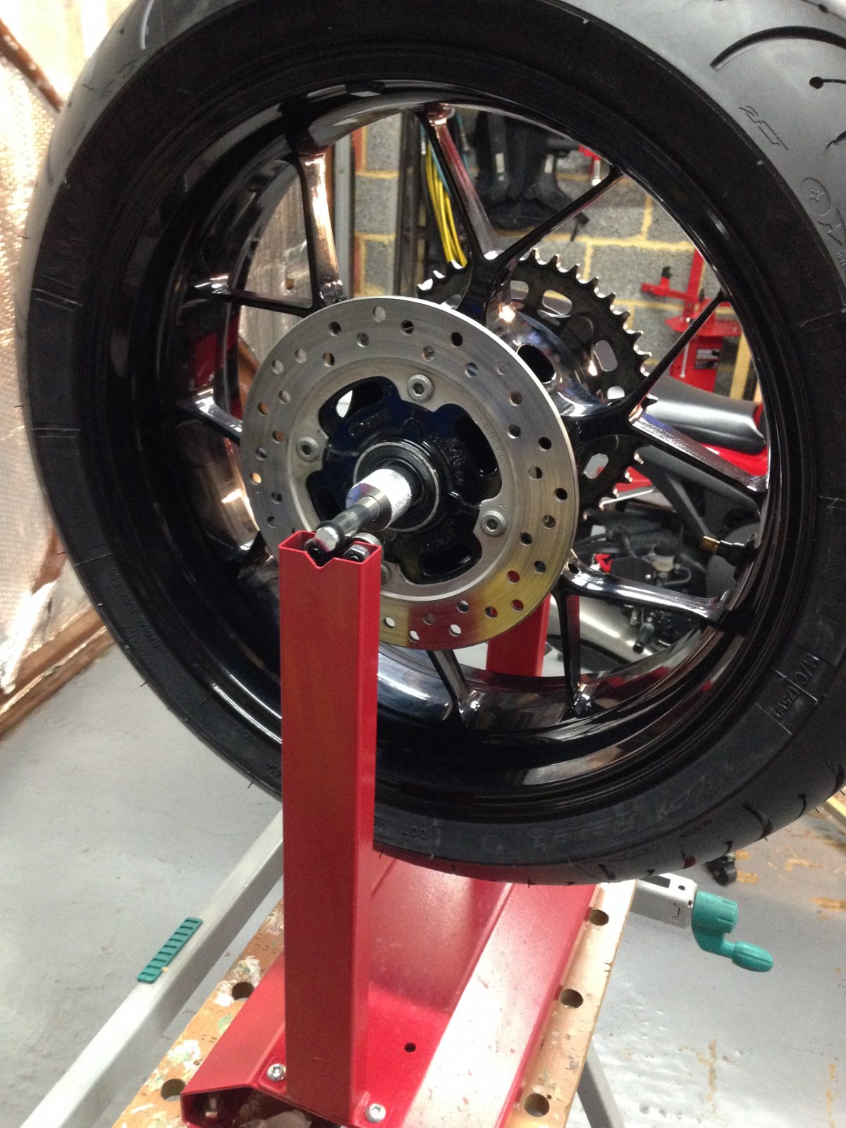

  1. No not with the new tyres but the tyre fitting places. When a took off my exixting Bridgesone S20R evo's I decided to static balance them to see how good those electronic wheel balancing machines are, well the machines might be state of the art but the people who use them are not. The front wheel was out of balance by 12.5 grams, not much I hear you say but my new tyre fitted only needed 10 grams to balance out rather than the 52.5 grams that was.
    The rear was checked next and hey... it also was out by 10 grams. So my conclusion is that tyre establishments only have their machines calibrated to +- 10 grams. Latest 013.JPG Latest 014.JPG

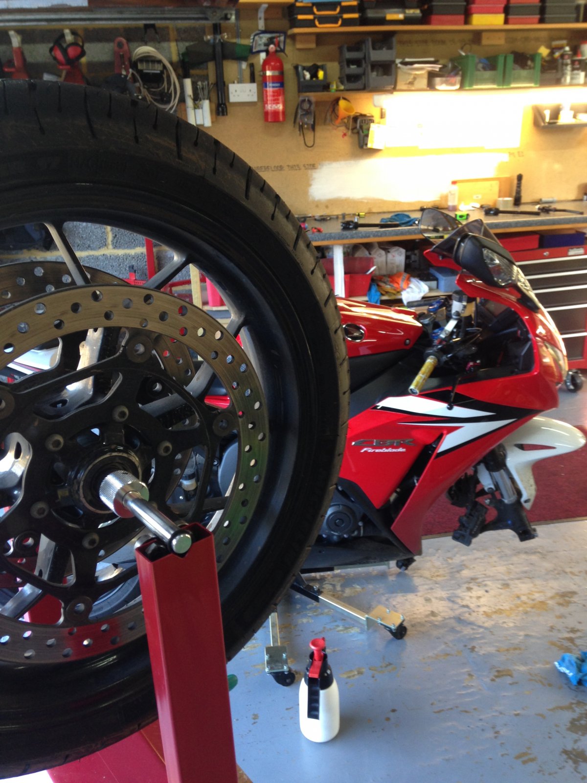

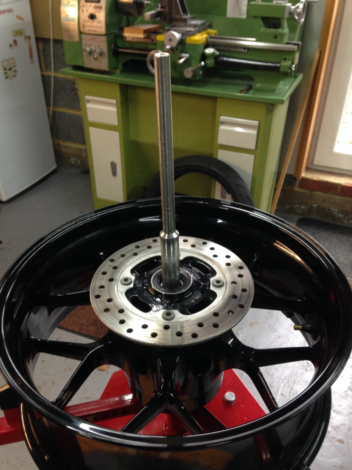

  14. Ok so I checked the front wheel after some 1300 miles to see if the balance had moved in any way. It had not, exactly the same as when I balanced it new.
    So my conclusion is they remain balanced, I will check again in a couple more thousand miles though.
