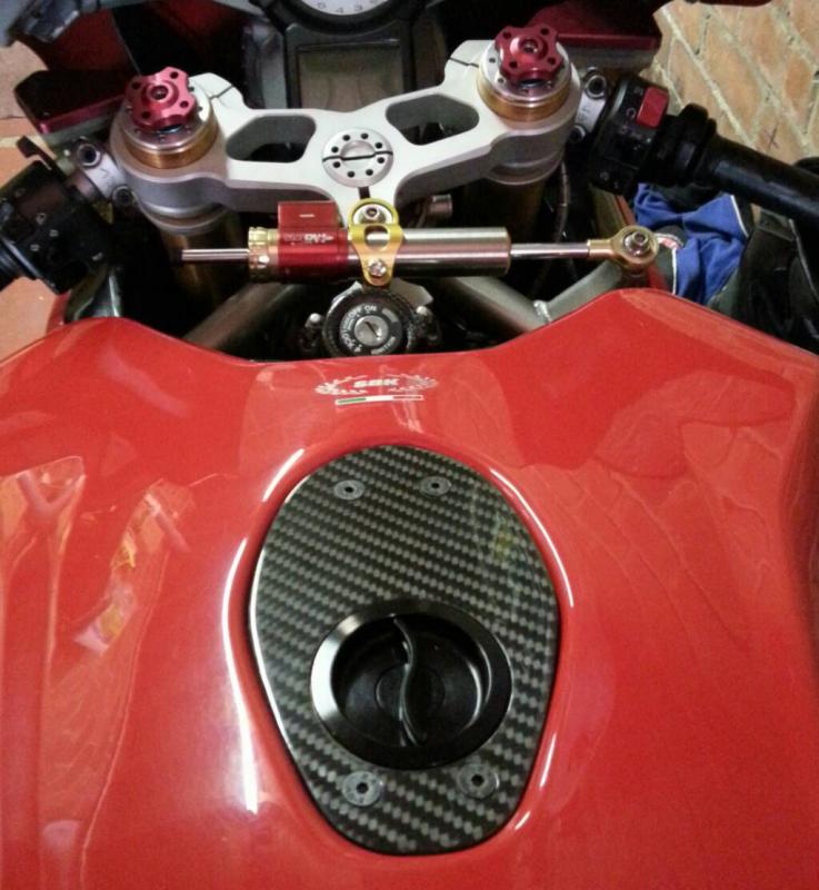

  13. Had mine on for 3 years and though having given me a few scares which required re-firing/closing the ignition, it has never totally failed (yet). I do carry an Allen key for it, but tried to remove it recently to repaint some damage and saw that you need to drop the tank panels off to get to the connections, so not great if it does totally fail! Kind of wish I had invested the 200 quid in one of those race type, no lock jobs instead now?
