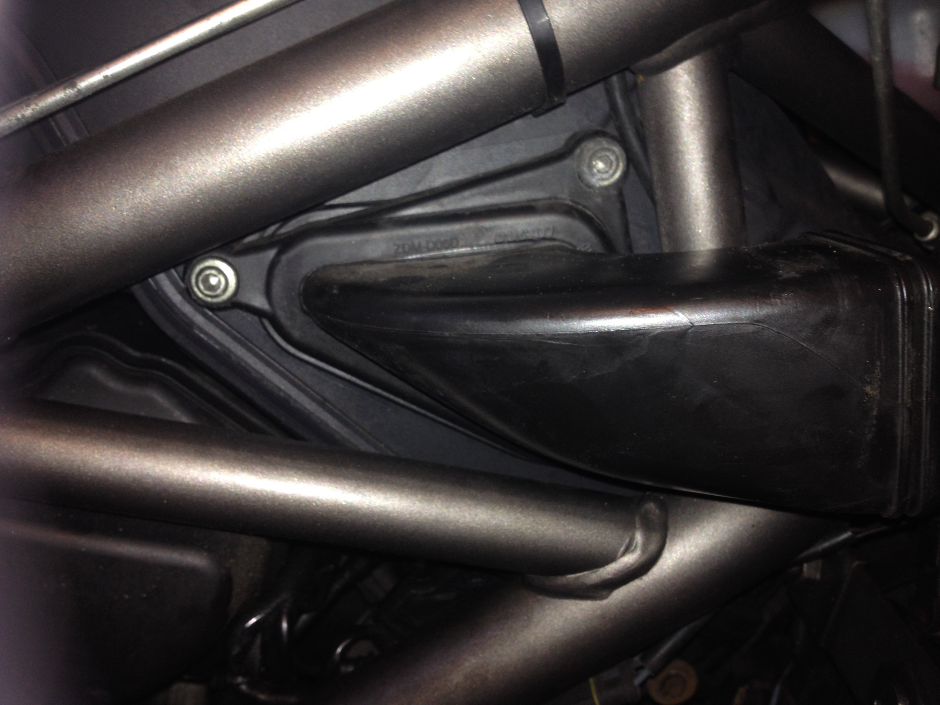

    noticed airfilter snorkel not flush, bottom screw gone, so ok lets remove 2 other screws for air filter and inspect...
    2 screws rotating freely !! inside boss gone ?ok lets take airbox off...another big job

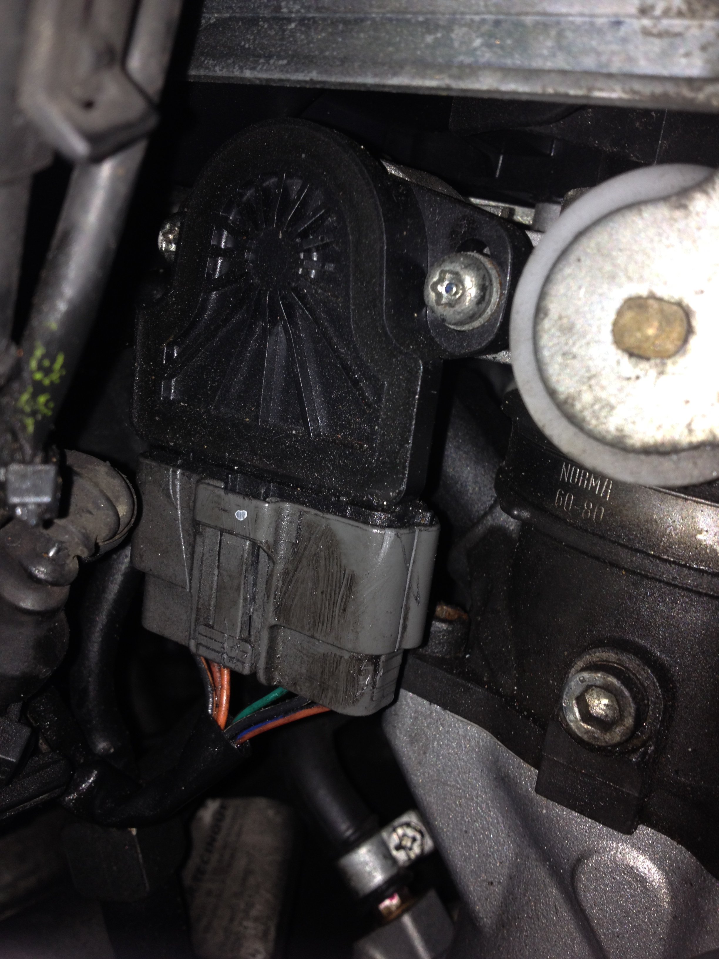

    and stuck again help ? - on the r/h and l/h tps on one side and apv connectors on the other side.
    whats the best way/how do these connectors work/come apart - any tips ?

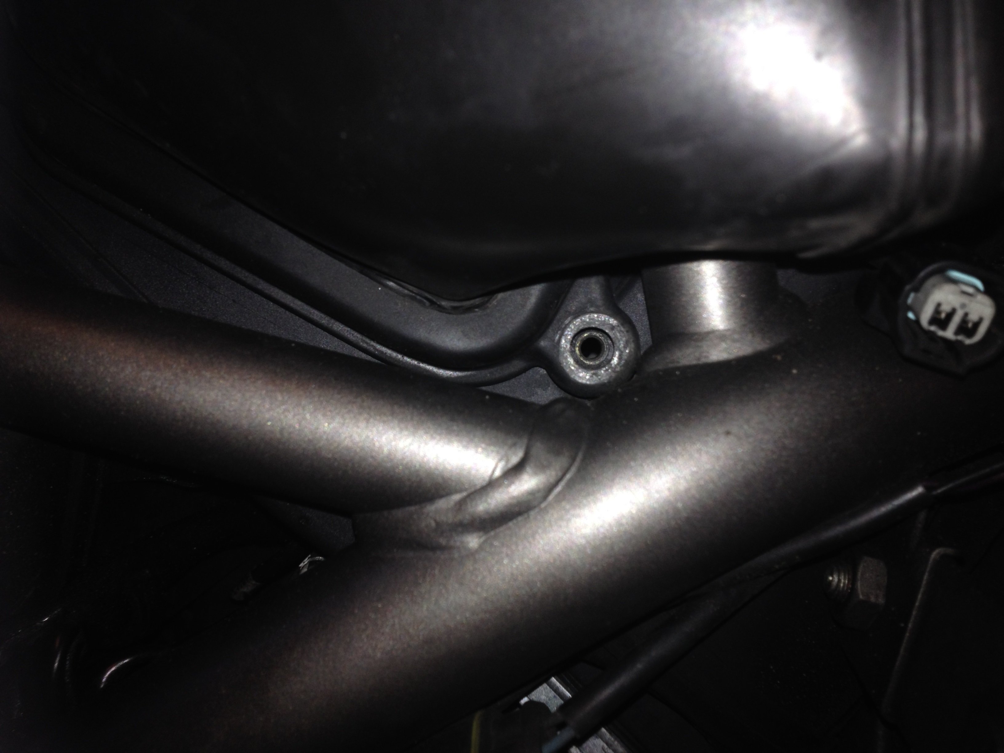

  7. pics of airbox intake - missing screw at bottom. this means the snorkel will 'lift' from airbox ... so there wont be a seal, other 2 screws rotate freely.
  8. So plan is try and remove airbox and try and get at the screws from inside.
    Here is a pic of the R/H connector that I am struggling a little as not sure how it comes apart ?
  9. Does it 'grip' at the bottom?
  10. Are you talking about disconnecting the grey electrical connector? If so, push the grey part up, then push in (towards the bike centre) the small rectangle part with the 2 lines at the centre bottom of the grey connector, then pull the grey connector down, they can sometimes be stubborn so a good wiggle can help. The small rectangle is connected to the vertical bar that goes under the bridge with the white dot, it has a hook that holds on a peg on the black part, you are trying to lift this hook off the peg by pushing the lined rectangle in. Hope I'm not teaching you how to suck eggs :Arghh:
