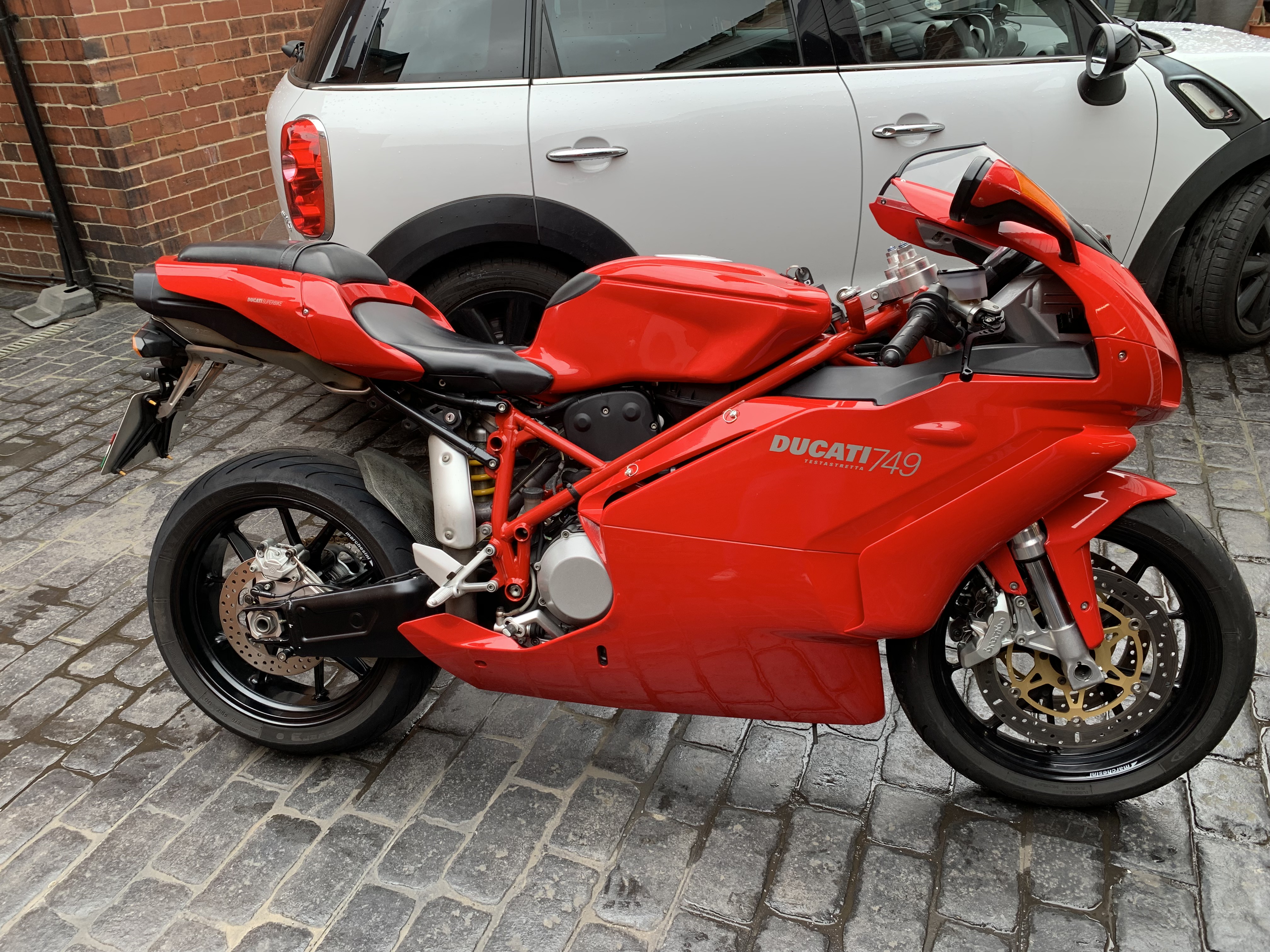

  1. ok, so i have pulled the trigger and got my first 749.I did everything wrong and it might bite me in the ass as i learn more about t he 749.in red 2006 with 18K on its back ,started on the button,temps ok,clutch seemed lound but went quieter when activated.couldnt test drive due to weather but the guy seemed ok.best done just under 2 years ago so on the list to do.
    So silly questions time,
    1) red paint code as some marks on plastics and frame
    2) black swing arm paint code as some minor chips
    3) engine silver paint code as lifted at the back near shock
    4)tyre pressures for road use
    5) any other things i should check for,with it being 2006 i was hoping some niggles would have been improved during manufacture
    6) pilot sport 3 tyres are they ok for normal road,i am not the best rider believe me,just want something thats safe
    7) regarding clutch noise ,i know its dry and can be noisy and its the cover on it as standard, but its louder than the 858 i checked yesterday,what could it be?

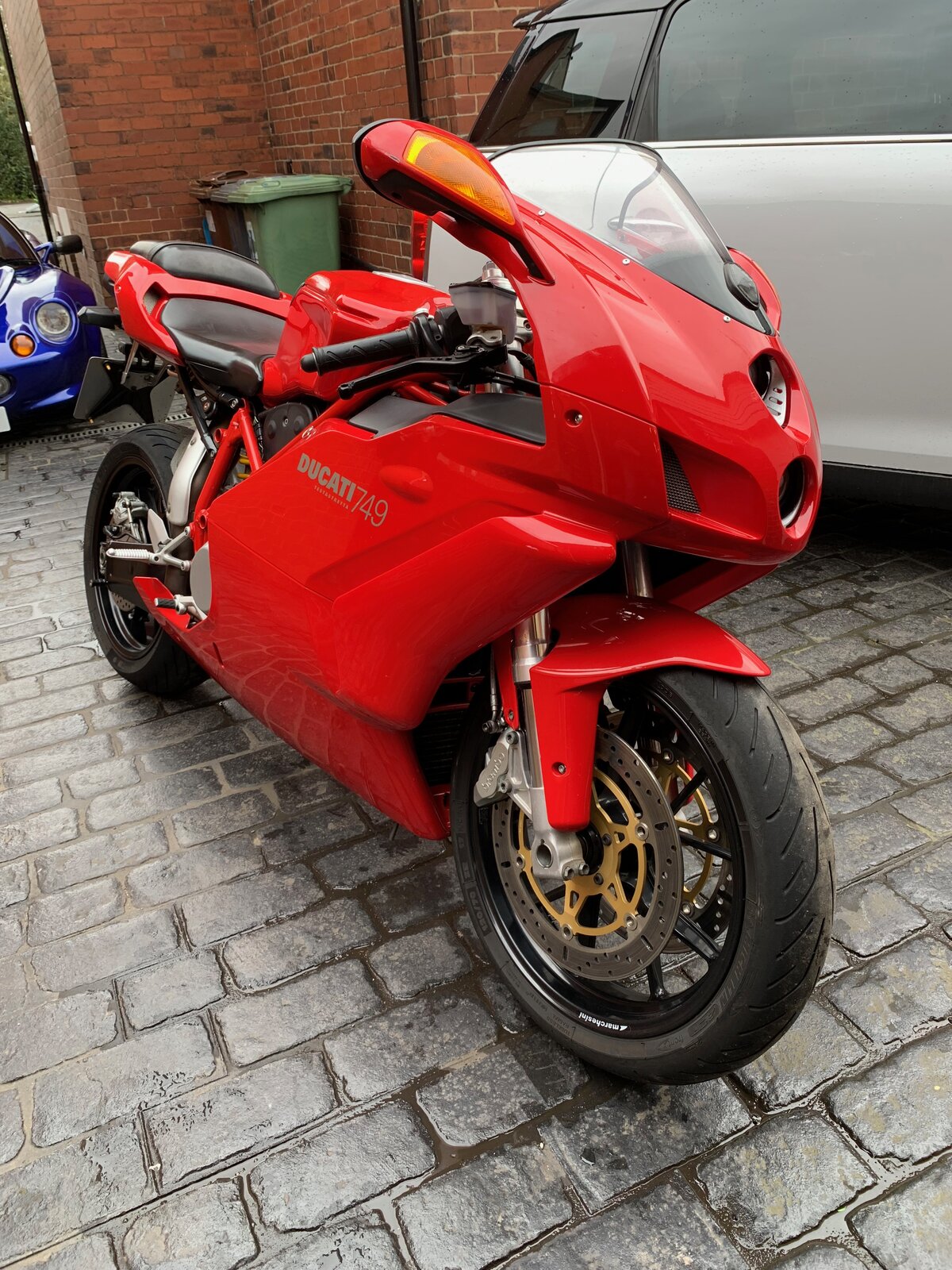

    pics of the girl,if you see anything wrong please let me know
  2. Nice one! Looks fairly tidy.
    2) Swingarm appears to be in pretty good nick paint wise
    3) Paint lifting on engine in that area is very typical
    4) 32f, 34r
    7) 848 has a wet clutch so not as noisy
    Brake discs don’t appear to be standard.
    #2 RickyX, Apr 1, 2024

  9. Nice! - does look tidy for that mileage, aftermarket Dzus fasteners on fairings but nothing wrong with that as long as they work propah.
