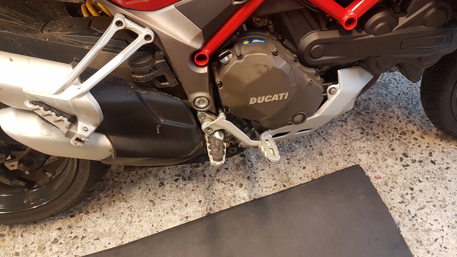

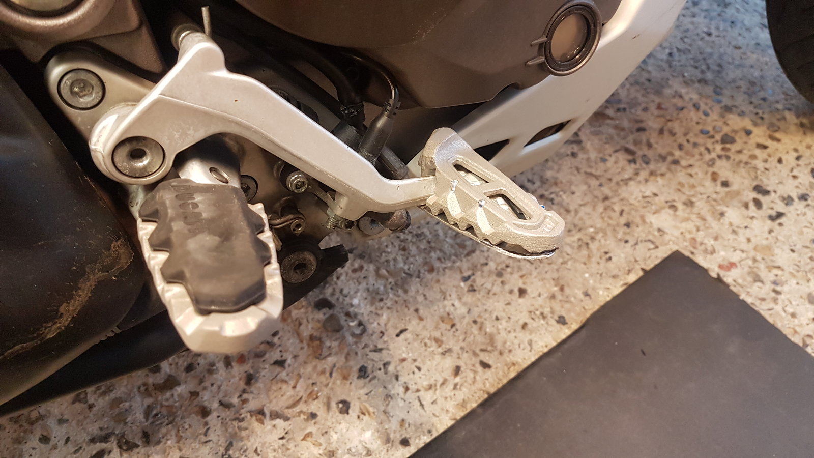

  6. I have just fitted the lever off of the enduro and its much better. Also can spin the foot around and make it higher

  11. Lever cost me £100 for the lever 45720961AA and 2 new orings 88641161A
    I forgot to get the bolt part no. 77240398C which holds the master cylinder push rod (used one i had).
    Its abit of a PIA job as fiddly but yes its a straight swap.
    I had to undo the push rod bolt to get everything on then tightend it up after the lever was on.
    Very pleased with the result

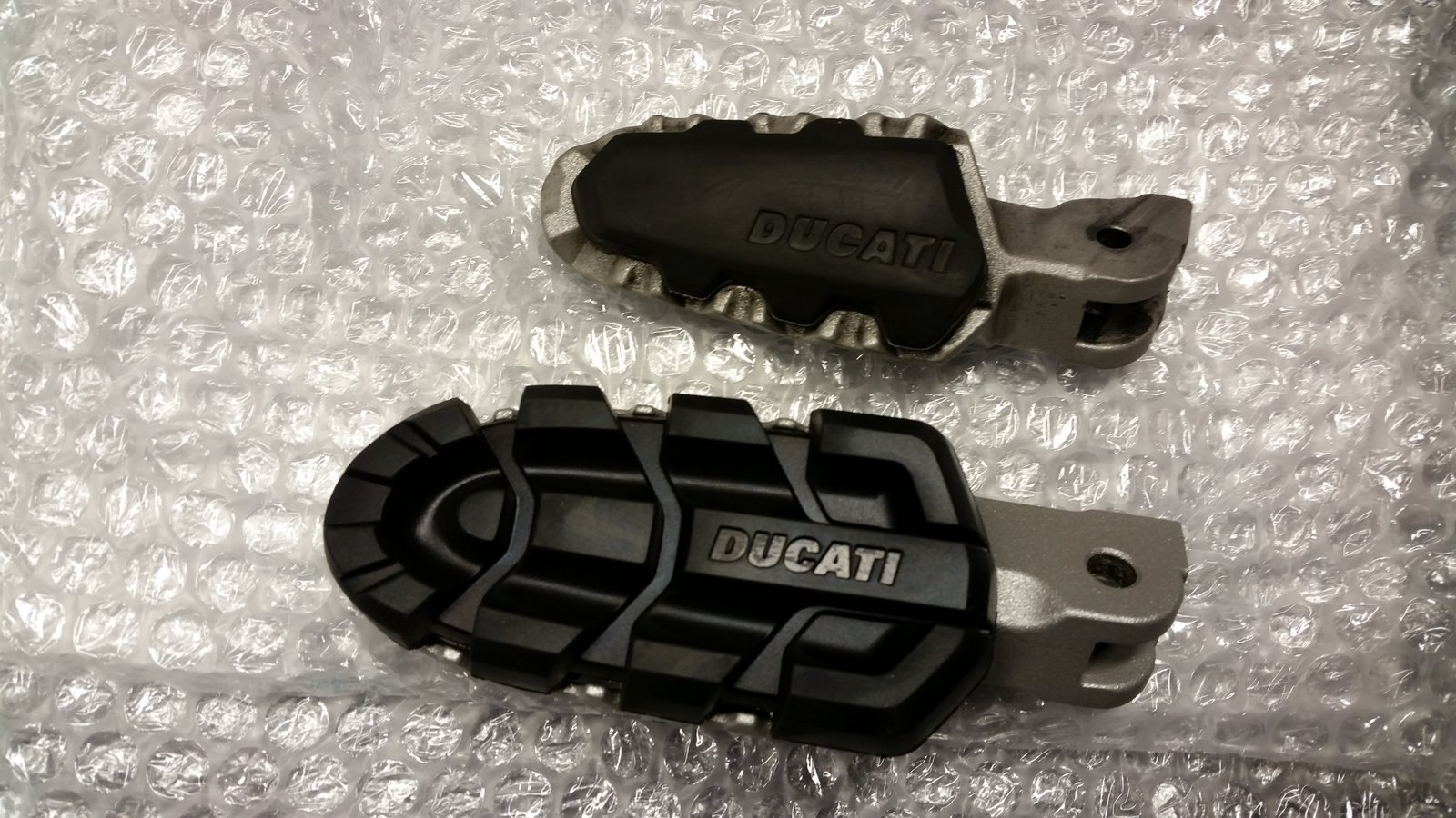

  12. The Enduro footrest is also bigger and more comfortable to use than the standard Multi footrest, in my opinion:

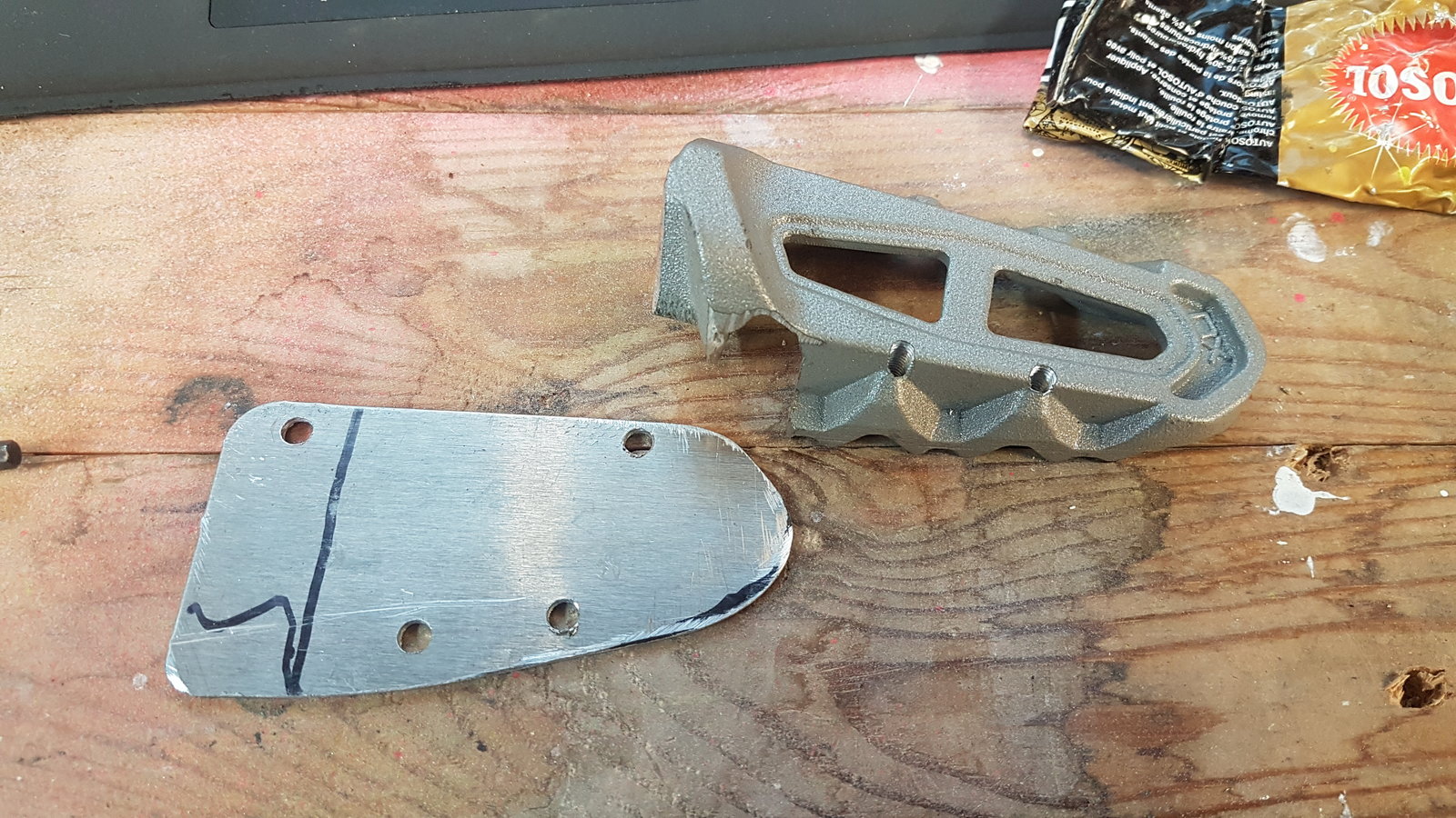

  16. 20180411_185141.jpg 20180411_185141.jpg 20180411_185016.jpg 20180411_184542.jpg a bit of tinkering last night works quite well. Purchased a RHS rear foot peg for £18 and modified it with a dremel feels better just sat on the bike haven' managed a test ride yet

  17. F’ing awesome!! I have a spare hanger already, worth a crack. Let us know how test ride goes, especially if there is risk of grounding (the std one can ground out under track and certain camber conditions)

    I made this one in a bit of a hurry and it could have been machined out better with a dremel bit more suited to grinding out cast alloy.
    The base plate is 1mm stainless and I have now fitted stainless m4 Allen boots to replace the original ones I used to fit the unit.
    I have thread locked the bolts in and a check after the run found none loose so succss.
    The the rear foot rest is just under £18 Brand new from ducati so probably £20 ish for bits (I had the bolts and stainless plate in my collection of useful bits and bobs)
    Maybe 3/4 to an hour to fabricate
