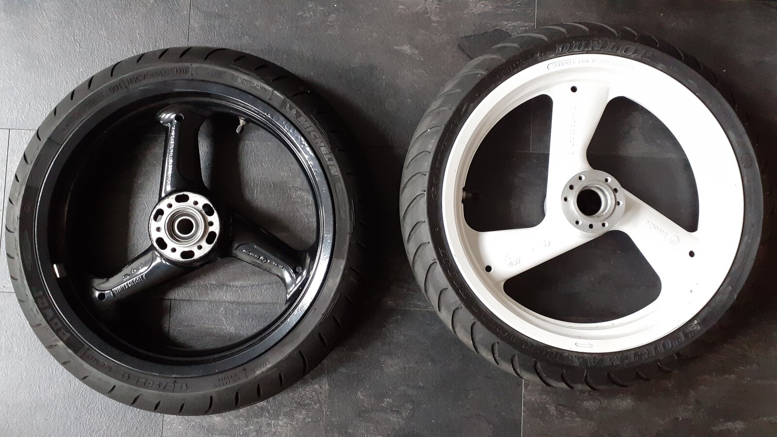

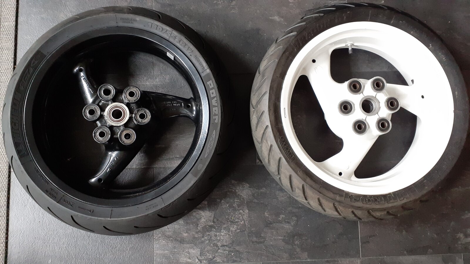

    I have a set of the later three-spoke Brembo wheels in black from a Sport Classic
    Can these be made to fit my 900ss?
    I think the rim sizes are compatible, the rear being a 5.5 but the existing bearings are for a wider axle, so will obviously need replacing. I'm just not sure about the rest in terms of axles and front speedo attachment etc. Just not sure whether they might sit slightly offset etc?
    Anyone else tried to fit such wheels on an SS ?
    Pics next to original SS white wheels

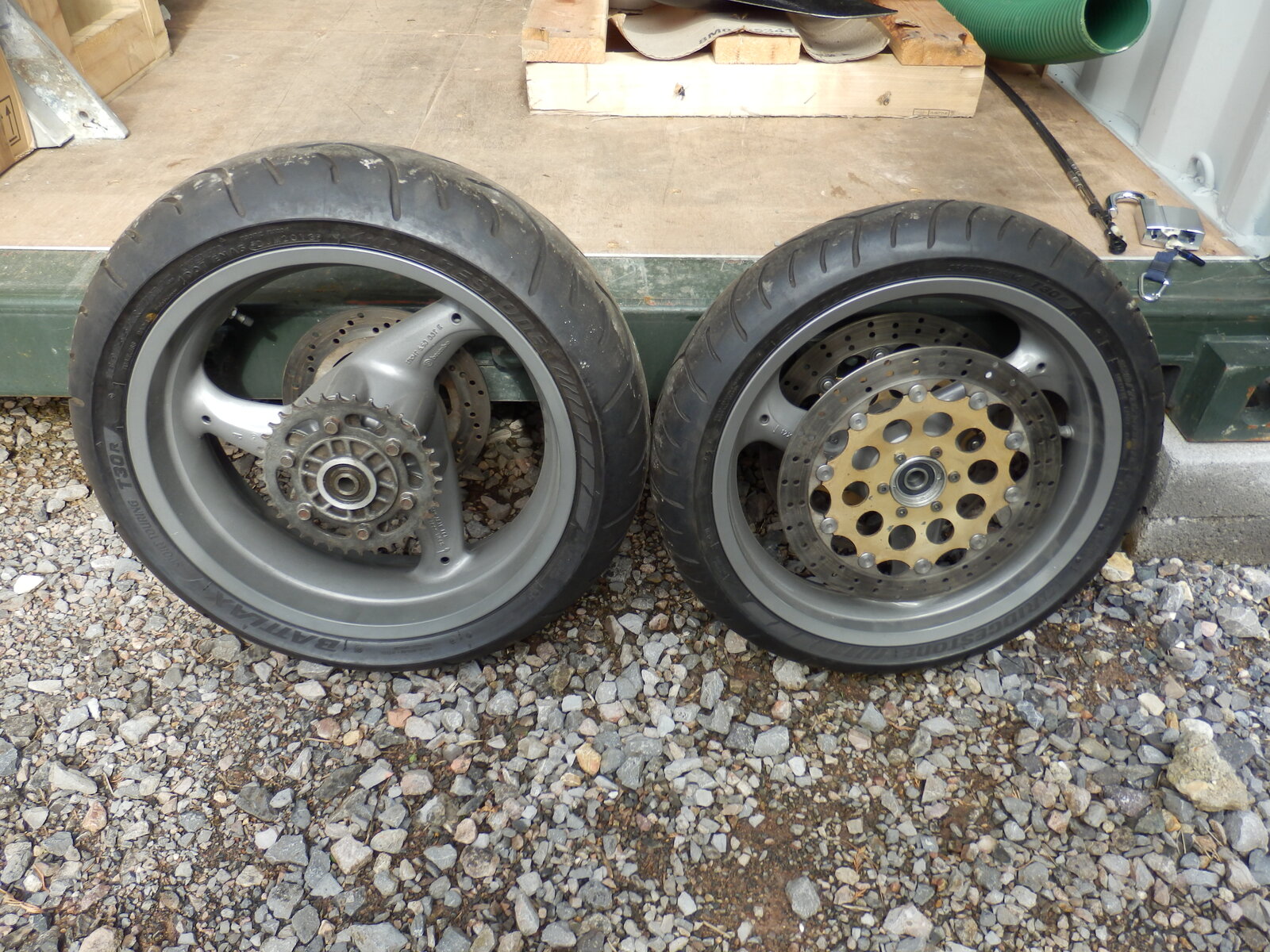

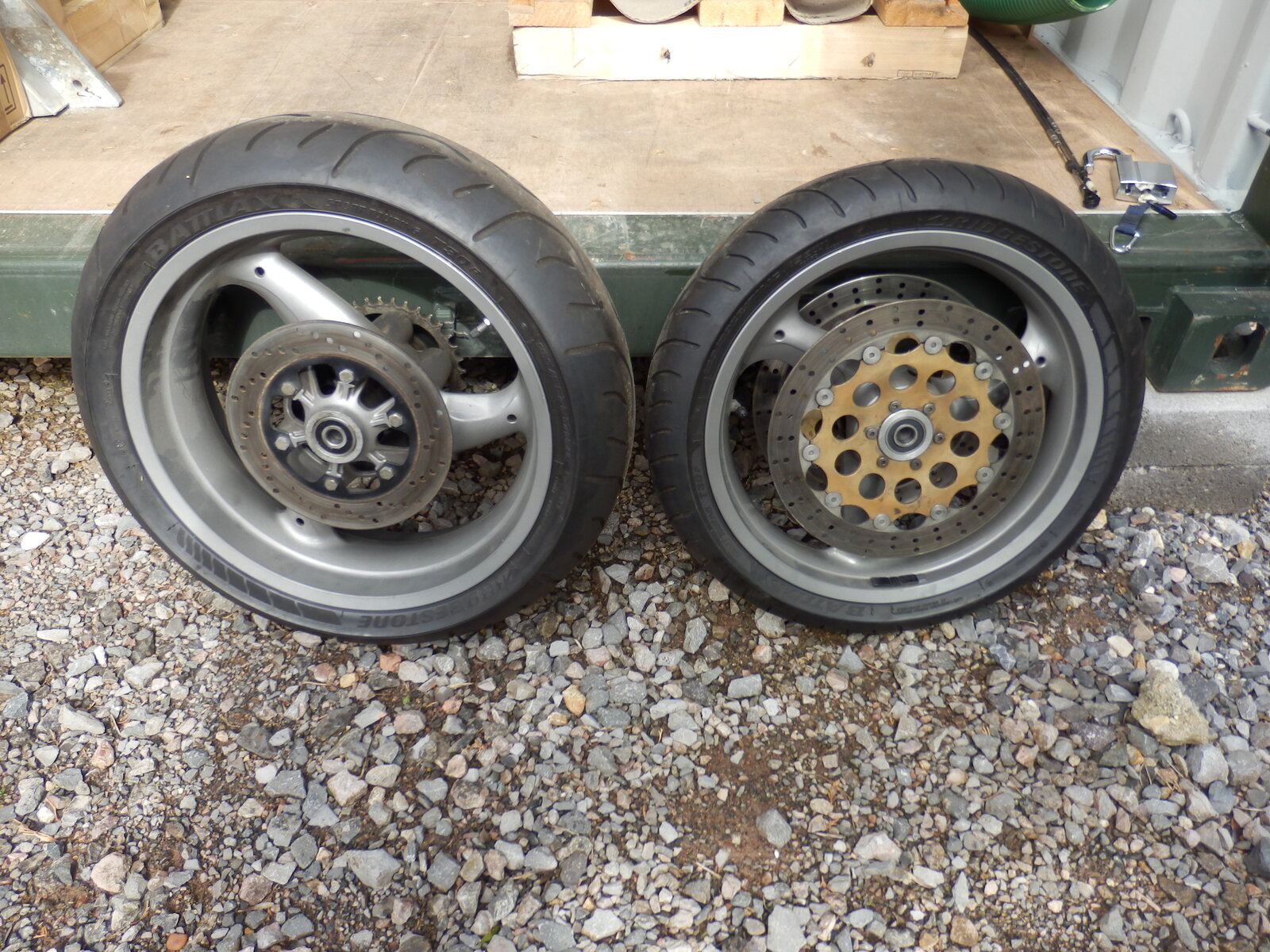

  2. I fitted a set of ST2 wheels into a 900SS Carbie.
    (Because they were a lot lighter)
    I assume they are similar if not the same as the SC wheels.
    From Memory:
    Back wheel
    Changed the bearings for ones with the correct combination of ID/OD to use the original Spindle.
    But had to reduce the width of the sprocket carrier assembly/spacers etc in my Lathe to reduce the overall width enough to fit in the SS swingarm.
    I can't remember if I started with the ST or SS Sprocket carrier.
    I think, but can't be sure I also had to skim a bit off the rear Brake Caliper bracket as well.
    Front wheel
    But also the only bearings available in the correct ID/OD were wider than the originals so I made the pockets deeper in the hubs using my Milling machine and also had to fabricate a shorter bearing spacer tube for inside the hub.
    I also had to skim the speedo drive down a lot thinner so the wheel was centred, and in truth it was almost falling apart after.
    I think I used the SS speedo drive lug thing as well.
    As you can see the main issue was overall width of both ends.
    I wanted to find a way to do it, and could obviously do the machining myself, but I'm not sure it was worth it.
  3. AFAIK, there were 2 rear axle sizes: 17mm and 25mm and the wheels are essentially the same fit, you just need to change the bearings and the central spacer to suit the axle size.
  4. Have just realised I do still have the pair of wheels I modified, including the sprocket carrier, but not the speedo drive.
    So if you need more images or measurements let me know.
    You can even see in the second image where I skimmed a bit off the outside of the carrier, but most of the work was on the other side of the carrier and the internal spacer.
